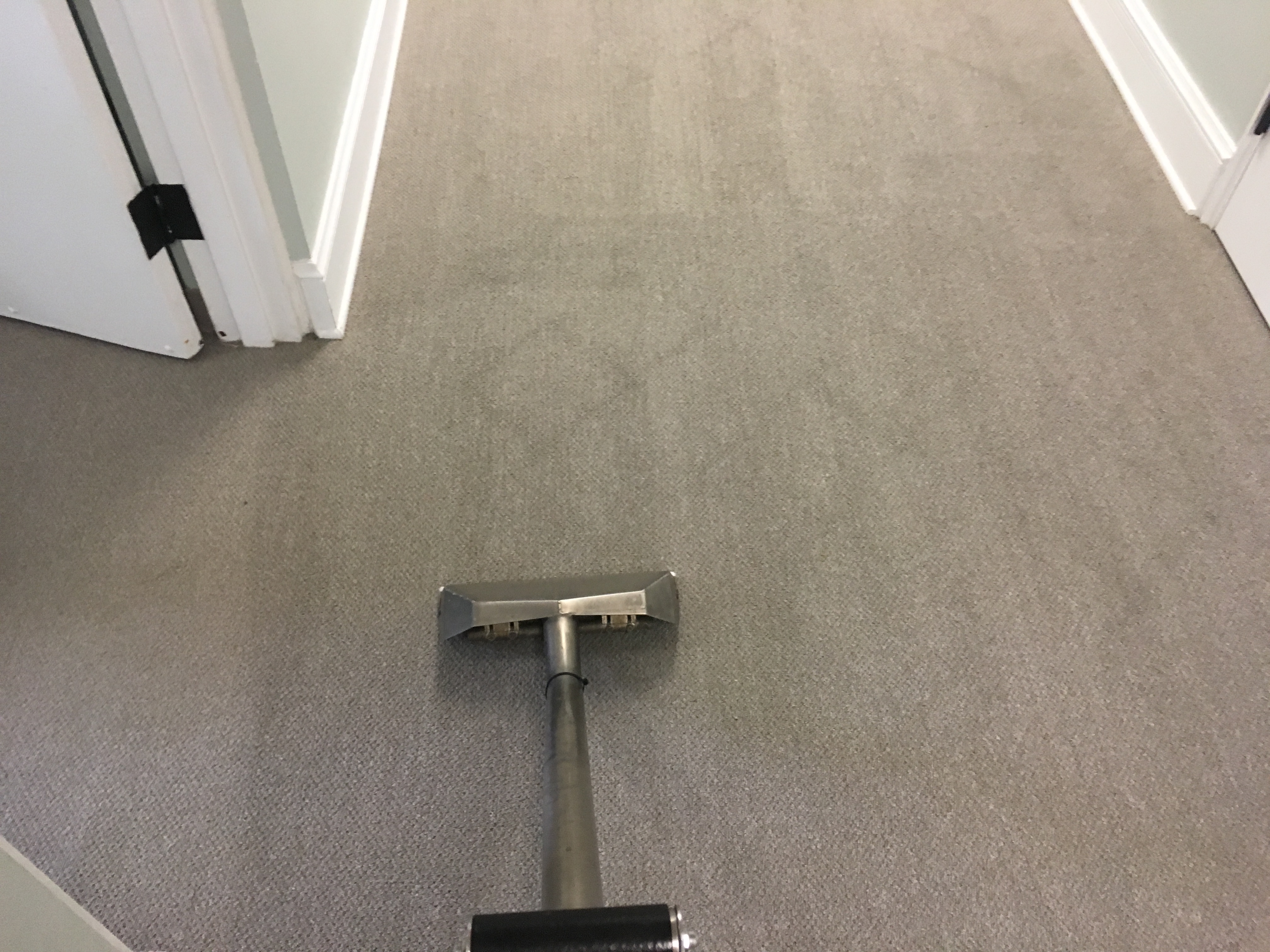

Going to look at a job Monday possibly clean it too.
A construction company layed the clear self stick protector in some hallways. They left it for about a week. The instructions said good for 4 weeks. This was last year and when they removed the cellophane the carpet was discolored.
I haven't seen it yet and don't have all the details like type of carpet but I'm assuming nylon. Not sure why they don't put a claim against the product which I may suggest but my impression is they want it cleaned monday regardless.
I know its been discussed before but thought is ask if anyone has suggestions.
I'm going with a buffer and several types of pads and bonnets. The 15 inch crb. Releasit.
I have code red prozyme plus and ultra Pac extreme and p rochem all fiber rinse for extraction ready to go. I have other products like banes olefin Prespray tls 2000 pro choice extreme clean and other stuff.

It was just some glue residue and improper cleaning by the staff. I'm back to do another building waiting to get in. Its on Notre Dame campus and security is tight here.
Haven't seen my results yet on the first building yet.
steve_64
Aug 11, 2012
13,372
Had some wick back issue on first building. Was told the carpet was cleaned 5 times alread. I had used code red in the 175 and a grey pad of ricks then wander it with p rochem all fiber rinse.
Today we wanded with just the rinse because I forgot a vacuum then used bonnets and the 175 with Releasit. Hit the first building again with the buffer and Releasit.
