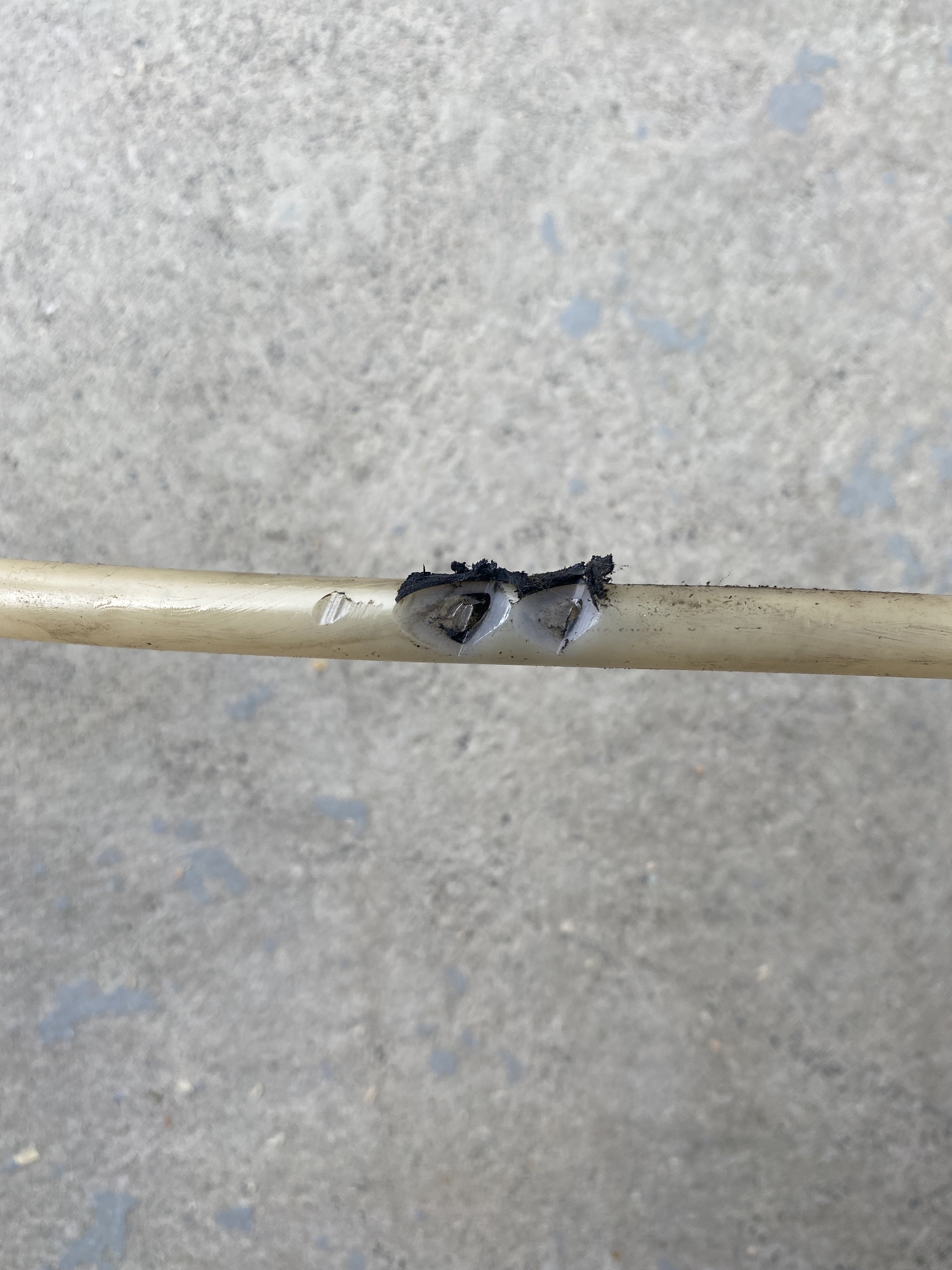

Just updating the post in case anyone else runs into this issue. Justin was spot on, I removed both the lines from the bimba valve and one of them had worn a hole through it. I replaced the both and now it's making heat properly!
Good to know, where was the hole?
Bosco83
Oct 26, 2021
5
Brian Boczkiewicz
Looks like the belt rubbed a hole in it.
