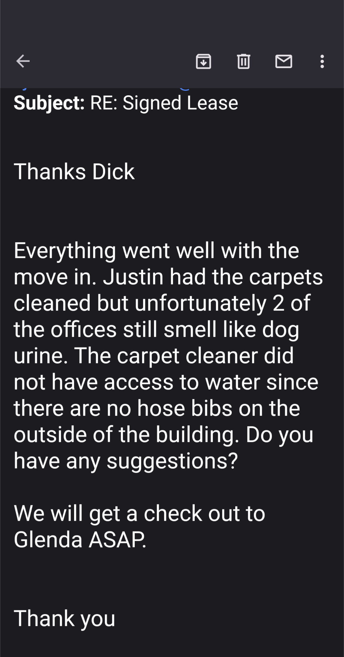

Two banana sized sos showed up under UV inspection.
I couldn't smell anything.
Padded as normal.
What would you do on the return visit?

I'm unclear on a few things:
"Two of the offices still smell like dog urine"....Urine in an office carpet? If this isn't a veternarian, WTH is a dog doing in there? (Besides urinating)
Glue down or stretched over pad?
I know how you feel about urine decontamination, so I guess it is also a question of what you want to do versus what you can do.

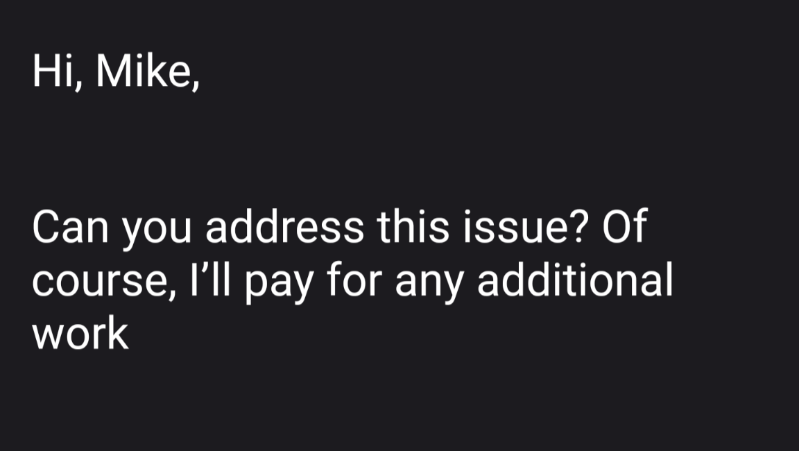

I am only willing to spray some Cide on anything that glows, and walk away.

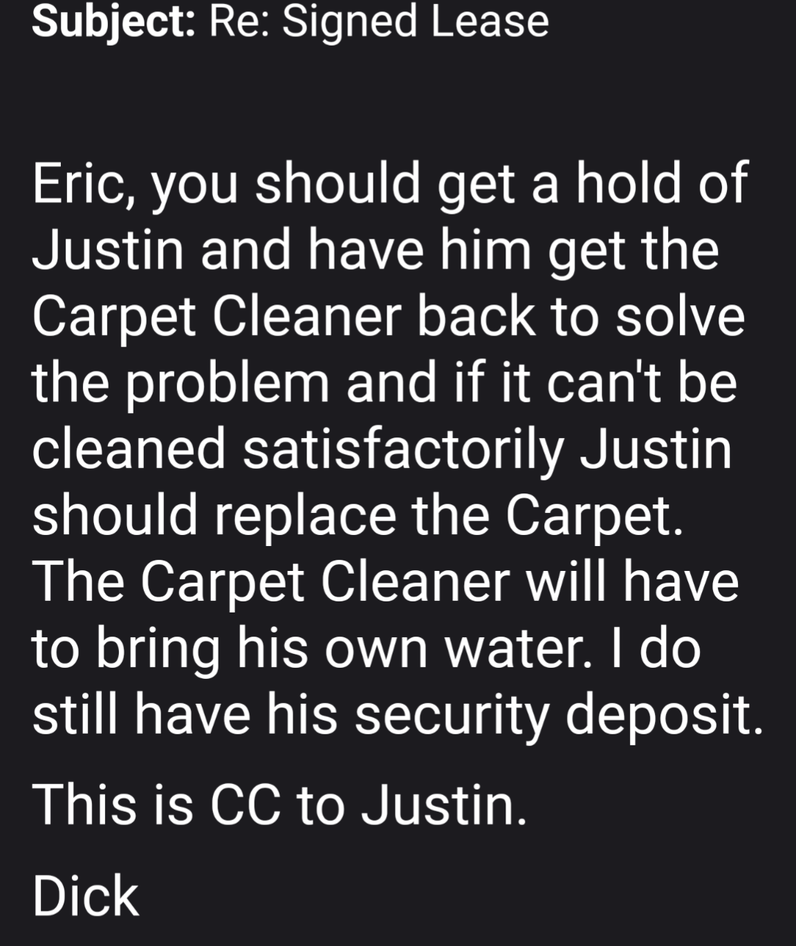

That much urine (banana sized) on a glue down carpet is going to need a sufficient amount of product applied, pushed down into the backing with your wand with no vacuum hose attached, then extraction after it has had time to work (however the product of your choice works).
If you just want to do what you've already done, and they seem open to replacing it, you have your answer.

Wait....
25 year old glue down carpet in a lawyer's office? Those cheap hijos de putas should have replaced it a long time ago.
That carpet is barely worth cleaning, let alone deodorizing.
They have a perfect excuse to take the deposit money and put in new carpet.
