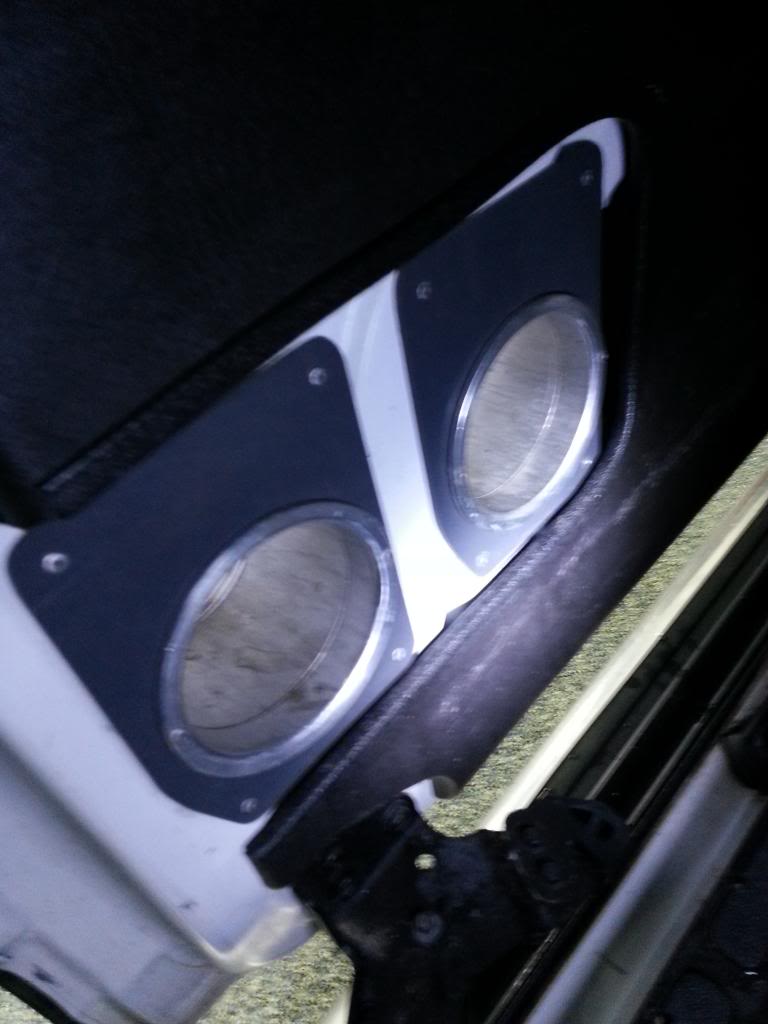

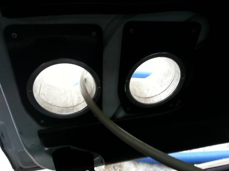

Going off the picture on the 1200 it has the same vacuum port and about in the same location...turn it and re-plumb it out one of the back barn doors.......

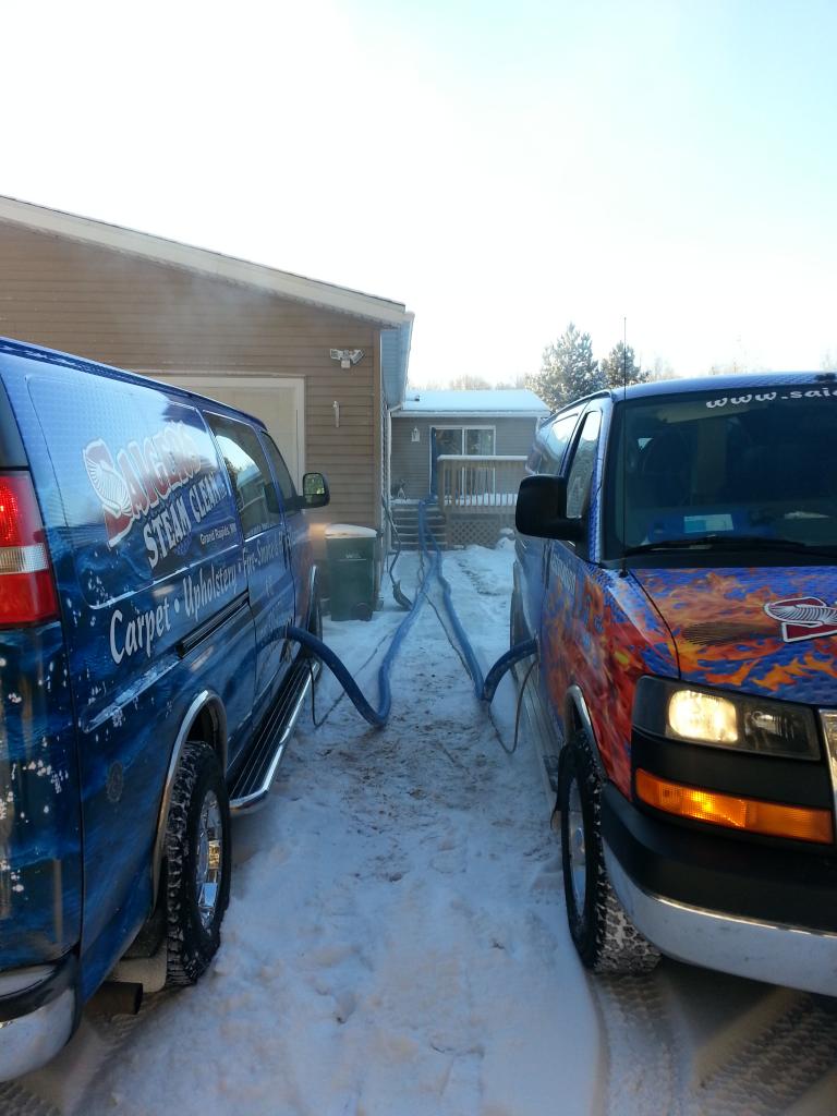

I thought my response was targeting the heart of your question. If you put the pork hole immediately opposite to the hose reel, you can't open the door. If you put it at the other end of the door, the slack created allows you to open the door and not create stress on it.

  • Mark, that is very neat and thanks for the pictures. Is opening or closing while hose in create any issue? What's the distance from door to where hookup is?

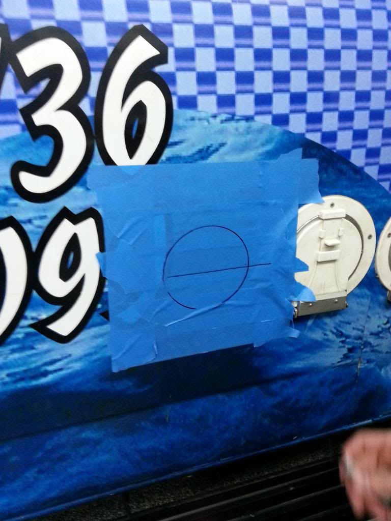

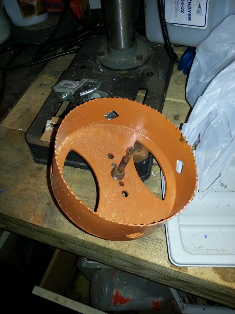

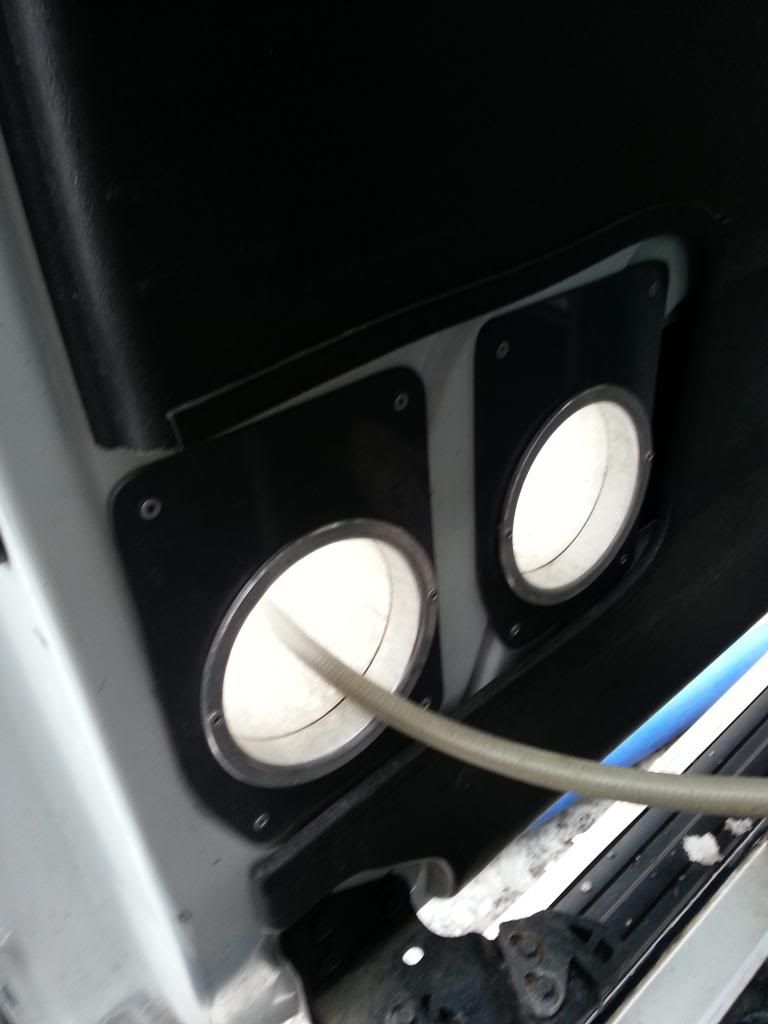

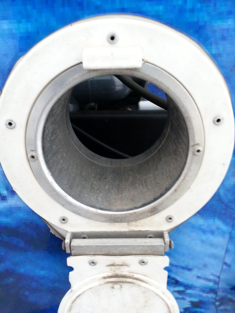

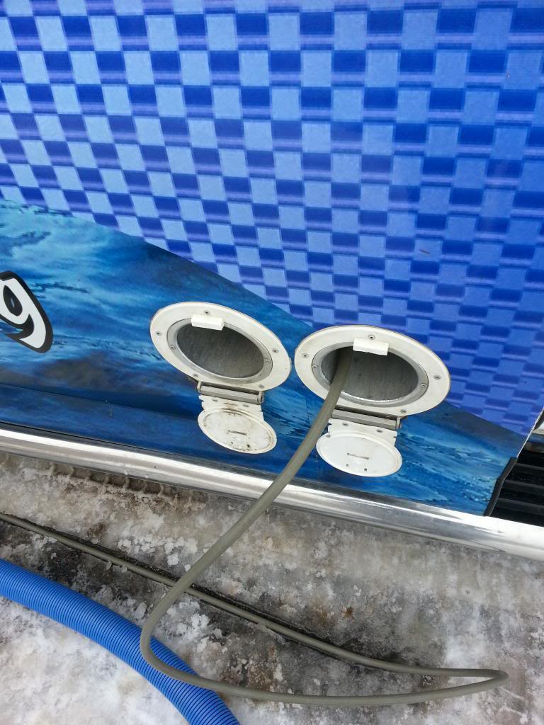

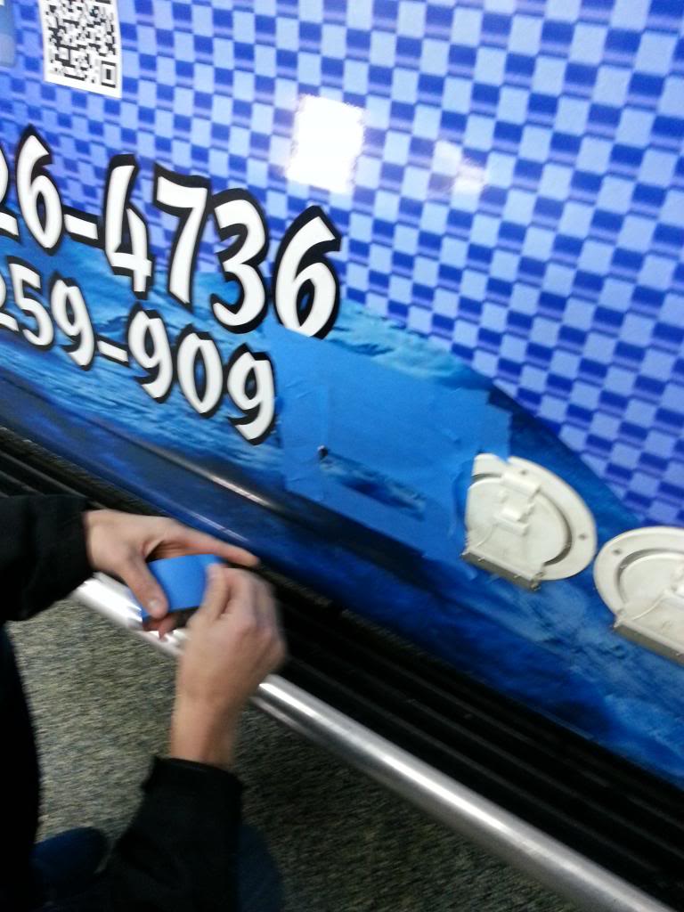

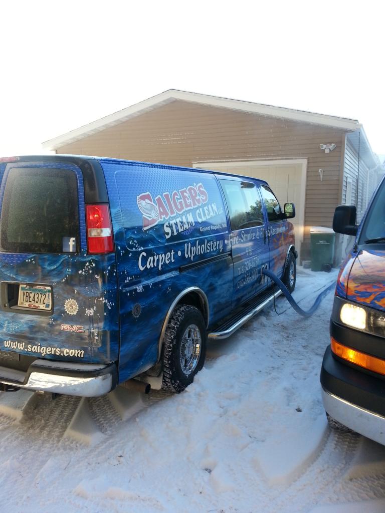

Hopefully you just got a chance to see the videos posted (while you were both posting your threads)
The videos will maybe help with all the ideas mentioned.

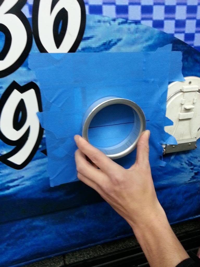

Since you don't have to worry about freezing why not just mount a manifold outside the vehicle beneath the door. Run the plumbing down through the floor and to the manifold.
That way you don't even have to screw with cutting on the door.
