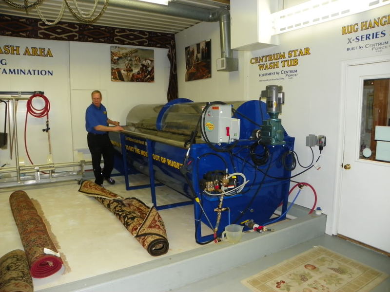

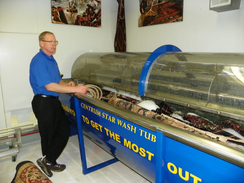

The following are pictures of wash tubs. The Big One is at Rug Renovators in NYC. One of the pictures shows 3 wash tubs of our style in one plant. (I don't recommend how the one operator was loading the rug in from behind the paddle wheel)
View attachment 531View attachment 532View attachment 533
I will post up more pictures and videos if desire Mikey. (I have to change some of the file sizes and formats) I have some from Woven Legends in Turkey and some 40-50 plants in North America that use the Centrum Force system too.

These pictures I took when visiting Turkey. These big wash tubs are located in the Woven Legends facility. They wash multiple rugs at a time.
Wash Tubs have been in use for many years in many places. Centrum Force produces their version in the USA for rug washers as another tool to get the best job done. The previous picture posted that I made showed 3 of our version in one plant. That specific in-plant operation has two Moore machines staged in sequence to provide the rinsing for every rug that comes out of their 3 wash tubs. They do on an average of 28K rugs a year this way.

Our 1200 gallon paddle wheel wash tub is a fabulous tool for totally wetting down, and washing rugs, in preparation to do whatever else that may be necessary to improve its cleanliness and appearance. The rug may often merit additional techniques to address stubborn, unwanted visually clinging deposits. Furthermore, it would be common to use techniques on a wash floor that may include power washing, rotary or counter-rotating cylinder brushes to agitate the chemistry that was already introduced in the rug from spending time washing in the tub.
Let me be clear, to get the best results, we advocate our products for washing. They have been designed and blended to accomplish much good for tub washing rugs. We use colloidal micelles, which breaks down long-chain hydrocarbon bonds in fats, oils, and grease (FOG) and holds them in suspension when mixed with water. (As an untended consequence, our client’s have found our chemistry to work exceptionally well for household laundering of clothes and linens.) The action of chemistry, combined with the water turbulence caused by the paddle wheel plays an important role for getting the soil to release off the textile and go into suspension in the water. Using our centrifuge, while rinsing/flushing the rug with clean water, creates a synergy with the wash tub that is hard to improve upon for achieving a clean rug.

I had some visitors to our little shop recently. I showed them first hand the value of the wash tub and how it reduces hours of pit washing. I washed multiple rugs at the same time (12 ct). After that, I took them out one by one and power washed what was needed to be done for each rug in my curbed wash floor/pit. Some rugs only needed some fringe work with a quick power wash, and others needed other techniques done to them. Then they all went off to the centrifuge for a spin. After that, then went up on our rug hanging poles for a final dry overnight.
One of the visitors admitted that it would have taken him all day to dust and pit wash what we did. Yet we did all this while pausing and talking, in 2 hours!
One of the visitors has been a serious wash floor/pit rug washer for years. It made sense to him what we were doing.
