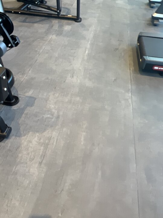

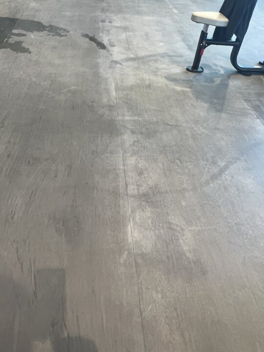

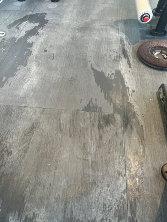

Guys I have a new floor install that was beat up a bit by construction crews and with red clay mud and typical construction debris.
We tried test areas with brush , spinner 700-1000 psi. Alkaline cleaner , neutral cleaner , citrus, and acid floor cleaners. The haze just comes back. Minor improvements over all but not much. We used a crb with aggressive brushes , swing 175 rpm with pads , brushes and rinse with auto scrubber Won’t budge . It appears to have a residual stuff on it in some areas more than others . If I use a rag with little neutral cleaner and rub really focused with my thumb it appears to come off. If I scrape it like small area with my finger nail almost scuffing up the rubber it comes off a bit. Any tips? The floor looks as we got it . We only tried a few test areas
IMG_D7C1808F-B993-4F70-9352-77DE08726D0A.jpeg IMG_4BD4F6A7-9069-4A0C-A900-6812CFE35BAA.jpeg IMG_7468.jpeg IMG_7467.jpeg
14,632
Is that haze from sheetrock dust?
If it is, an acid cleaner is usually best at getting it out. As for the rubber floor itself, I always had the best cleaning using a butyl based cleaner 8-9ph
10,178
Is it a Mondo gym floor that you play basketball on? Is it smooth. A product called Profi is made for those floors and will clean the residue off. An auto scrubber is the best method.
