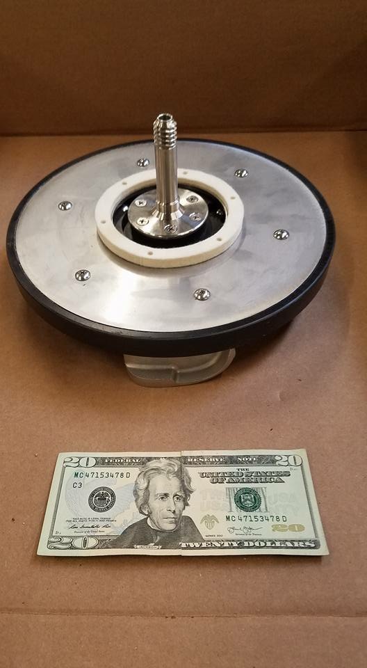

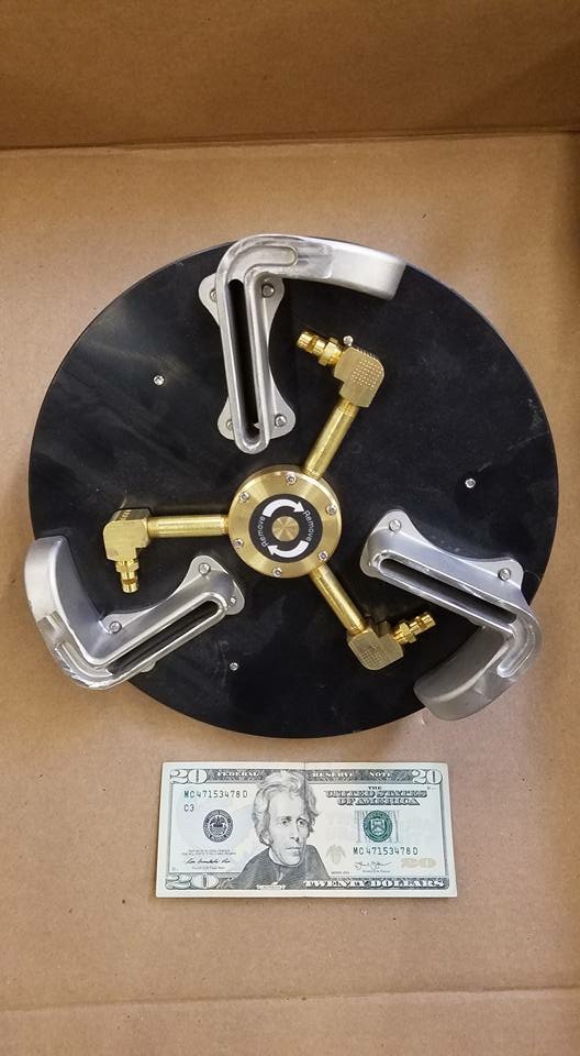

So today Rotovac has launched a new 10” cleaning head for 360 and 360i. It delivers better performance than standard heads on troublesome jobs. Also suits stair cleaning. $395 and available now.

I have 2 RVStairPros dedicated for stair cleaning. They use the 7" cleaning heads. I have extra cleaning heads choked down to 1 jet each, jet sizing .05/1.0/1.5/2.0/ &3.0 set up and interchangeable in seconds to meet most cleaning challenges.
I can contour right over the bull nosing to clean, then cuff them. Really soiled nosing, I break out the Kleenright hand piece to flush sideways, and do risers.
That cleaning head as pictured would not be capable of cleaning over the nosing as it does not have the ss 'puck' that fits to the distribution chamber.
Hopefully the production heads will come with the puck installed.
