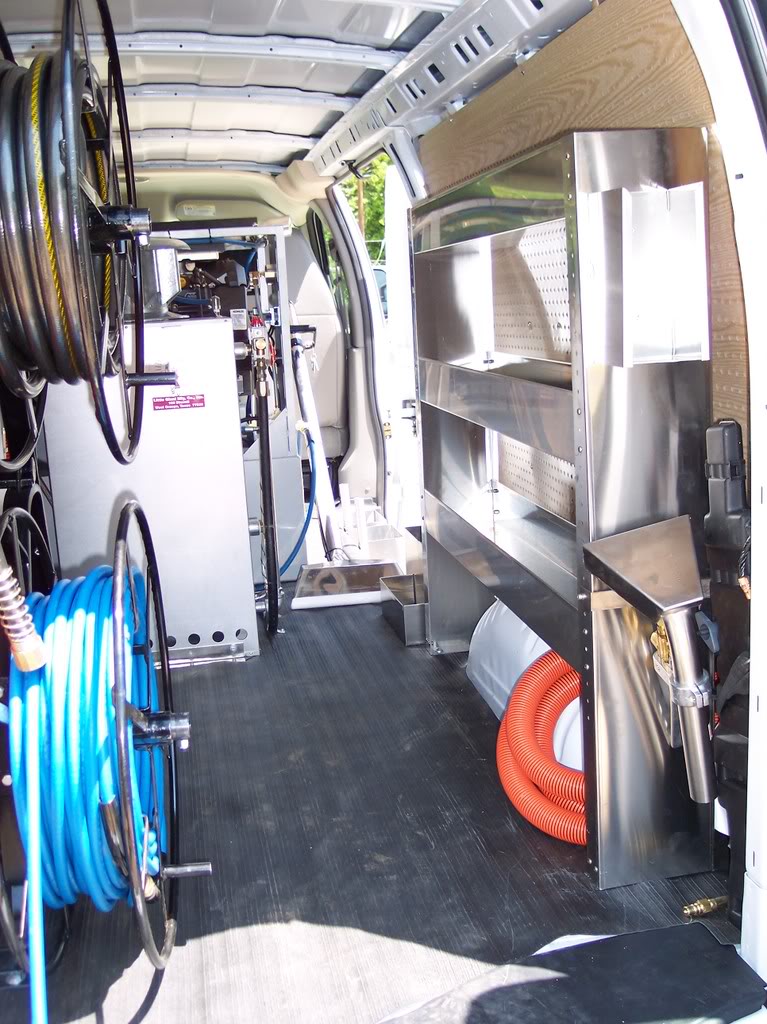

im diggin the sink!!!! thats pretty sweet. who did the waste tank? what capacity is it?
How heavy is that rig with a load of water on it?? It sure is amazing how fast you can fill up a box when you start building one of these rigs!!!!

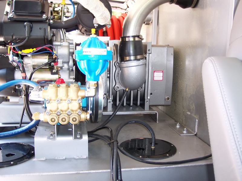

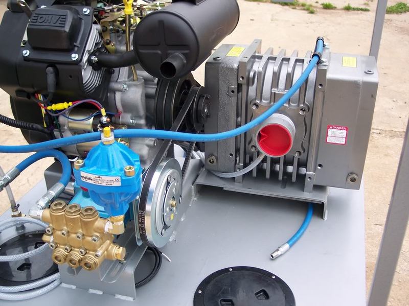

Thats a nice rig. Do you run 200 gallon water capacity all the time? Is that there canam with a 45 or 47 blower and 27hp kohler?

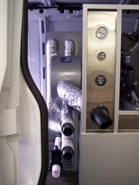

In that next to last pic, what are those two openings that are just above the waste tank drain?
I assume they are the two vac. ports, but dang ... they look like 1.5 inch openings?

I think they're 2" Marty. Look at the drain barb. That looks to be 1.5". Nice looking clean install.

How does that foil looking vacuum hose work out.....it looks really weird. What's it constructed of and why not use regular vacuum hose as opposed to using that foil looking hose?
Oh and what are the possibilites of creating a simple exhaust exchanger like the one that Kevin Brenny made. To knock out the cold in the water to save some LP.

Les is this a ext van?
My question is would there be enough room for a cimex, rx-20,turbo hybrid and some other tools
Bob that is a very nice setup you put together there. Have you weight it fully loaded?
My 95 e-350 15 footer weighs in just over 8000lbs with nothing in it, the GVWR is 11,000lbs so by that i shouldn't carry more then 3000lbs payload. I just might take it to a scale house and see what it weght is.

The CanAm runs great. Getting just over a gallon of propane used per hour, that a $3 cost/hr to run. I've got the heat set to about 220. It was hot on my hand through the vinyl wand grip the other night cleaning a restaurant. I was using my old 2" hose inthe restaurant and dog gone if it wasn't collapsing on me. Never happened before; been using that length for over 10 yrs. Had to get my length of superflex.
I've got it plumbed 3" throughout. If need be I can increase the tank to blower to 4" but I don't see a reason to do that as yet. The blower,a 4.7 has 3" ports, and there is more than enough airflow through 3" hose.

is that a raised floor to???
I bet that is one heavy bitch....the amount of weight you can add to those things is ridiculas..and without even trying...

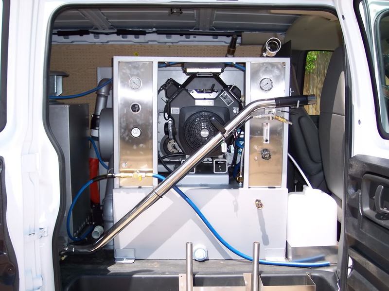

Good luck with yor new toy Ronnie, Looks like Bobbie did an excelent job on the layout and installation. Youse guys in Canadia do a fantasdilliyastic job, (My JEM is from Langly, BC) Is there 2 of those 12 volt fans for cooling and van security that I see? If so I had my dry room set up similar to that , 1 sucking in and the other blowing out for humid air exchanges when we dryed rugs and used ozone.
That ol CMS vac looks like it's still got the powder in it,
Do you have both hot and cold water at the sink?

She works as good as she looks.
Yep, the Cleartrak does have the dust still in it at the time of the photo. Had a lot more in it since then :wink:
The fans are set up so that I can close the doors and keep working, one sucking air in at the lower corner by the plant and the other blowing out at the opposite corner. I wanted that feature because I was used to doing that with my old truck. Its very nice when working downtown at night. I don't have to worry about some idiot wondering what would happen if he stuck his finger in the motor fan, or taking something, or whatever.
Only cold at the sink. I plumbed both lines with cold so I fill up the containers much faster. With the Lil'giant as the sourse of heat, I didn't want THAT much heat and pressure at the tap, plus, how many taps are built for 220F and 600psi?
