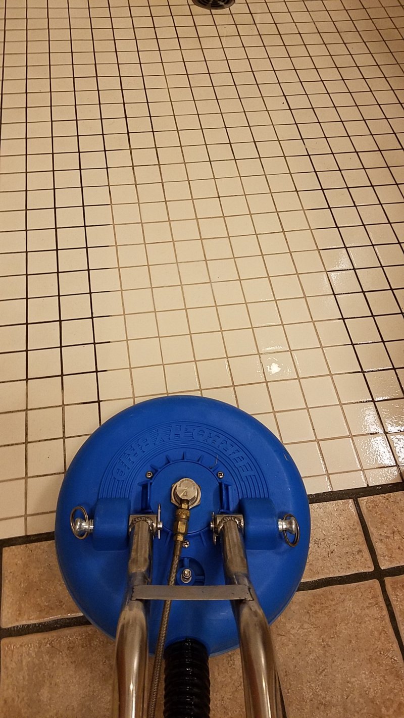

This is a carpet cleaning account that is replacing the carpet and resurfacing the parking lot. They want me to clean the tile.
This is the nicest place in town.
Bathrooms, entrance and lobby area. Low expectations so I know they will love it.
They hesitated in price but agreed with my $400 price no sealing mentioned.

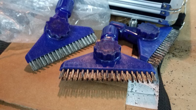

Scrapers and wire brushes will get a work out. Me too.

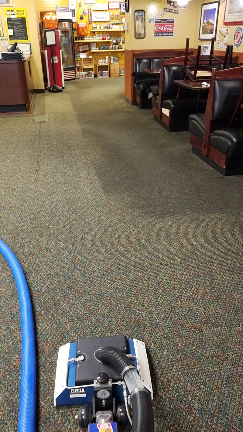

We have 2800 square feet of that exact tile and grout tonight in couple hours... Plus another 2800 square feet of carpet in bad shape... And then another 2800 of tile and grout in the front gas station convience store and bathrooms....
This is going to be a crazy long night!

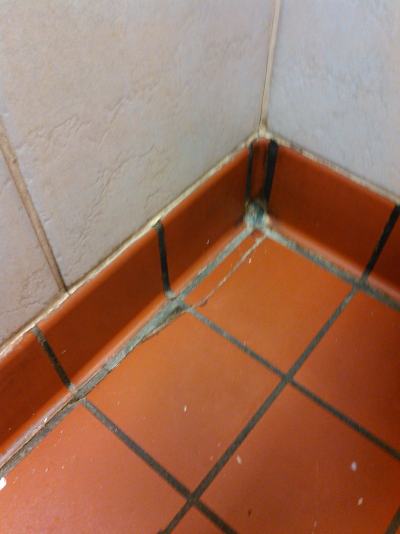

Bet there is a lot of damaged grout under that grease. This will be a great before and after for your web site!

Yes I will be taking more pics. And I pointed out some areas already and it's understood some damage may occur.
Bought a tile wand recently and other tile tools. Looking forward to this job.

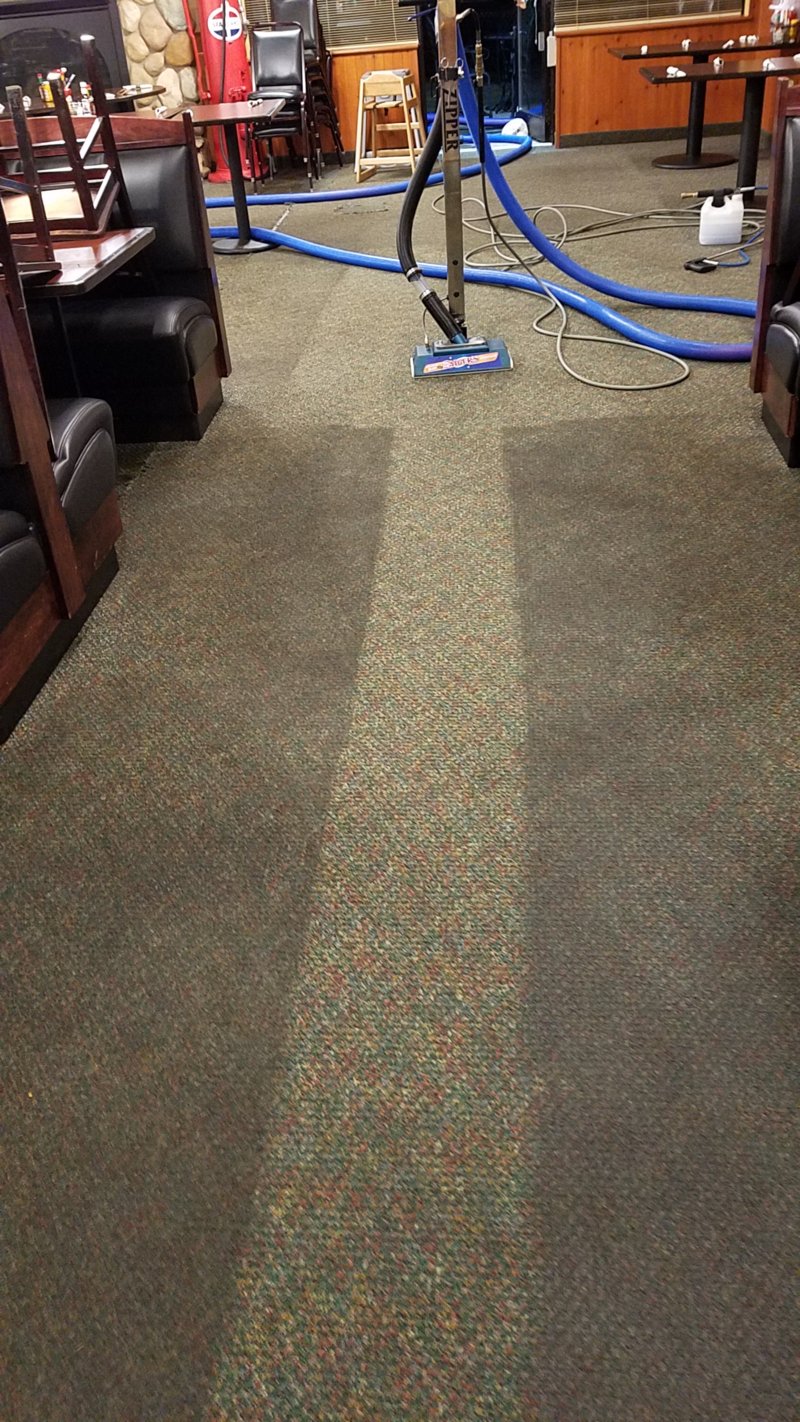

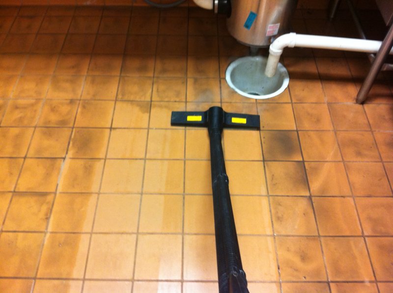

Mark do you leave the stripes or groom those out?
Went to do the job and they aren't ready. Heading back in a bit. It's only a couple minutes away.
yep, I was thinking a little streaky as well.
The pics were before any dry passes...actually mellowed out that look....
But also...this carpet if you look close is about done...
Has all kinds of ripples in it...
They are talking replacement this coming winter

I was talking about the lines the width of the zipper. Do you guys groom those out? I don't see you making back gammon boards with that thing

I looked at the tile today and it looked like crap to me. To much grout didn't clean up. Not all my fault though.
Couldn't get to it till late and they were rushing us. Genny did much of the scrubbing with the crb but we didn't work on the grout lines specifically. I don't think we used enough product neither.
Just a tough job to do without all the issues like them getting in the way constantly trying to move things around.g getting ready to open in the morning after a major remodel.
No guilt on this one just wish it turned out better.

We have a school kitchen and dining room we do every summer with that same tile in it. The tool in the picture above well adjust to a straight stream that is very effective on grout such as that.
