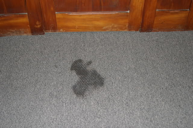

We often get called in by a rental manager that has a burn in a property.
Today's was a severe scorch mark on the bedroom carpet. Low loop 'berber' carpet. There was a loose runner in the kitchen, albeit dirty and worn. This repair demonstrates taht you can't always win every time on matching an invisible repair, but in these situations, they don't care. If I can save them $1500+ then they will use me all the time. The student gladly gives away a part (or all) of his/her bond to get off scot free.
Initial problem.

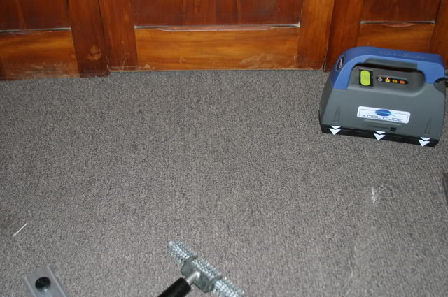

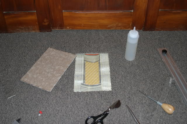

Area cut out.
Donor cut and sealed with tape in place.

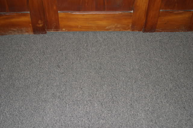

Done but cleaning up the joins a bit better and trimming any tufts still sitting up.
Completed job.
If you look closely, you should still see it. I lifted the pile while the carpet was warm, soft and pliable after setting the tape and so the wear difference is minimised but it's still dirty, but the carpets have already been cleaned and they didn't want me to re clean the section.

I wouldn't, other may. I think it's too small for that from on top.
The carpet continues into the wardrobe so lifting it all to get to the back of the carpet means twice as much work for the same? $$.
Maybe Harry or Marc may like to say on that one. The size was 6x10" approx from memory.
The scorching wasn't too deep so it may have been pssible to do a graft, but I felt my best time efficient manner was a complete insert.

Hey John, further to Charles' question, if a patch was of a size large enough to get a normal seaming iron in (not a cool glide), how does one go about gluing the last side? Do you just leave a bit unglued on the two adjacent sides to allow easier exit of the iron without getting glue everywhere?

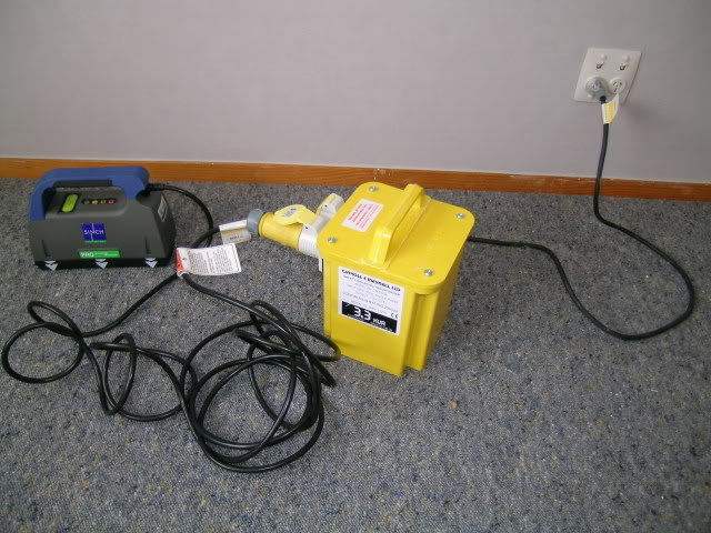

Shorty, my first unit which happened to be one of the first in the region, came with this baby!!
And no, you couldn't ask Delia to carry it for you :oops:
This was bought about 12-18 months ago. I can't really remember sorry. The Transformer here, is a UK one and has the UK heavy sockets with two outlets. 3.3kva (?) is what's on the side.
The new unit I bought a week or two back, came with a much smaller transformer. about 6"x6"x4" and easily carried by anyone. SMall enough to fit inside a toolbox with the Kool Glide and a roll of tape and a few other tools. But it can only power the one unit.

Charles,
While some would work on a repair like that with a conventional seam iron, all you would have to do it try it once and try the Kool Glide once and you would see there is no practical reason to use a conventional iron. This is just too tight to have the ability to set you donor piece and then have to move it around to put the iron under it. I have personally watched many try to do so and it always comes out a mess; yet when they try the Kool Glide, the same person can make a wonderful repair.
You can certainly do this with a glue gun and do a great job but to have the ability to seal edges and place the donor piece and set a portion of it and then look or adjust is just priceless to be able to do.

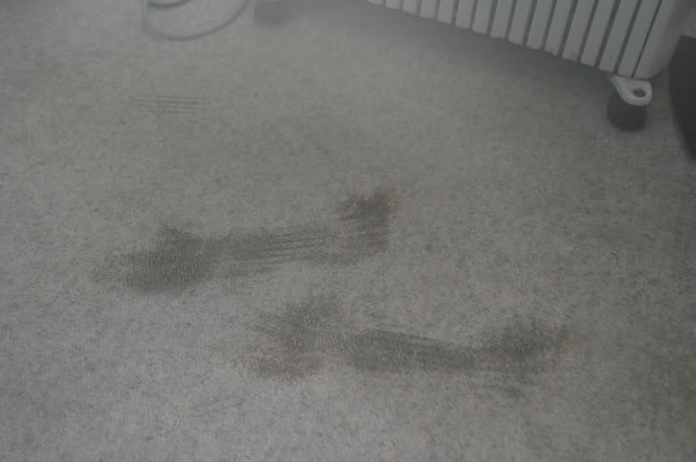

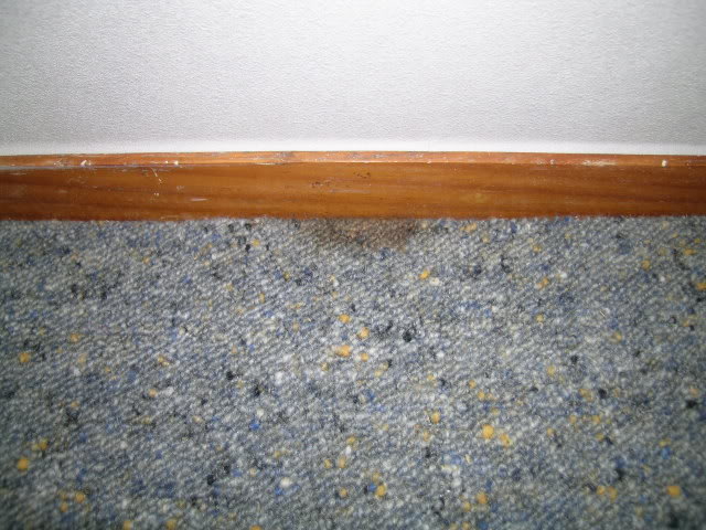

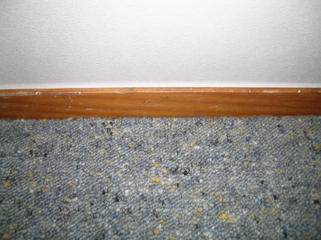

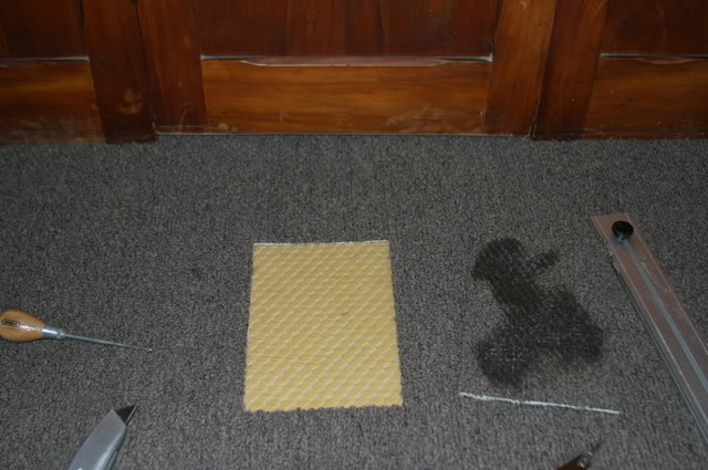

Here's another one I did for a rental last year.
An orange was left to rot under a bed. They shifted out and the stain wouldn't budge.
Client thought her replacement cover policy would have given her brand new carpet. It was only 1-2 years old anyway, but she was wanting to sell her rental and wanted it as new as possible.
The adjuster called me and and up till I did the work, she thought she was getting new carpet until she couldn't find the spot 8)

Charles, From seeing John M's work I do believe the Kool Glide is the way to go even for the lesser experienced repair tec. That being said,
The glue lees tape has no adhesive on it..
Using a glue gun with a tube extension helps, But, I have done with and with out. The glue-less tape looks like seaming tape with no glue on the scrim. Custom rug makers use it. I haven bought any for years (still have a roll left from a case) I used to buy rolls of it when it was called pin tape and had metal clips with small pins to hold the tape in place. I haven't see it for years, Maybe John, Steve or harry will chime in if it is still available or not.
You place your tape the same way John has his, I most always glue the main piece first because I can lift and maneuver the glue gun fairly easy but do not run the glue all the way to the edge on all 4 sides.
when inserting the donor piece I will seal the seam one side at a time just after laying down my tracks of hot melt glue. I normally work clockwise and glue and seal in order side 1, 2 3 and then 4 using a flat roller an letting the glue cool a minute or so between sides.
The secret to this and any repair is the fit. Hope this helped explain.
