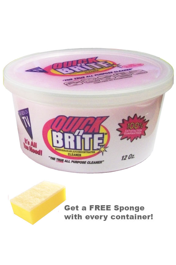

QuickNBrite residue.

Its pretty much coconut oil. Cleaners used to shampoo carpet with that stuff before they had synthetic detergents, and a lot of guys afterward.
Talk about resoiling.....
You have to be older than dirt to remember cleaning with that stuff.

I did an older nylon with it yesterday that I could see it foaming up in the wand window and I flush flushing flush w/ six flow 600 PSI but there's enough of a residue that caused some wicking this morning ..I told her to hit it with peroxide and let me know if that didn't work

Treat it like a bottle of spilled hair shampoo. You'll need to use a subsurface extraction tool and lots of water.
Its going to resoil until you do.

You might have some success treating it with Prochems citrus pro and water in a hydro force. About 16 ounces to a hydro-force with water. Rinse with a non detergent acid rinse such as browning treatment mixed 50/50 with water in your stock jug. The d'limonene cuts through the foamy residue and acts as a defoamer in your vac hose and tank. The browning treatment mixed will cure most wicking that has already happened.

You're cutting an old-fashioned soap. What cuts soap?
The stuff was invented by a local high school teacher. It didn't sell well because it was a gooey white liquid paste/glob that looked bad. The guy that bought it from the inventor made it into the pink paste they sell today.
