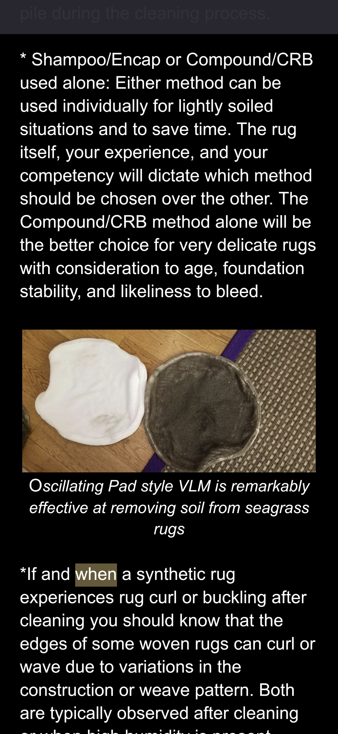

I've OPed sisal a few times over the years. Releasit DS and cotton pad. No prob.
That's what I used last time. I'm sure Tops juice would work well.

I HWE a sisal rug at the Mrs Doubtfire house. it had alot of pet stains. I inform her that I could remove some of the yuck, but the stains might only lighten a bit. The rug buckled a little but went back down with time.
I'm just thinking the TOPS might be better and less risky.
