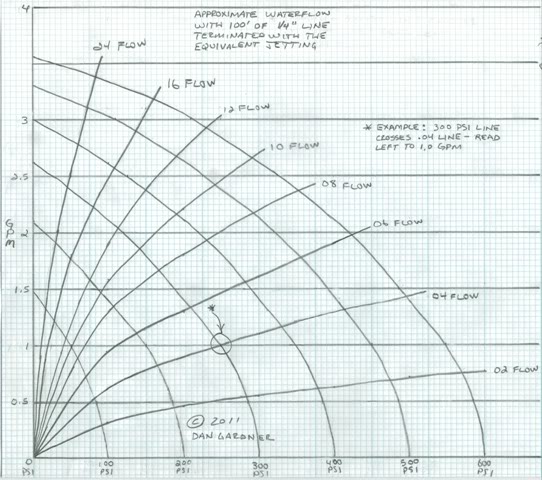

The pressure, provided there isn't a reducer, might appear fine. It's the flow/gpm that matter. Flow restrictors of 1.5gpm are common (?) and could potentially be outran by the TM in operation depending on tool flow rate/pressure.
