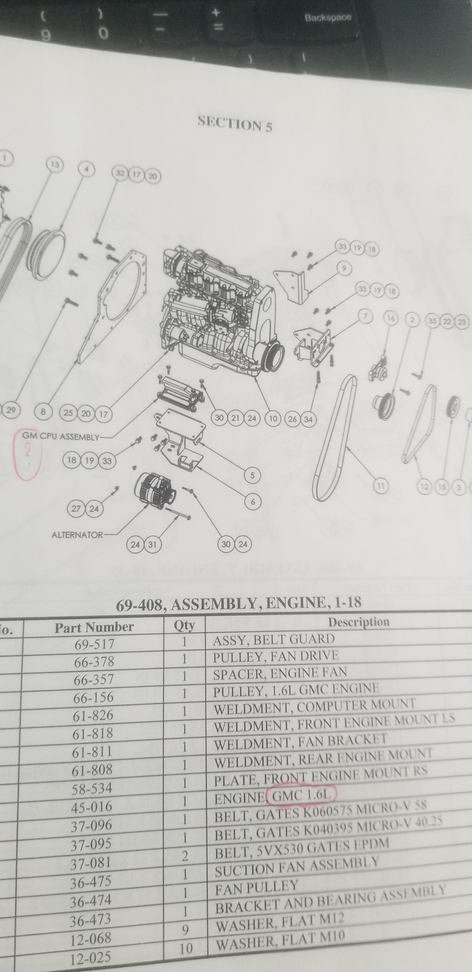

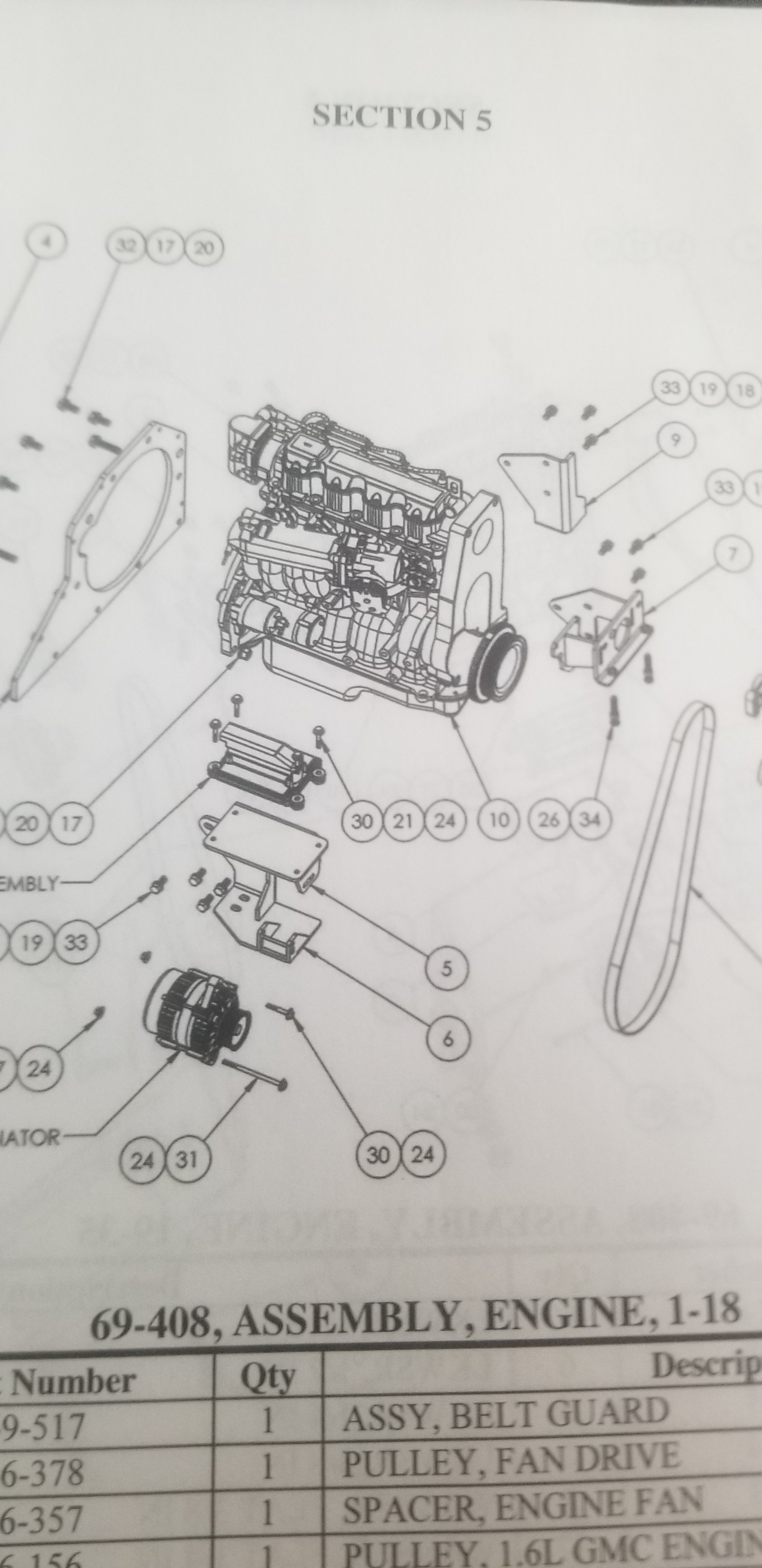

Thank you Justin.
Evidently near the end of the Ford run the GMC engine was in consideration. At least to the point of designing mounts etc. so that drawings and that manual page were printed.
Blueline used the GMC, sideways, in one design early in Sapphire's era.
So, there are no such engines floating around actually installed in an 870?

I am sure all power plants were looked at. And you are correct. Blueline did use the GM in the ThermalWave 2 Vortec.
There were not any GM's installed in 870's. They were in the TMT 888 as previously mentioned.

So, although the 870 we have was invoiced as a tmt888, it has no such markings, and came with the paperwork just referenced. Thus I'm certain that if there is a machine out there with the GM engine, Sapphire built it for them.
