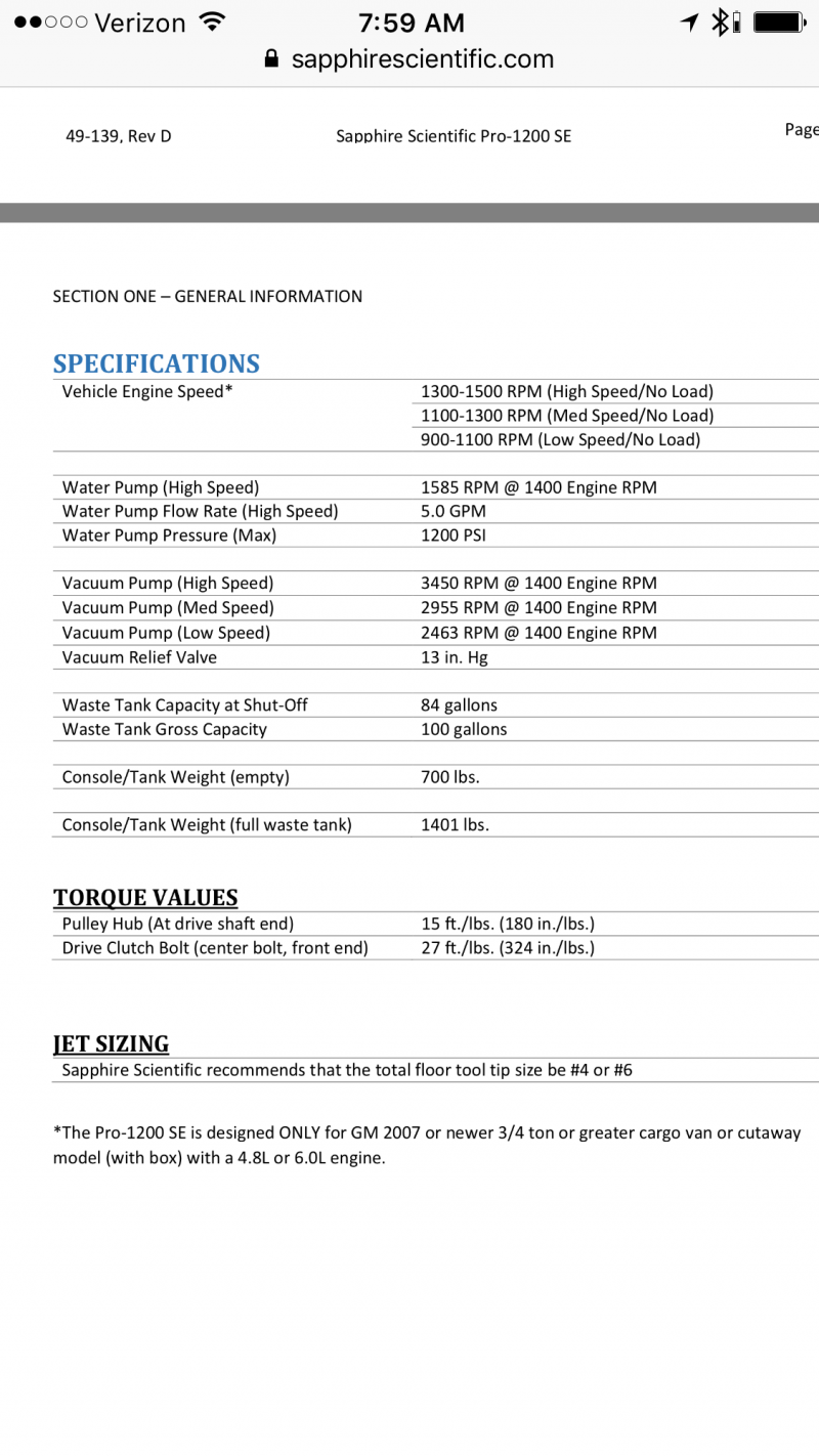

Every where you look online they spin the blower at 3450 rpm on high.
I texted Rick A he said 3200.
My dealer said Rick told him the 570
Is better for longer hose runs.
I was confused because they spin the 570 at 3000.
It's the same blower.
I'm wondering if they slowed down the pro1200 after seeing guys like Scott S have coupler problems?
I really like the idea of more vacuum
On this machine but if they're slowing it down I want to know.

The engine speed is 1400 rpm constant? How does blower rpm vary?
I think that's a misprint because above that it talks about speed without load in different variations.
Also the 3200 rpm is probably with a load on the blower! More sense that way.

1000 hours on my 1200 SE and nothing but good to say about it. It's such a neat machine.
RPM discrepancies are probably due to them switching from a 6" clutch right at the beginning to a 7" clutch. After the switch you're supposed to INCREASE the van 100 RPM, but the blower speed is actually still slightly decreased due to the change in pulley size.
I think some of the published specs are still based off the original 6" clutch/1400 RPM van setting.
