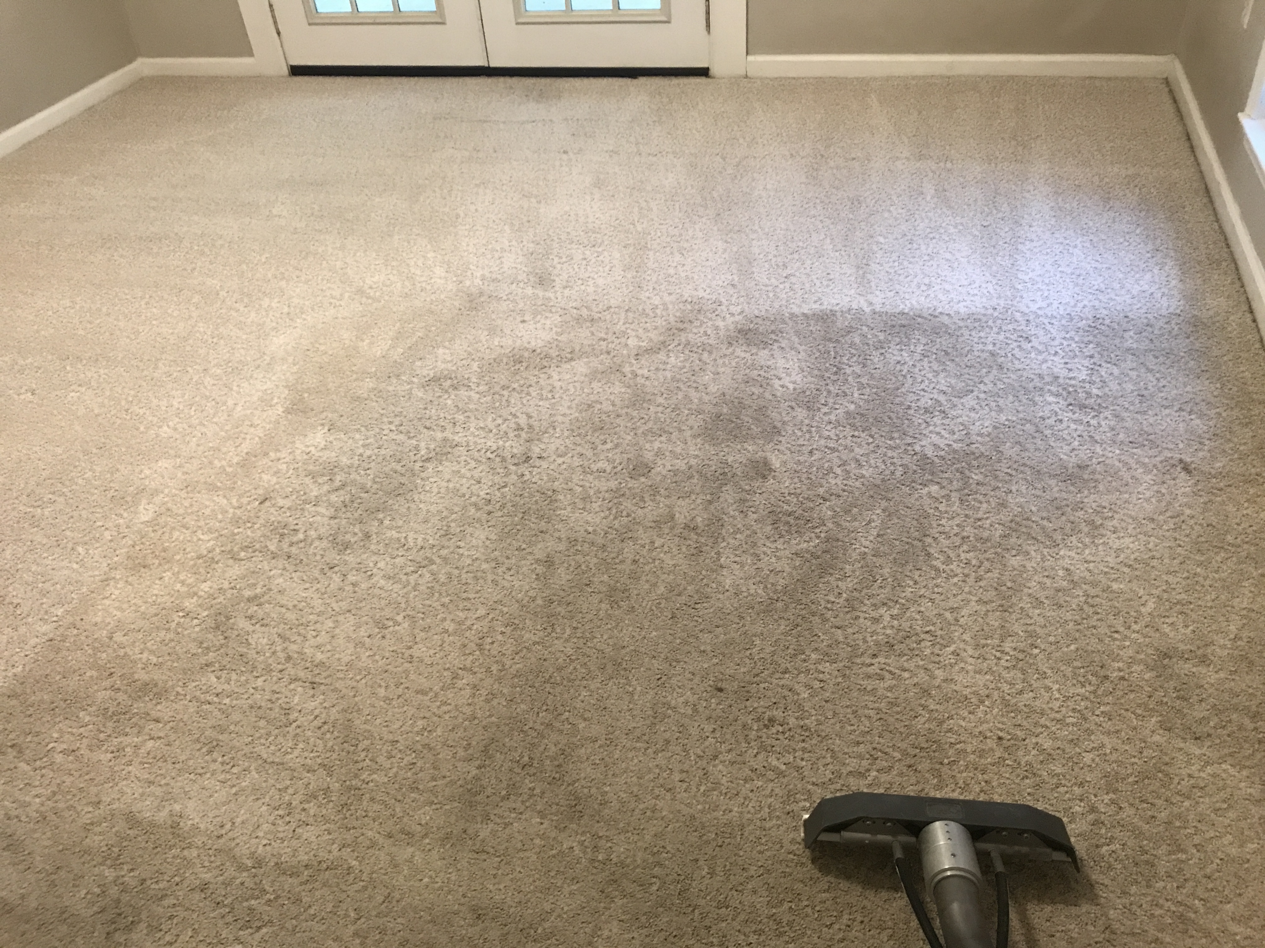

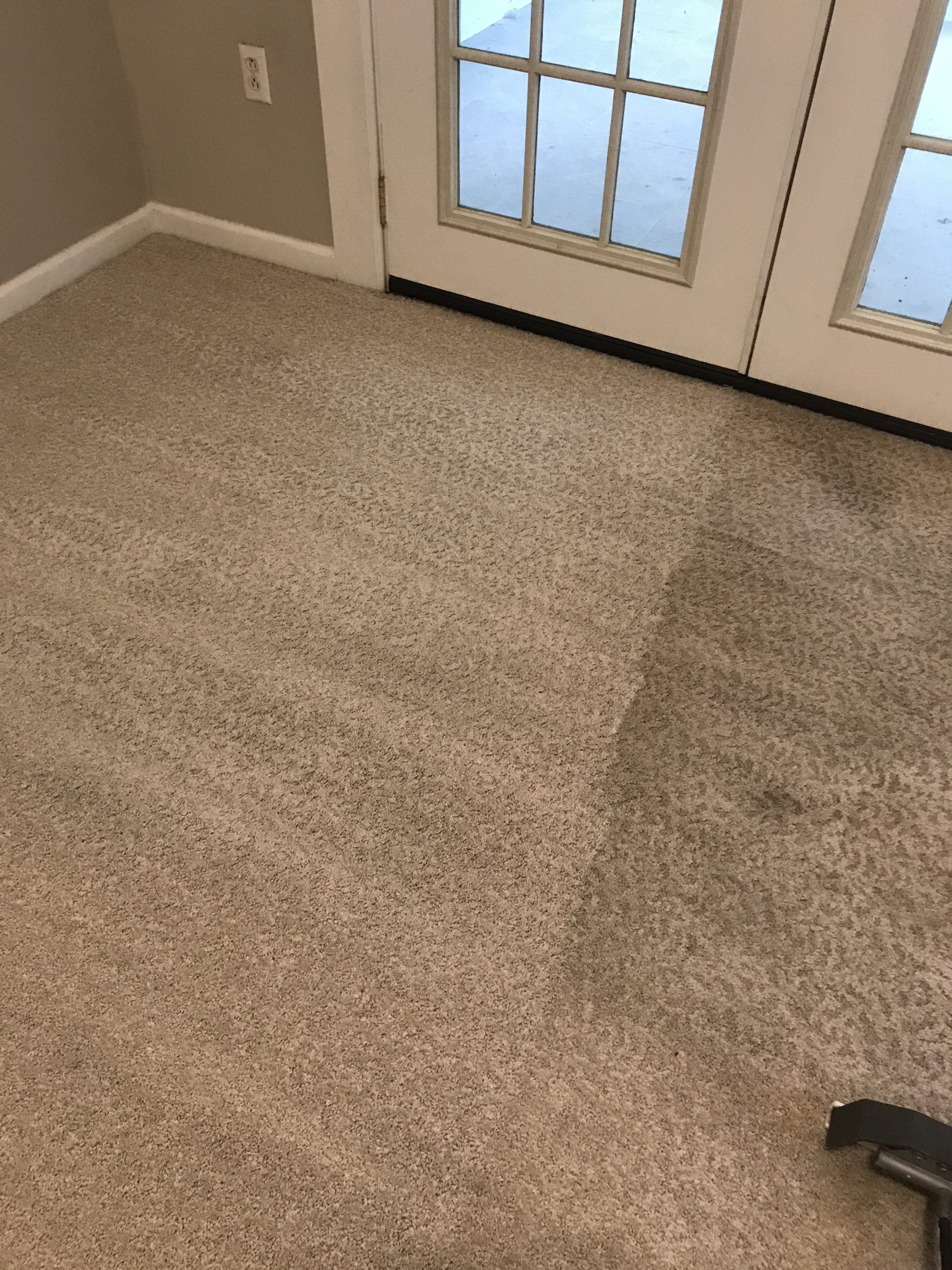

Last job was a three roomer today with heavy pet traffic that I somehow missed during the booking process. My P lime zyme was exhausted on the prior job. So I improvised and put 6 ounces of U-turn in a 4-1 hydroforce force. CRB then extract. Fingers crossed for no callback. 08F14DBE-991E-4AA4-B50F-0ADB3AAC5914.jpegA1AB067D-E8A0-42AD-98AA-A15CEF0EB561.jpeg091CC022-E605-468E-A487-30E7A8A14D52.jpeg

Two cups of 40 vol peroxide in my hydroforce along with my prespray.
Spritz deo around with a trigger sprayer

I've used peroxide products for over 40 years but didn't know what 40 volume was until I got on Mikey's board. Had no clue what Mikey was doing in a beauty supply shop but finally figured it out. Peroxide is peroxide is peroxide. You can buy 40 volume (12%) at Sally's a lot cheaper than buying a peroxide product from a carpet cleaning supplier. It all does the same thing depending on the percentage. I buy Sally's in a 1 quart size and out a sprayer on it. For stubborn colored stains that don't respond to regular treatments, it can be a lifesaver. Use with the same care and precautions that any other peroxide treatment suggests.
