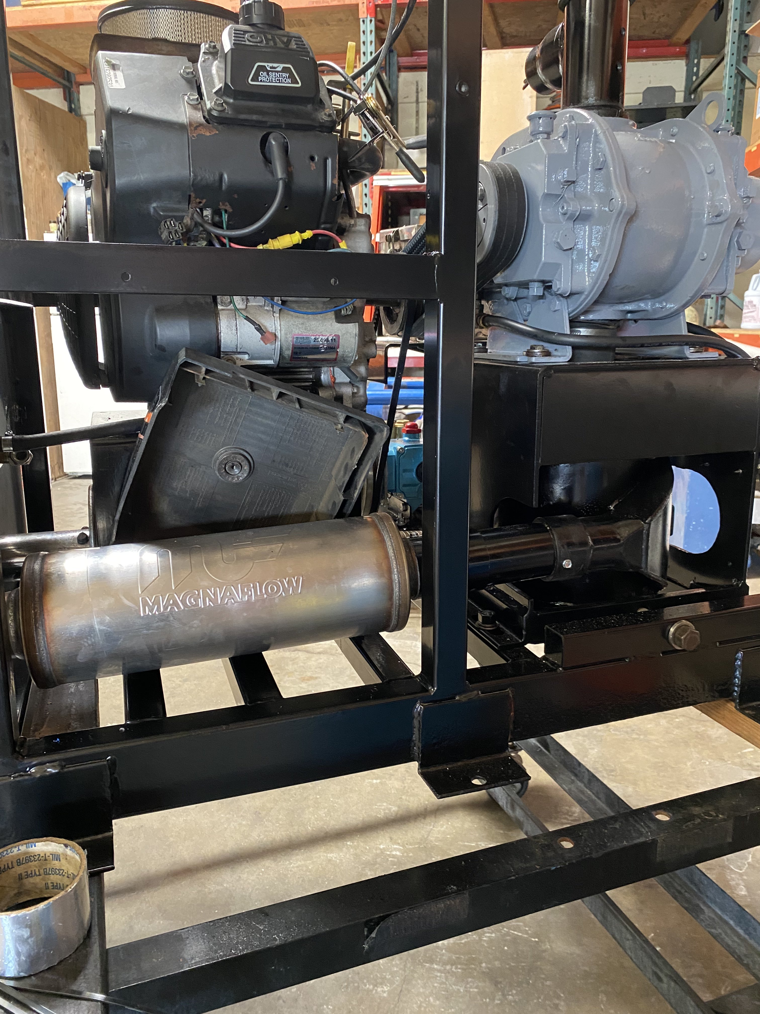

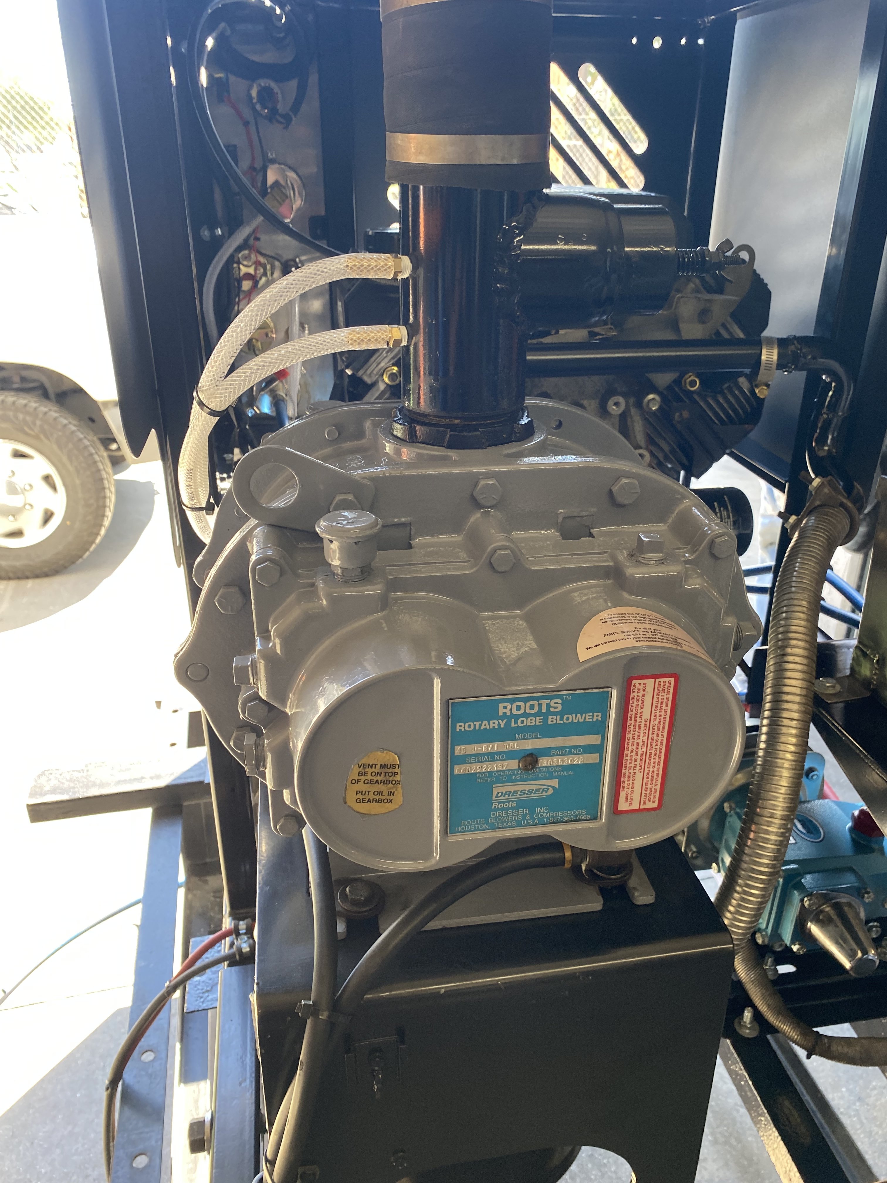

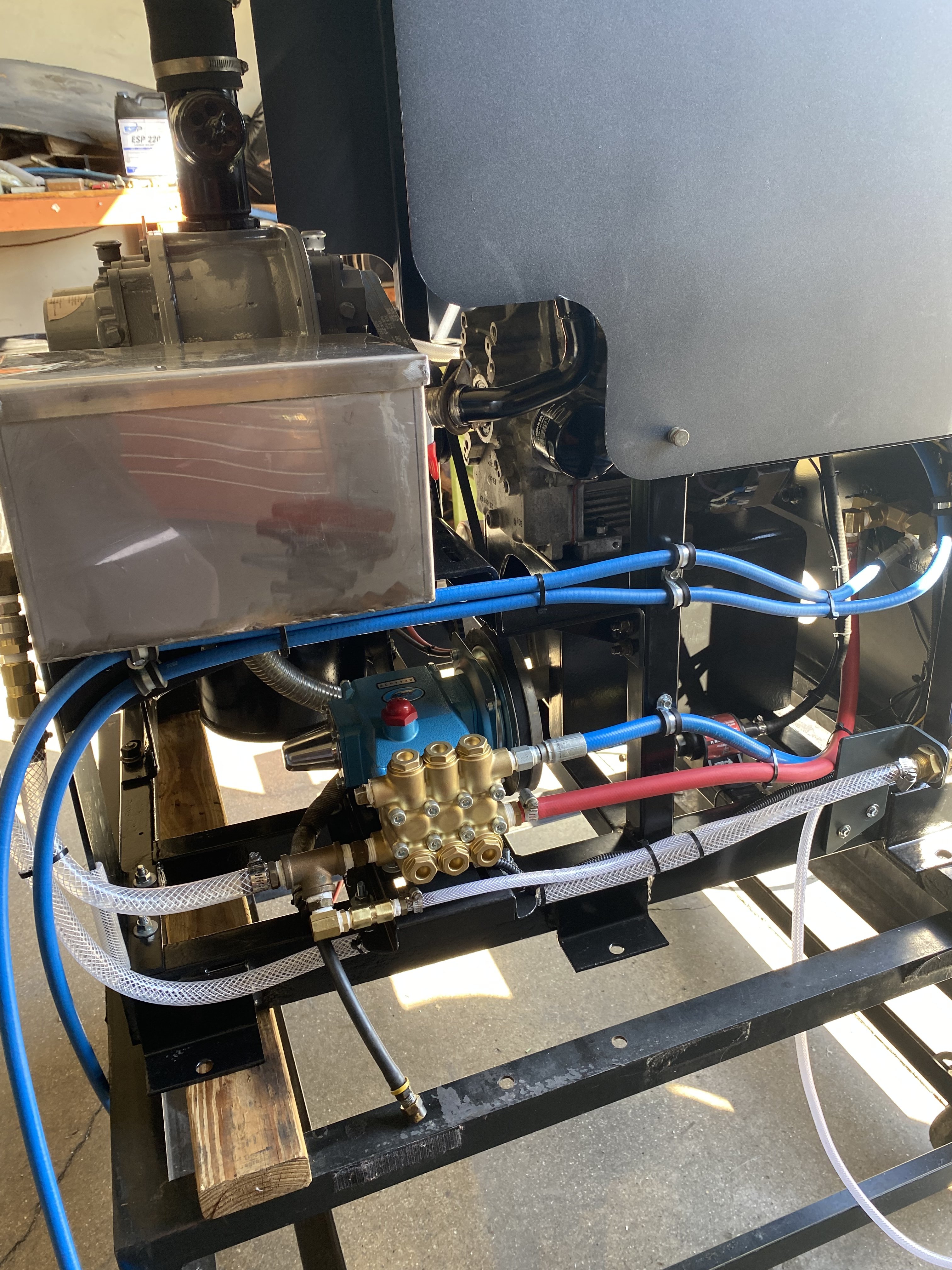

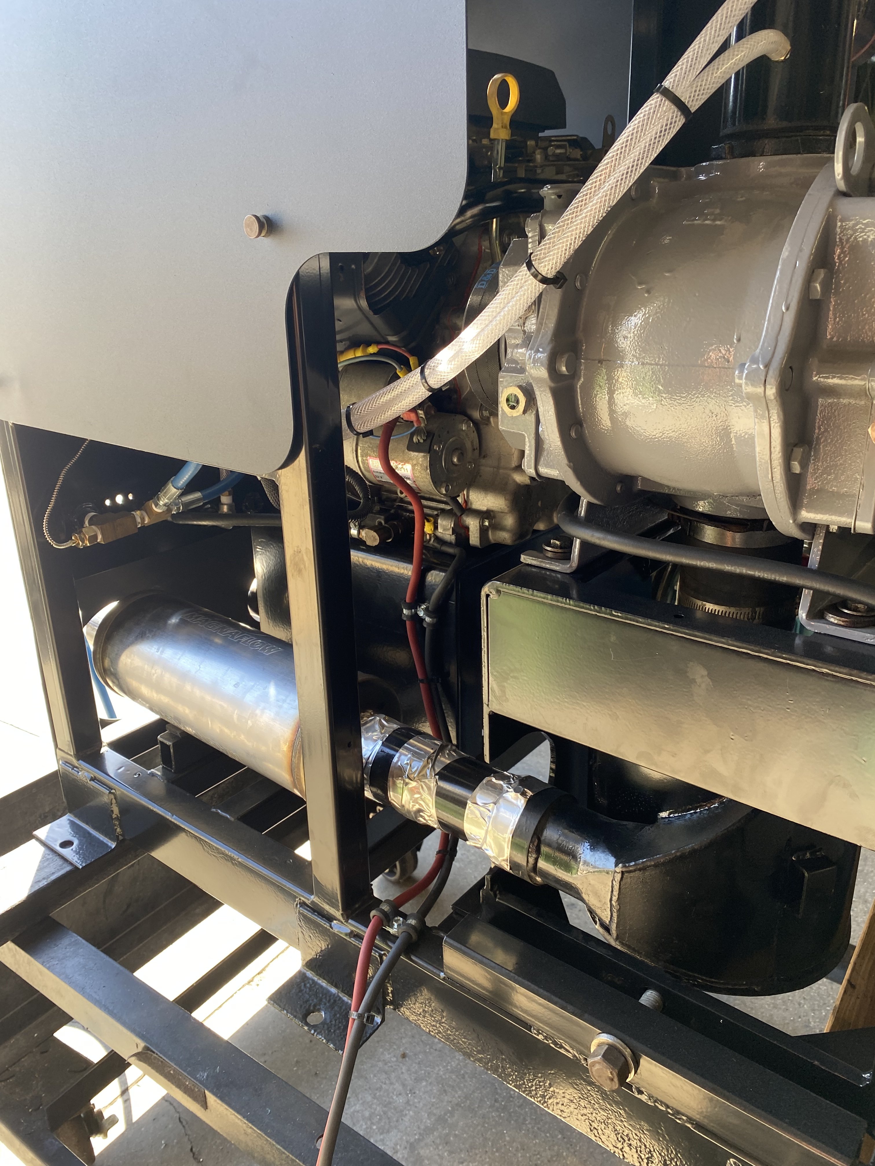

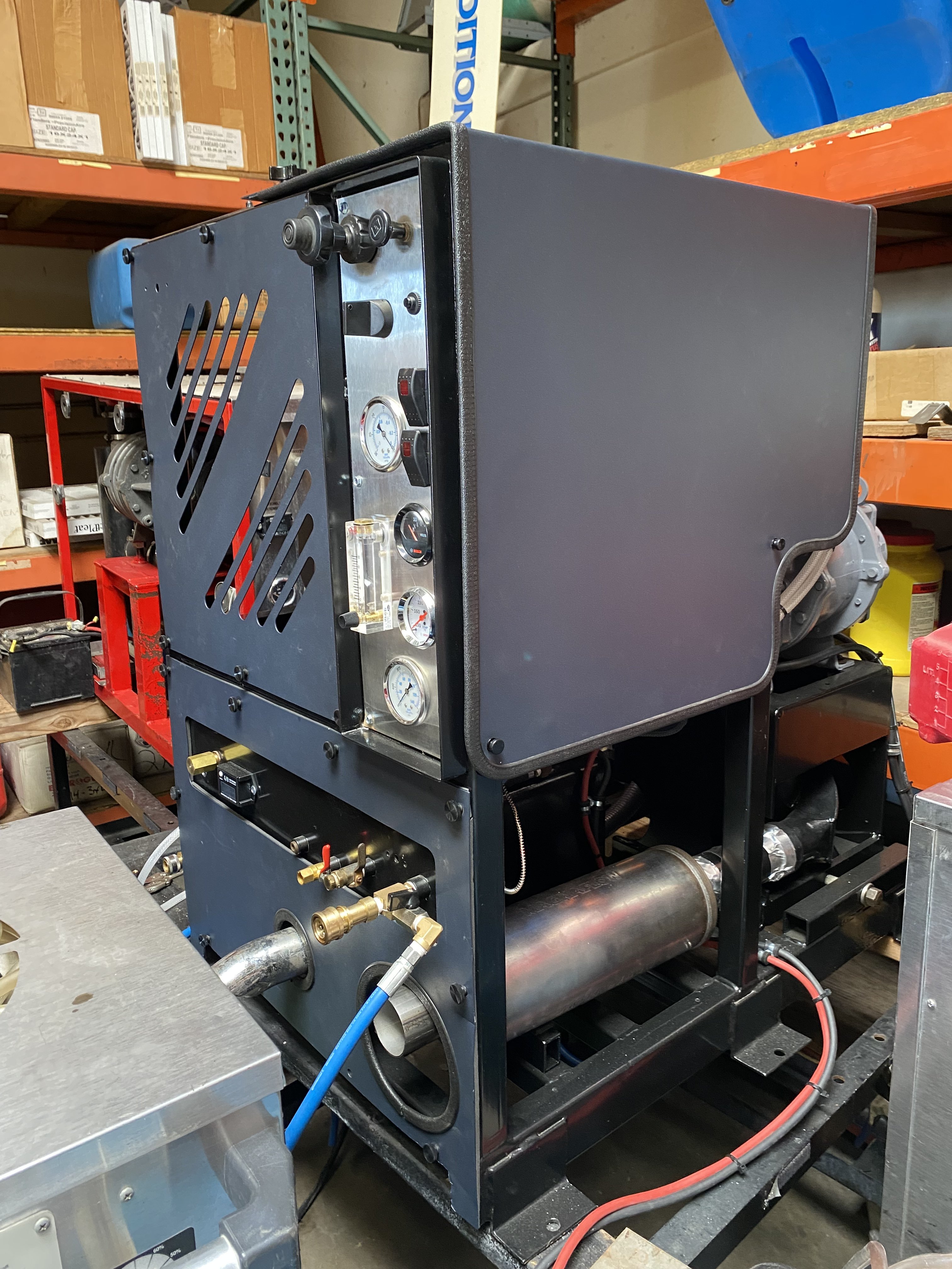

Power Clean Freedom 45 Tm
Custom rebuild-
Removed heat exchangers, original engine, water box, and excessive wiring.
Powder coat frame and paneling.
Replaced Kohler water cooled engine with air cooled.
Added #3 little giant heater.
Replaced water box.

Where's the heat exchanger located at on that unit? Or is it propane heated?

I have a Genesis 59 I hope to get around to doing this to
I'll probably keep/add new heat exchangers though
I have a Diesal DXT with the same size blower.
With Diesal at about $7/gallon, I'm probably going to sell the van/TM set up and switch to electric or another transit/370.

I overhauled my XT 47 last year. Replaced the Kohler Agis (water-cooled) 25 hp engine with a Kawasaki FD851D water-cooled 31hp, (same engine as Prochem or whoever they are now Peak), new IIT (John's Too-Hot Heat Exchangers) exhaust HX with bypass. Kept coolant and blower HXs.
Brian's is MUCH prettier.
