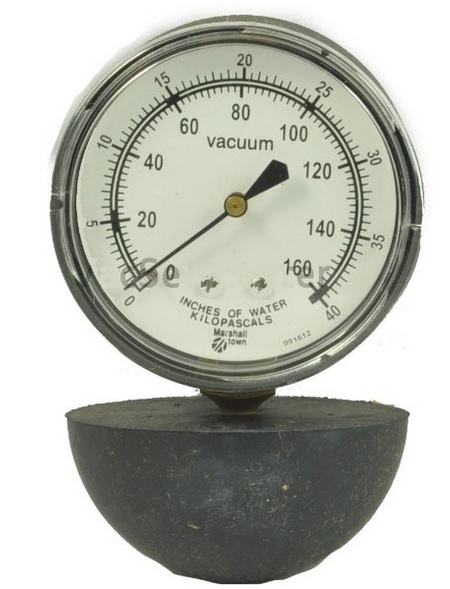

Dwell Pro Mike sent me this via his crappy phone.
I'll assume that when he hits the 2nd vac and the gauge tops out that that is a good thing..
Unless that a gauge for coke snorters... :eekk:
116,042
pretty sure it's this gauge.

That's an inches of water lift gauge..I have one...ur bissel powerstroke or whatever its called will probably test at 60 or 70 inches max...a good Lindhaus or Miele or any other decent vac LOL will test at 80+

A good Beam or Royal Central vac will test at 110-120 +++...Some at 135 145

Dwell Pro Mike stated previously that he used Ametek 116765 vacs in series, they are rated 130" or so each, two in series could go as high as 200", I suspect the gauge is pegged and the vac is actually a little higher than 160.
Those vacs in series run about 95 cfm open flow.

My older Re Coil only tested at 90 or so with both vac motors...but that is older style vac motors...Keep in mind central vacs tho dont have the new truck mount vac motors soo wonder what they have to test that high???

High lift equals low cfm. You can't suck a basketball through a straw.
