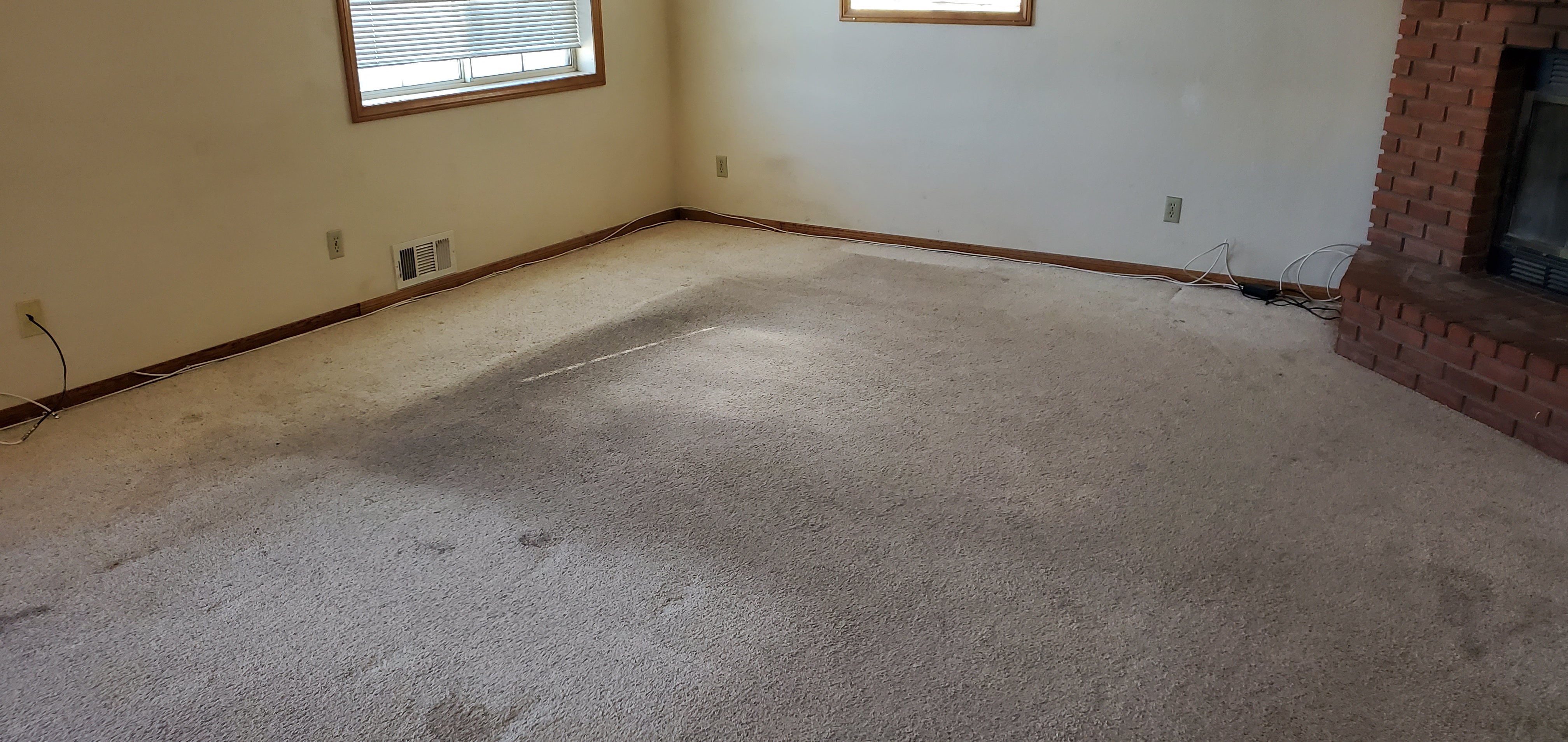

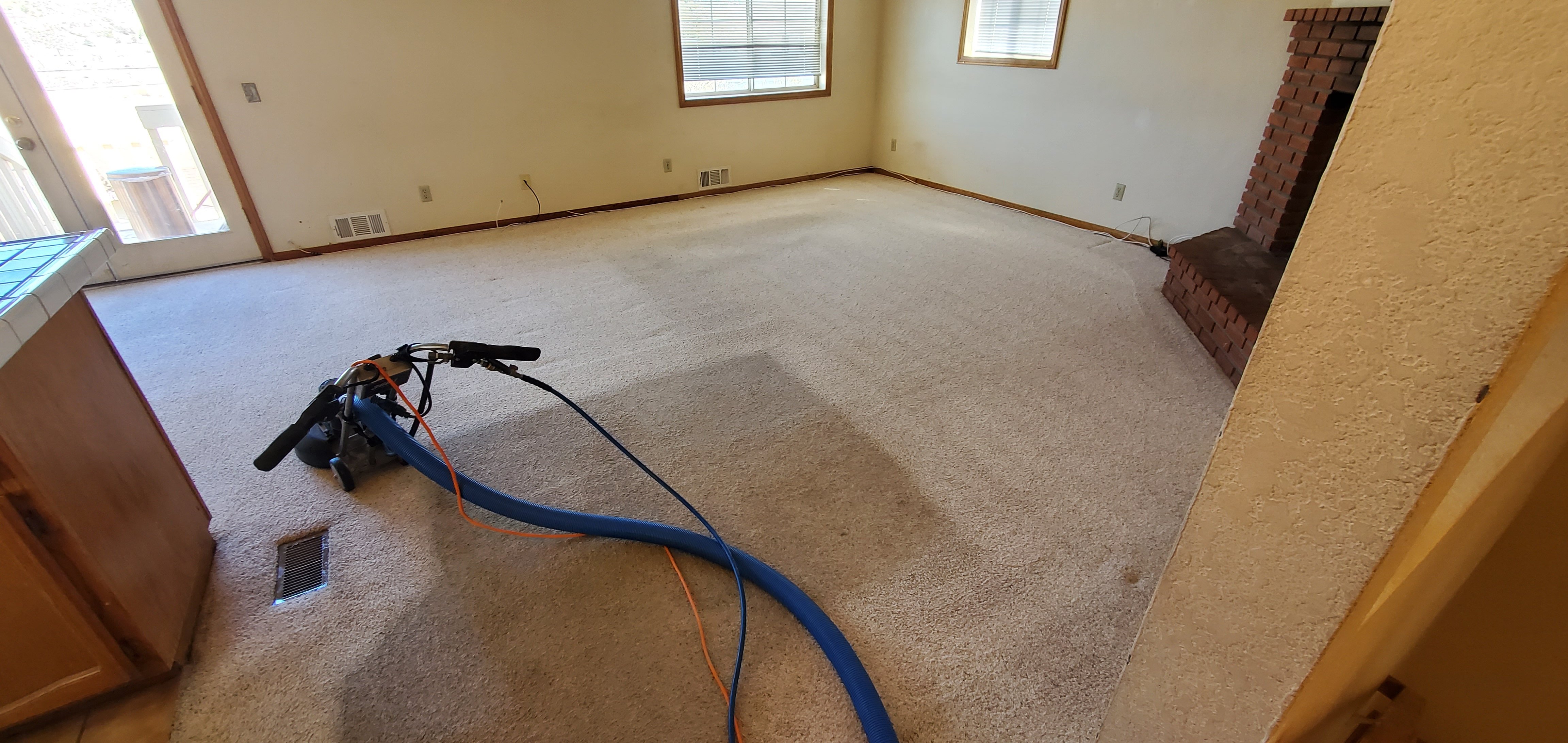

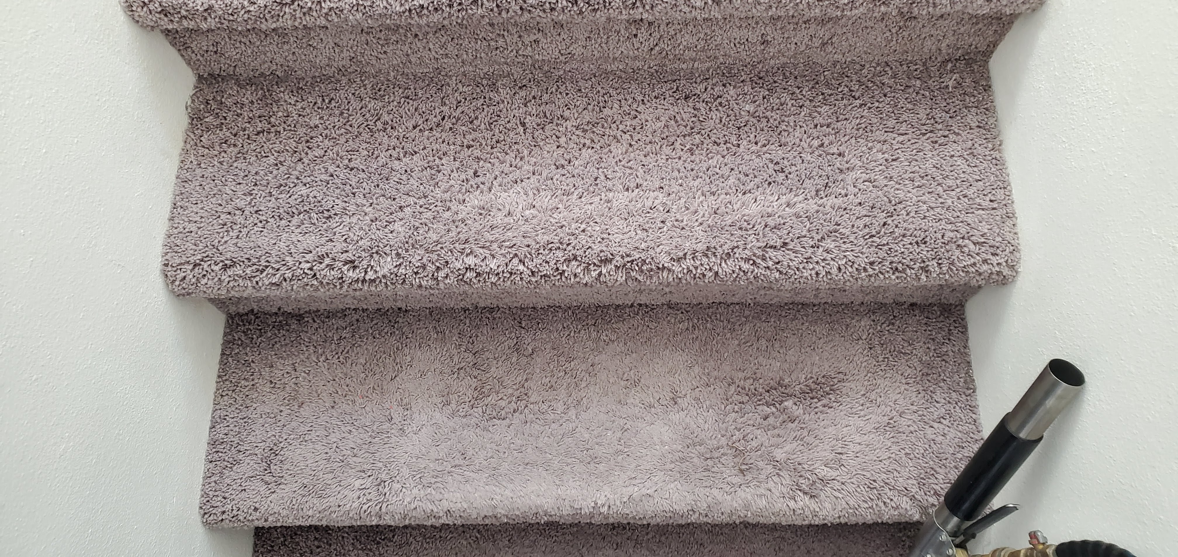

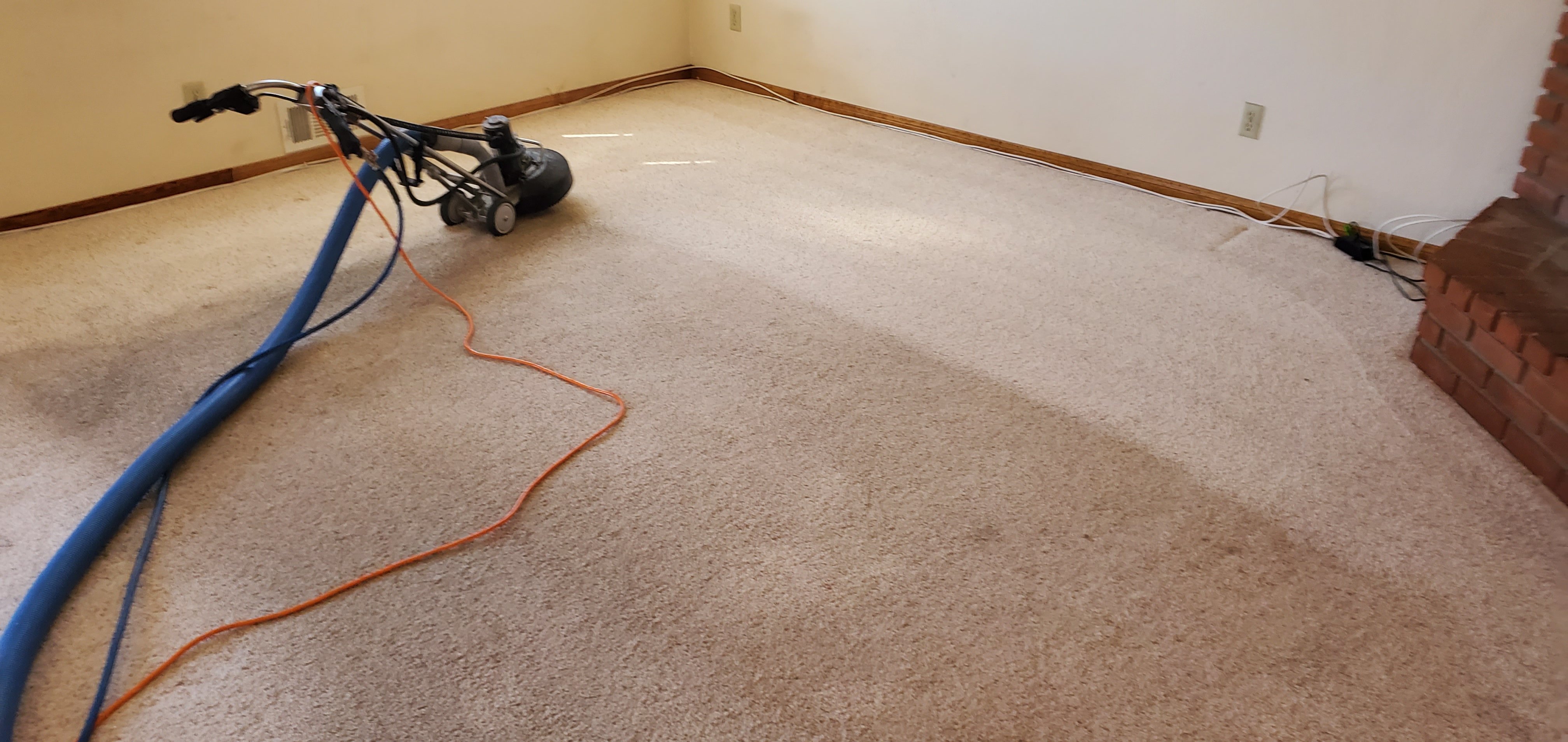

I didn’t take any, it’s not that bad, I’m just wanting a fix more for the next time....

It's never perfect with polys
