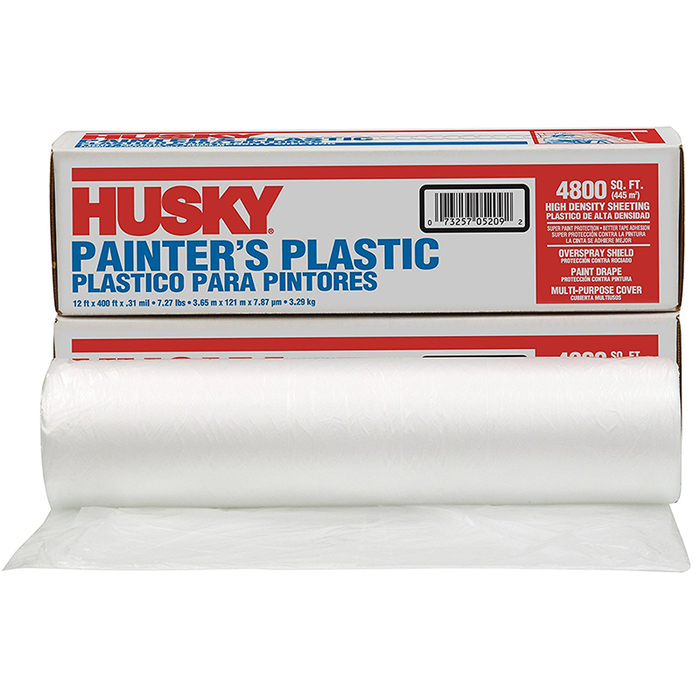

I vacuum, prespray naturals with Procyon or on synthetics Cobbs Powermax. Of course after doing a bleed test on any high $$$$ orientals. I put a strip of plastic under the fringes and use an upholstery tool to lightly clean them. Dry stroke thoroughly and immediately wipe around the edges for overspray. Never ruined a floor in 15 years.
