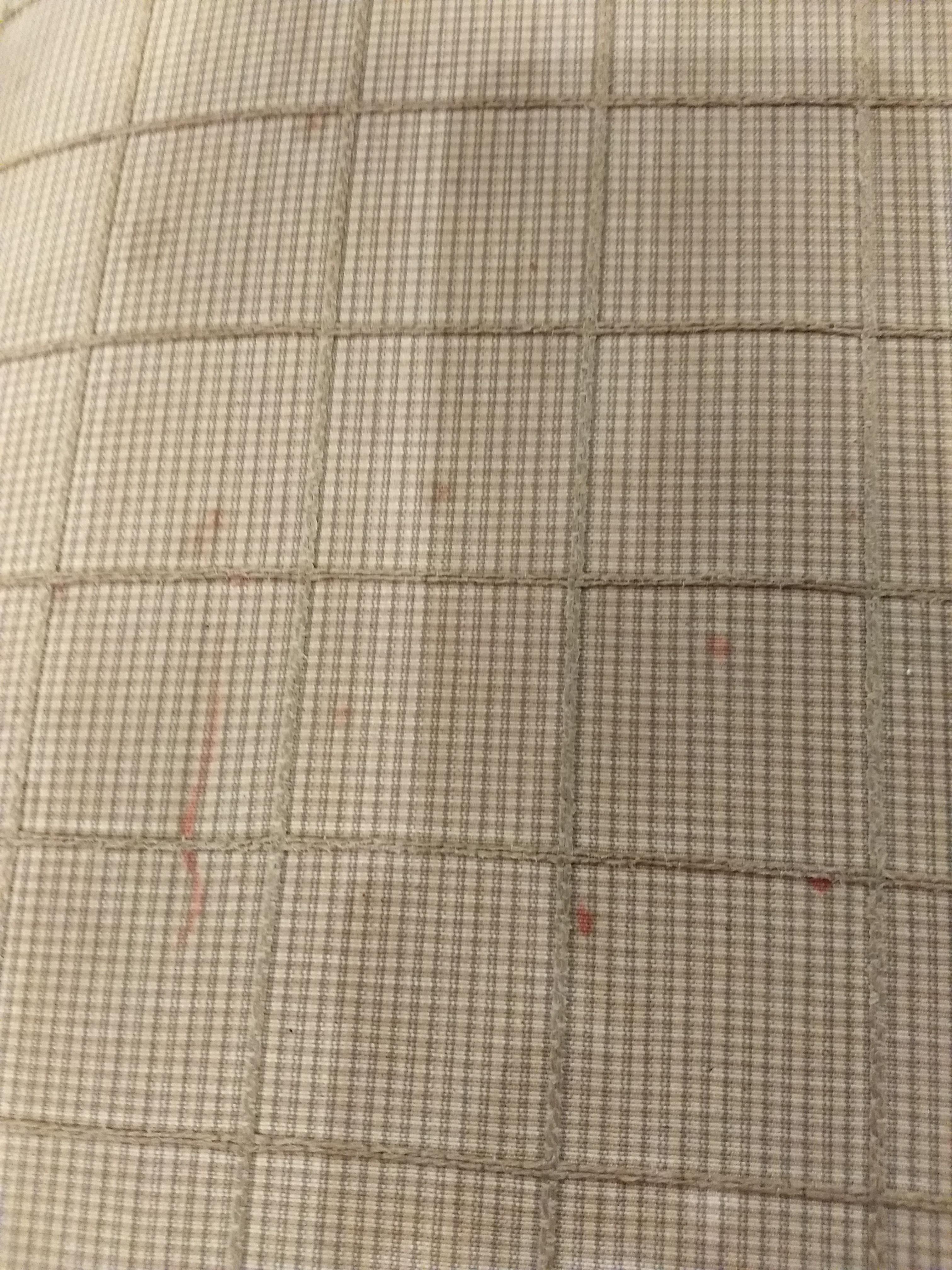

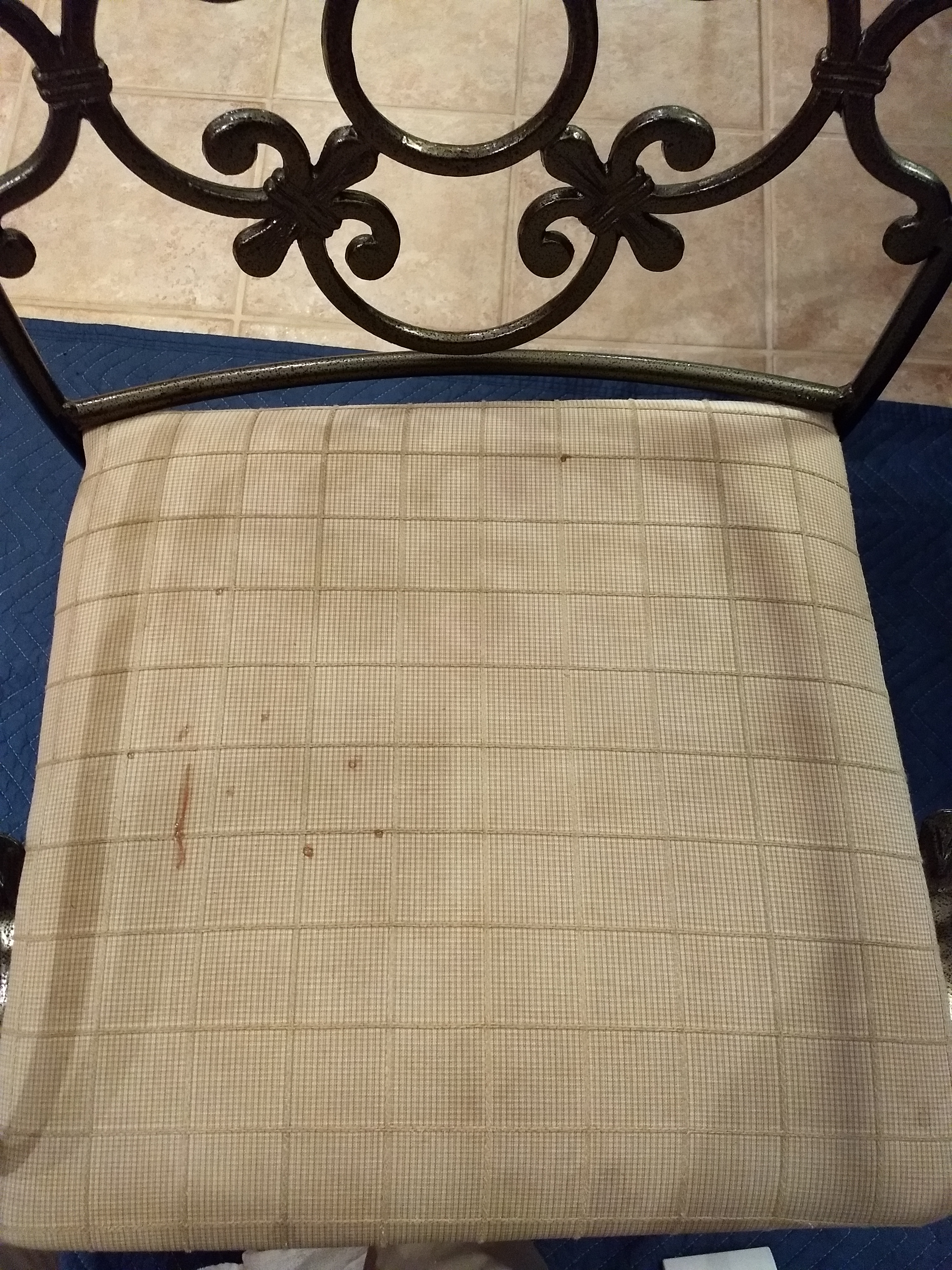

Recently I cleaned 4 upholstered chairs. Mrs. Pffft (why do we call her that?) said that the grandson spilt playdough on the chair.
I was able to burn test the 3D fibers, the fibers that make the "grid", and it ashed. I was able to lighten the stain with All solv/avenge pro.
What would you do next?
I offered to go a step further with oxidizers/reducers and warned her of the risk. She declined.
The next week I had a stain on what looked to be cotton. The stain would not budge with the allsolve/avenge pro combo. Same story, lady did not want to risk the fabric.
Can I use an oxidizer on cotton ever? Should I dilute it? Can I use red relief and a steam iron on cotton?
I think I need to take another upholstery class. Anyone ever take Joey Pickett's class? red cotton.jpg red cotton 2.jpg

The use of oxidizers on cellulose fibers (cotton and linen) and regenerated cellulose fibers (rayon, viscose, acetate) can be a problem. Anything stronger than 3% hydrogen peroxide will deteriorate the fibers to the point where they will split.
Reducing agents are safer, but can sometimes create odd color reactions, especially on prints.
In either case, keep the problem your customer's problem, not yours, and proceed with care.
Joey Pickett has a great class, and he's not far from you. You'll enjoy Joey's down to earth nature, and encylopedic knowledge of textile cleaning.
If you don't need certification ( I parted ways with the IICRC some years ago because of disagreements I have with their training model), I would be happy to have you come to one of my classes. I focus on stain removal and restoration of color and texture problems in delicate natural fibers.

Yes. But you need to be patient. It often takes hours to know for sure.
. I just wanted to see if there was anything I could have done besides using stainzone full strength and red rescue with a streamer which was my next idea. I have a hard time going slow enough/being delicate enough with stains like this on natural fibers.
Stain Zone is a great product on synthetic fibers. Its nearly a guaranteed "hole in the fabric" for anything with cellulose fibers. It may not show up while you do it, but one day Mrs Broadinthebutt will plop down on it and the tear will occur.
I clean so much synthetic carpet everyday that I have become used to nuking stains like this and getting away with it. And then I want to transfer those techniques to upholstery
Joey and I agree on many things, and my guess is that he will tell you what I will:
You will never be able to have the same success in removing stains from natural fiber fabrics as you can with carpet. You can get better at it, but part of becoming an upholstery cleaning expert is teaching your clients that such fabrics need to be treated with care. Fabric protector on upholstery is far more important than carpet protector on carpet for that very reason.

For a safe oxidizer on natural fibers, you can use regular drug store hydrogen peroxide or you can dilute StainZone with about 2 parts distilled water. You will then be at a safe level of oxidizer and get the benefit of some of the other ingredients in the StainZone.
Jim P mentioned one of the key elements of stain removal. Something that I often try to stress - PATIENCE! It may require several attempts with less aggressive stain removers on natural fabrics. Don't rush it.
The goal with upholstery is always to improve the staining as much as possible without damaging the fabric, color, appearance or texture. Often the final desired result is something less than 100% perfect.
