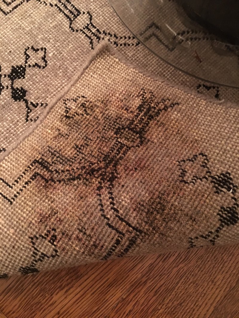

If a rug has planter caused mold/mildew on it. Not rotting but definitely some damage. Planter removed and will not be there again.
Is there an advantage in cleaning (as it may reveal more of the damage and fiber loss.) and also is it really necessary to remove it. Or is it better to spray with a products that stops the mold (which will it be in CA?) and just let it be?

I have it as pictures in the body of the email (not an attachment). How do I load it?
Phone or desktop?
Android phone put you finger on the image and hold it. Then save to gallery.
At the bottom of the MB message box it says "Upload Photo". Click it and look for it in your gallery. It will upload from there when you click on it.
How stable is it still? It looks pretty good from the picture.
If it would hold for a cleaning I'd clean both sides. You can always use the Sapphire tool and break the vacuum some. Spray with whatever disinfectants Cali allows.
If its not stable the you don't have much choice but to spray and run.

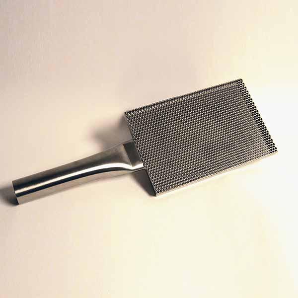

I know of a great perforated Stainless Steel Paddle Spotting Tool that would be just perfect for flushing this area out gently.

  1. Since structural damage is done, what will a flush accomplish?
  2. Would you spray a mildewcide and then flush?
  3. Does it need to be flushed?
  4. Wouldn't a flush increase buckling (warping)? Not that it's not already there.
We can use Benefect and Microban QGC , in CA, Will these do?
Benefect smell takes forever to go away and I never used QGC, it is lemon scented (I don't know how strong.)
I haven't seen the rug in person.
I like that tool Tom, could you send me a link to the thread in which it shows. I know there's a similar tool by PMF I wonder what are the dimensions and will yours work well for upholstery cleaning situation where the handle needs to be fairly short?
Flush will remove any loose contaminants (digested remains). Milgo might make it a little foamy but yes I'd give it a light spray before and after. Vacuum after you spray, force dry.
You can always use a fiberglass screen until you get Tom's tool.
https://www.centrumforce.com/products/stainless-steel-rug-spotting-extraction-tool
Paddle is 6" X 9" and designed for rugs in mind as well as for upholstery: cushions and arm covers.
