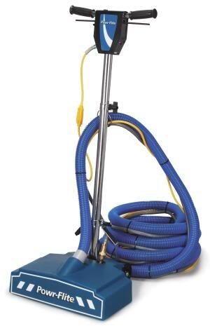

The problem with your suggestion is the design...It has a "sand trap"..that leaks air..
I guess you could "disable" the Vac. motor ...BUT WHY....?
If that is what you want ...Just get one of these.. :!:

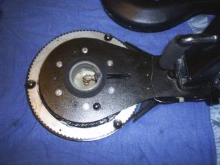

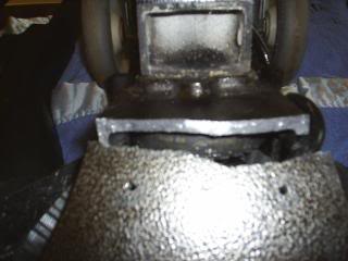

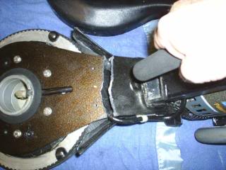

Greg Crowley said:
This is the one I have that I was refering to
That's the same one I have.
new brush, gaskets, seals etc.
it's in tip top shape.
it digs impacted crud out of carpets MUCH better than a vac.
It digs crud out like no vac can...cause that's what it was designed to do.
But it's NOT a good vac....it's a pile "brush"
as Germ said, use the pile brush, then an upright for a superior brush 'n vac.
Dan, we've hooked ours up to the TM.
It made some difference, but it's still not a good vac.
We've also used it to agitate pre-spray and even used it to encRap with.
a 175 rotary works better for that though
