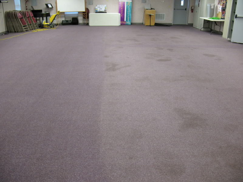

do customers complain about the streaks/lines. Or do they go away after vaccumming or use.

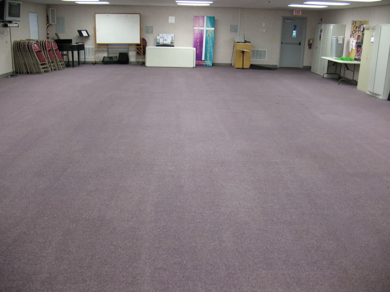

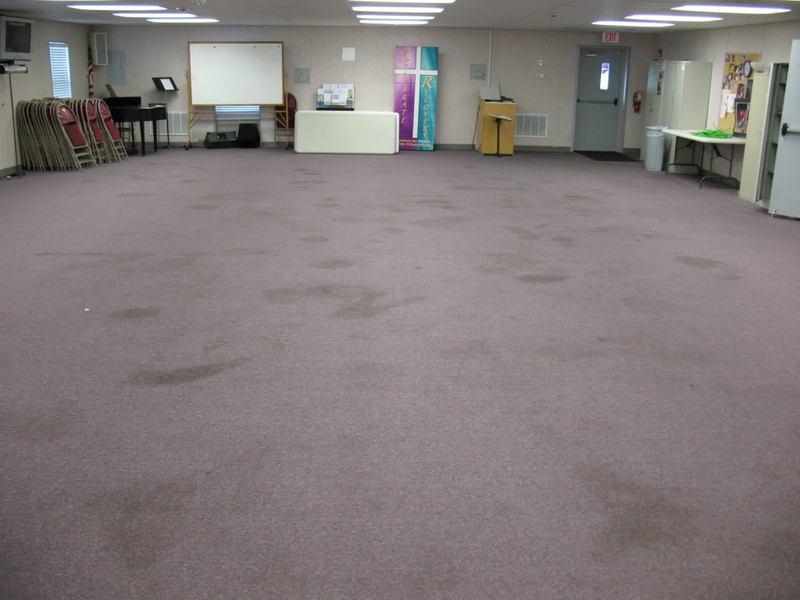

On that job, they performed the same. We had 16 rooms half the size of that one in the picture. Did 4 of them with the OP using a pink pad and they came out just the same. I have gone back twice since to view. Dried up beautiful. Only spot was an area that I left the cimex down for w/o flipping up for about 2 mins as I chased solution and it got too wet. A very slight mark from the over wetting. Spraying a citric acid solution and buffed for 20 secs.

They got tore up pretty easy. Went through 4 of them pretty quickly. The did buff some tile pretty well. I did not see any noticeable difference from them to the floor pads. I can change floor pads and acheive greater aggitation for better appearance (not cleaning, since not really removing anything).
That job with the pics I made the janitorial crew look like a bunch of chumps when it comes to carpet care. They are trying to clean that carpet with an automatic floor scrubber. :shock:
