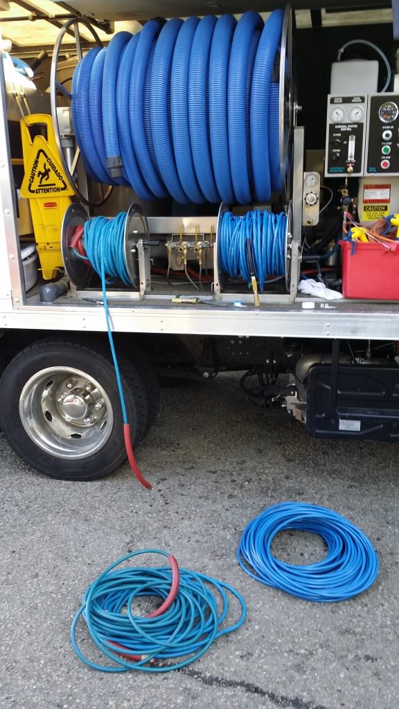

yeah, kind of a let down.
You'll be thrilled to know I got a box of fresh Parflex 1035HT to day to replace my Chinese bleeding hose that I mistakenly chose for the AT.
1035 may be stiff as hell but over all it's the hose with the fewest evils.
