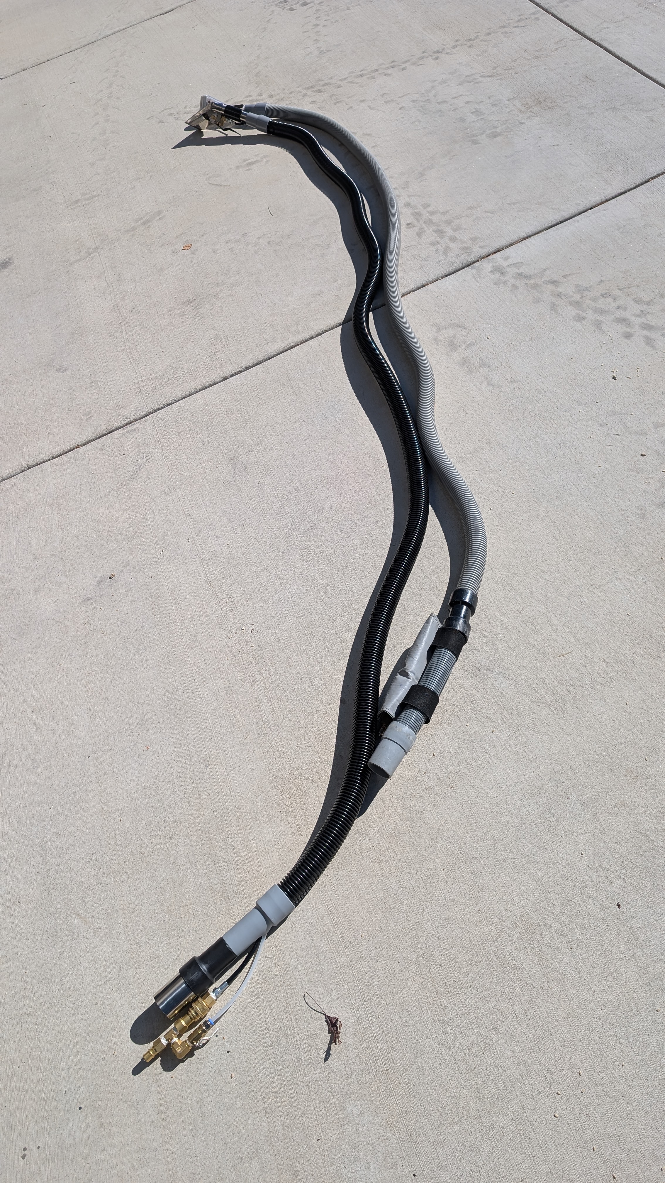

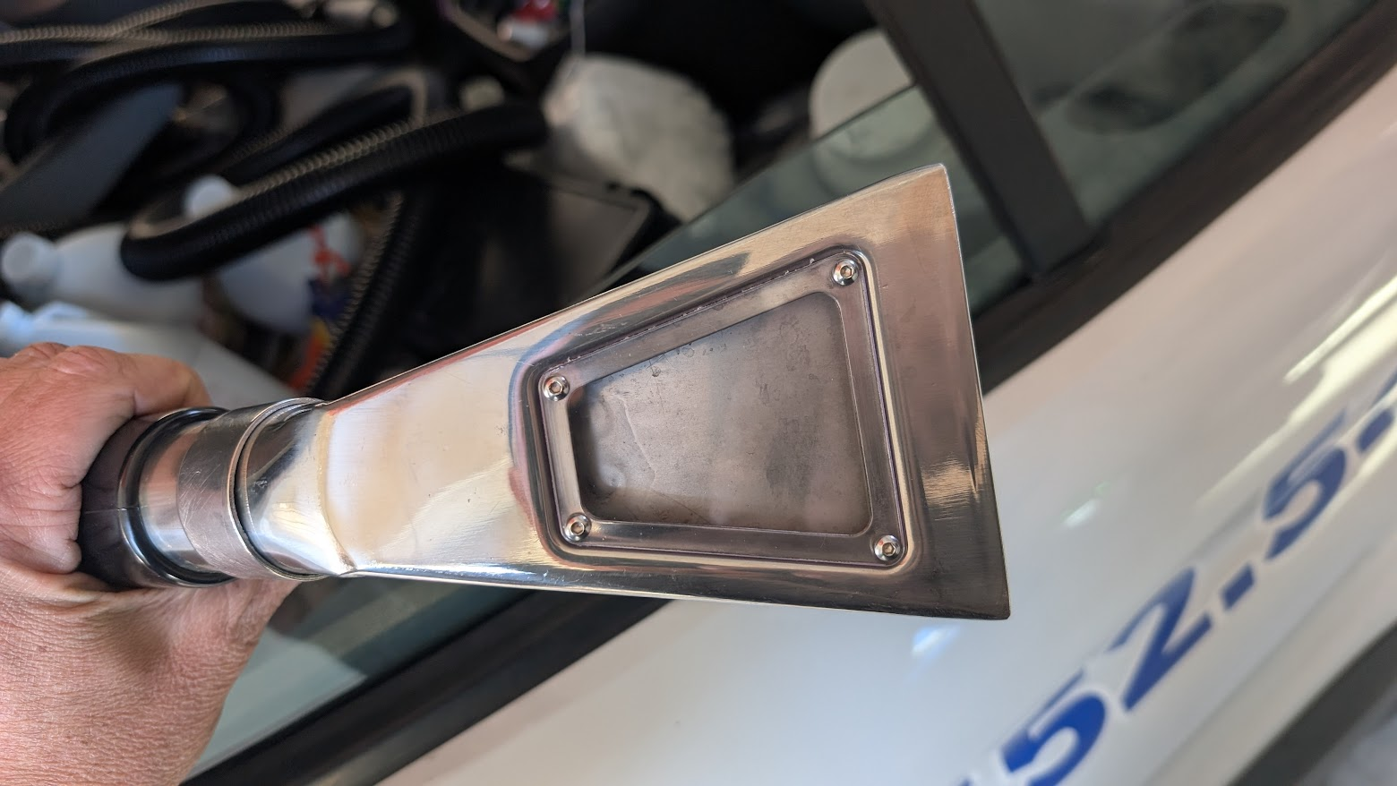

I sent out a video to folks who really know upholstery cleaning and received these comments
Looks good, and pretty much what we discussed. I like having the bypass as an option too. If it is at Indianapolis, I'd like to test it with an El Diablo to see if opening the bypass gives enough flow to fire the burner. What size jet?I like it,
I’ve actually been on the hunt for a new tool that I can use on airplane interiors. Right now I’m using the Prochem tool, it can have a lot of over spray if I’m over 300 psi. And because I’ll go from carpet edging to the seats it’s not practical to be running out to turn down pressure. I especially need to be careful doing the pilot seats because of the instruments that are inches away. I personally would be interested in a hose that is twice that long to keep the fittings out of the cabin area where I’m working.
I like the tall head idea I like the idea of the window Very helpful on fabrics I can’t tell you how many times I’ve snagged that trigger and thought I would tear a fabric . Can’t believe people love that thing!Also the 1-1/2 hose is to awkward.
Wow You just changing the industry. I really like the upholstery tool. I like the enclosed spray jet. But should be an option. If course your GG on it. But did I miss the vac release on it? Pmf has that SS hose connector with a vac bypass. I like the higher stance of the tool. Keep your gorilla hands from rubbing it shaking fine weaves. You might consider the overall weight. It could cause carpel tunnel on large upholstered sectionals. You might consider changing the hidda hose to 1 1/4" vac line. I like the glass window idea. As for the bypass on the inlet side. That's an easy addition. Again maybe set up as an option for the low heat tm or portables. I love the vac release on your tile tool. We're you getting requests for it to be added? I thought it worked great without one.
The placement but the head is the first one I've seen there. But it makes sense because you were drilling holes in the headI like itI like the longer bypass dump hose, we had problems with the old Kleeenrite ones being to short, and being so hot it damaged the vacuum hose. A window is almost a necessity to compete with the clear head tools, and makes it less of a guessing game for the technician.
In general I prefer an internal jet tool, but the enclosed spray is a big improvement over the typical external jet configuration.
A beta tool will be in INDY for evaluation

What's the difference between an internal jet and your enclosed jet? What size is the jet?
My enclosed yet is not in the vacuum chamber so you can run as little pressure as you'd like
The spray chamber along with its four evacuation holes will take care of all the overspray and unused water commonly associated with cleaning microfiber

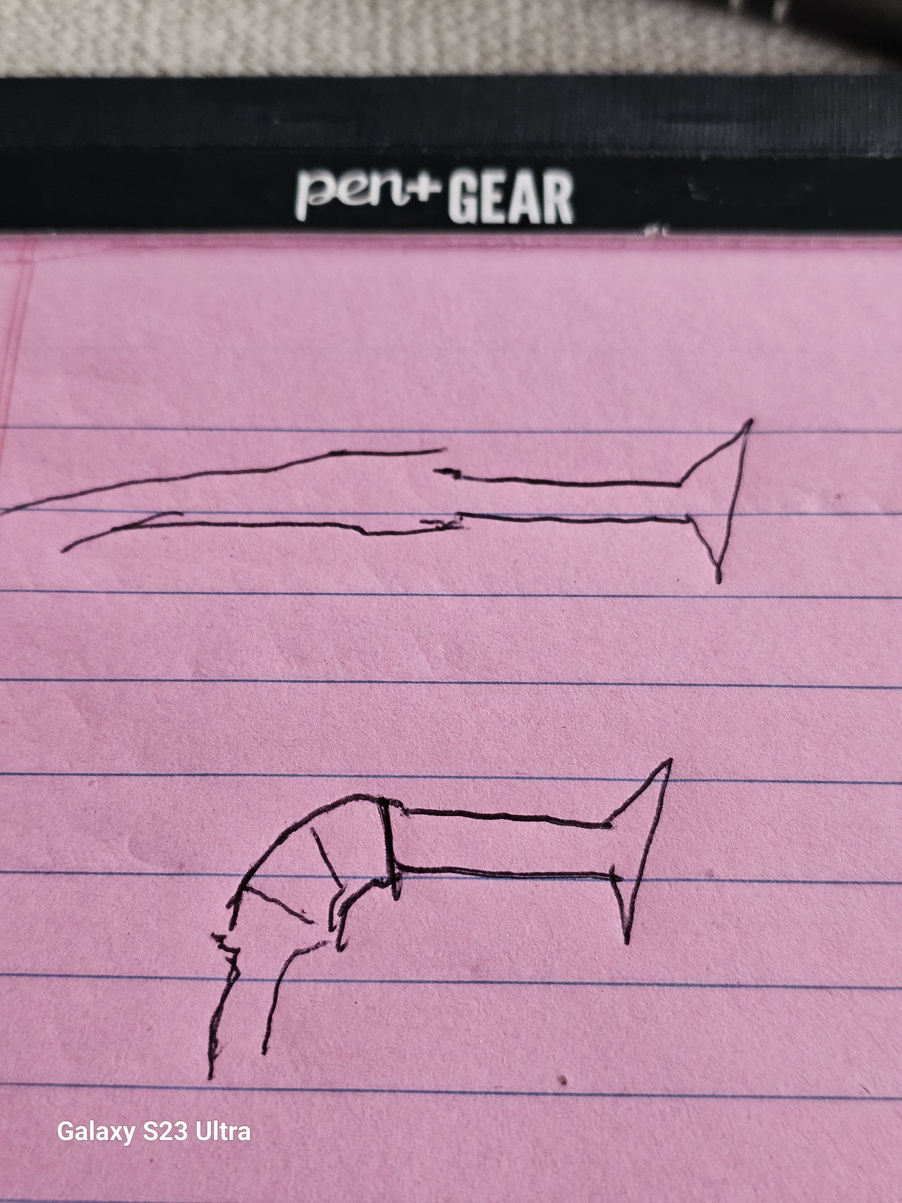

Not sure what you have going on the stairs tool but I woukd like to see a swivel connector for vac and solution lines together so I can do risers easier.
Not just easier but keep my hoses from bending 180 degrees. That's my biggest issue.

I know but it should be one piece already attached to the wand. I swivel the cuff but it still gets twisted upward stressing everything my arms included.
A swivel like I'm thinking qoukd keep all the hoses laying on the stairs stress free.

Looks like the original Drimaster, in metal. That's a good thing. Just looking at a picture it might be little pointy for pushing. Key question is when?
I have a client needing to get new, and standardized, upholstery tools but he's going to need to move fairly quickly.
115,974
Once I finalize everything it'll take 8 to 10 weeks to have the new bodies made with my changes but the Glide should be ready in another couple weeks.
The Glide will fix the pushability...
When I first proposed the question of whether it should have a spray shield or not I was surprised at how many didn't think it needed it....

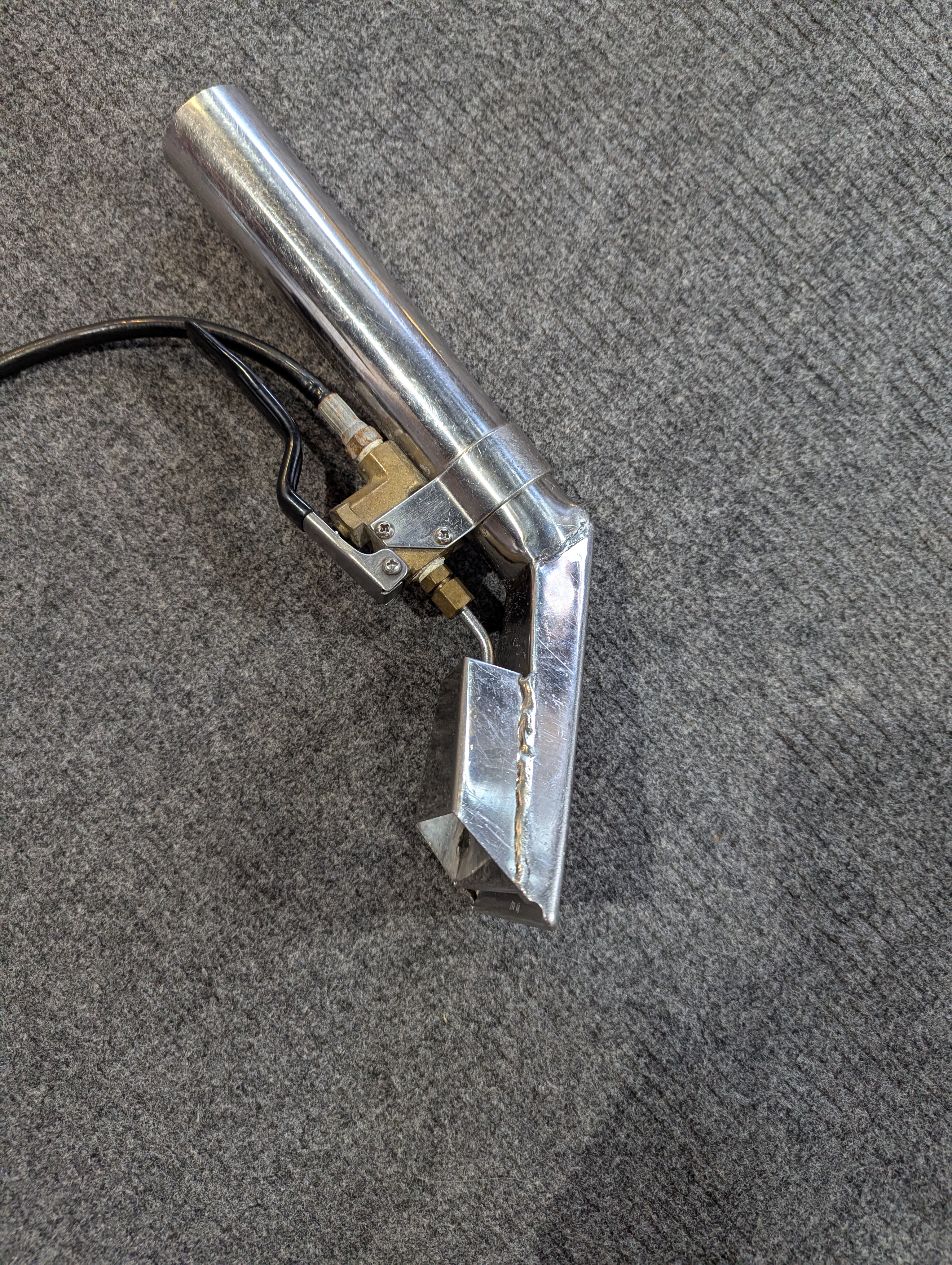

It doesn't look much different than this one
115,974
same base
Add a 1200 psi valve, vacuum relief holes on the back of the head, a GG that also surrounds the spray sheild, a view window, 10 or 15' hide a hose and a (optional) circulating system.
Ya see Ron, thats what I do best, turn the mundain tool into a rockstar.
27,863
same base
Ya see Ron, that what I do best, turn the mundain tool into a rockstar.
Be interesting to see it when it's done
