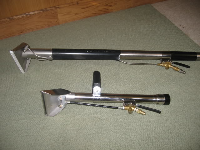

I really like this tool for detail work like stairs, thanks Cobbs for a great tool
Jim Martin
10,878
Arizona
Jim Martin
I got one that looks something like that from Greenie years ago....A RV joint here in town had me doing a bunch of there rigs and so I got it to help me with them...good little wand for tight places...........
Reactions: GCCLee
I love mine too ..it's looks similar to your Cobblet tool
The large one is a Greenie tool..it's a good tool, but I personally prefer the smaller 22" tool

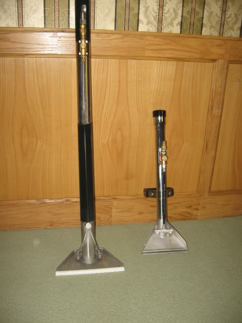

Dang, Larry. You keep your tools clean.
LOLL, Art
Those were new 5-6(?) years ago
I don't know what country of origin the small came from, I DO know it's a well made solid "forever" tool
I don't know if it's the same as Cobblet's ..I bought mine for down right cheap (like a $100?) from some chic on e-bay ..that wasn't around long ...maybe the Asian mafia got her??....i donno, but do it's a damn solid tool

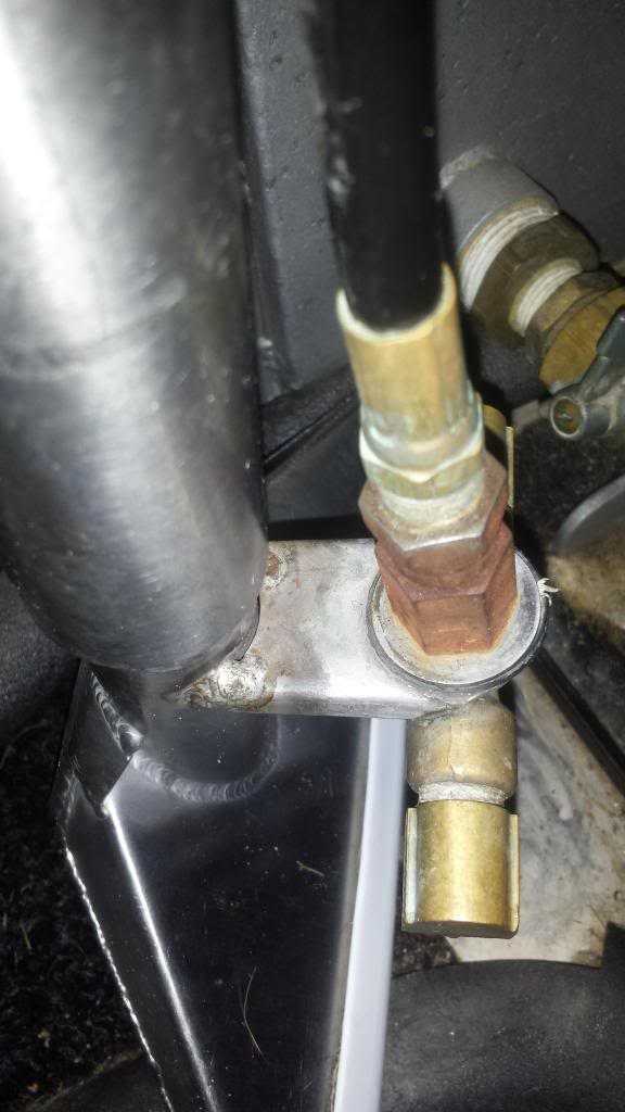

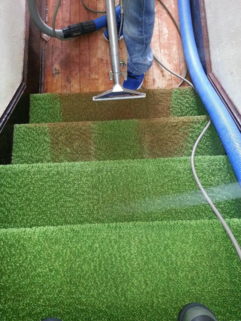

Here is one of our 2 stair tools with swivel head. They are terrible with a single jet in my opinion, but with (2) 80015 jets, a Hybrid Greenglide and soft pull trigger, we do love this tool.
One I had built by PMF the other I got from John Olson. The first one I got has 1/4 inch size jets, the one from John Olson has 1/8 inch size jets with adaptors. Both work great. I am thinking about ordering 1/4 size for both and then experimenting with check valve extenders as well. Just on my "To Do" list and haven't got to it yet.
Flushing out Red Iron Ore from steps (not really easy all the time)
Before new jets were replaced for this worn out jet (we took the pic to get the correct jet number at the time)

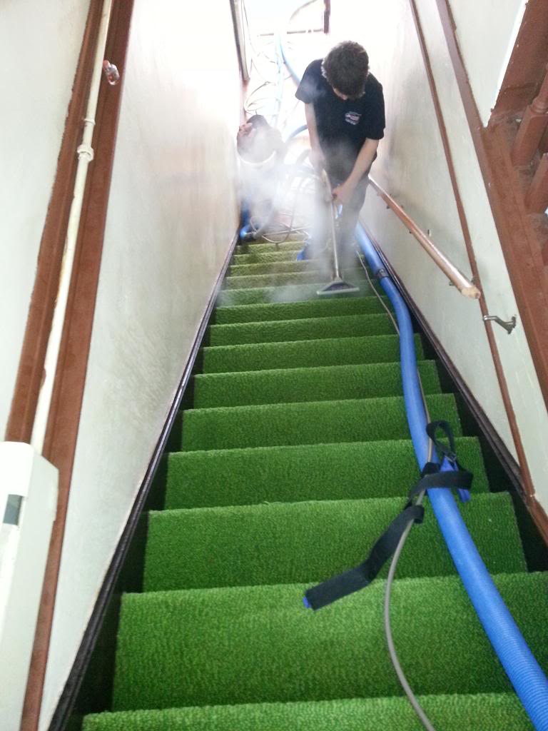

Any of you guys have any videos of your step cleaning process? I see everybody using these bigger wands for step and that just looks like a bear. I use a much smaller hand tool, sure it's more bending over but it enables me to get the nosing and the risers very well. Anyway just curious as to what process everybody else is using.
GCCLee
Jan 29, 2012
5,113
East TN
C. Lee
Someone actually posted a few vids awhile back , was thinking Mikey might have posted one of his Son, FRED Fetch : )
It is exactly as you would imagine. To clean the faces you gotta flip the wand over and Man Handle it : )
First set is always the worst, you get better. Watch the ceilings if there are any.
