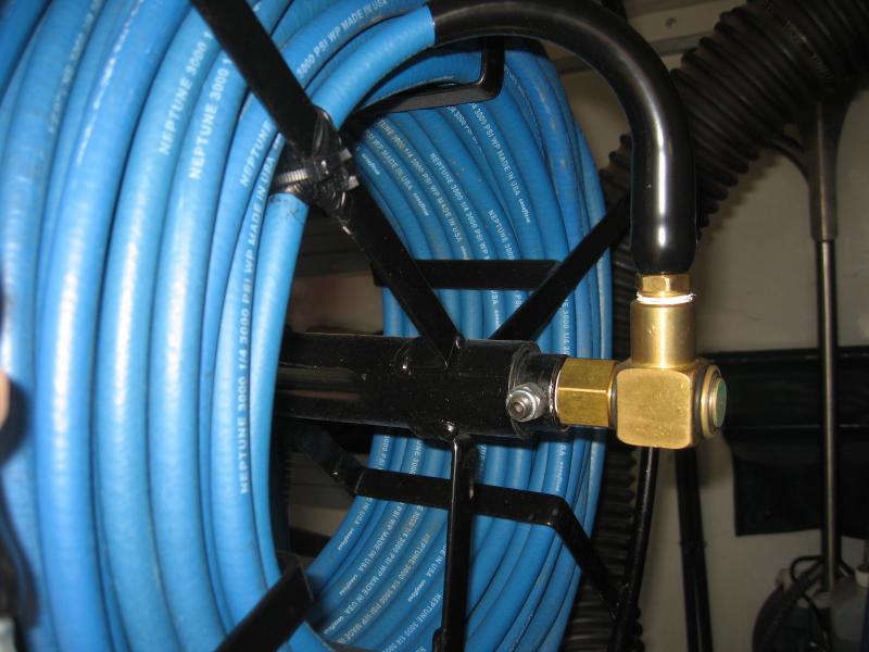

The biggest issue that we see with a live solution reel is that the swivel (we use Rokan's swivel) is a wear-and-tear part. Don't have much issue with live garden hose. I think both have the ability to make life much easier. If you go with a live solution hose, I'd recommend longer length hose, maybe like a 150' and two 50', and put the 150' on the reel last. Would definitely stay away from live vacuum. We do put a remote port at the back of the van, which makes life easier, too.

windtrax.........part number 7475 is the swivel..
and part number 7475K is the rebuild kit....
about $30 for the swivel and $12 for the rebuild kit...I have used these for years on fresh water....solution...and my APO... and only had to rebuild one and it was on a fresh water reel....
