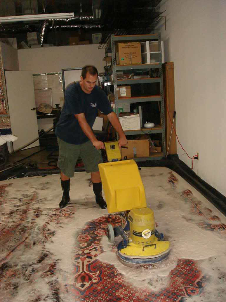

well, its our poor mans rug rack.
we just got in our new badger today and will be trying it on a few rugs this week.
we are looking to expand are rug cleaning and do much more at our shop.

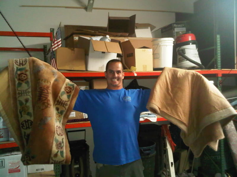

Jimmy, Looks like the backing is already loose on the Faux Chineese in your left hand.. The Badger will tear it all the way off unless you put a plastic or Tevic wrap between them.
Looks like you got the backing wet, beware it can shrink different than the rug and leave wrinkles.
I hate doing thos disposable rugs, but have some clients that just love them. they are harder for Helen and I to process, don't look as good as the others , but we explain it and charge more..

There is more room in that shop..these pictures don't show it right. Mr. Watson: that's me on the picture holding the rugs,(jimmy is like a foot shorter-I'm 6'7" :-) and yes its wet all the way to the backing because it just came out of the pit. I carefully badgered both of them and we washed them in the pit. We dryed them streched out on a plywood base (nails holding the rug in place). We dry most of the rugs overhead hanging with blowers. Zee
