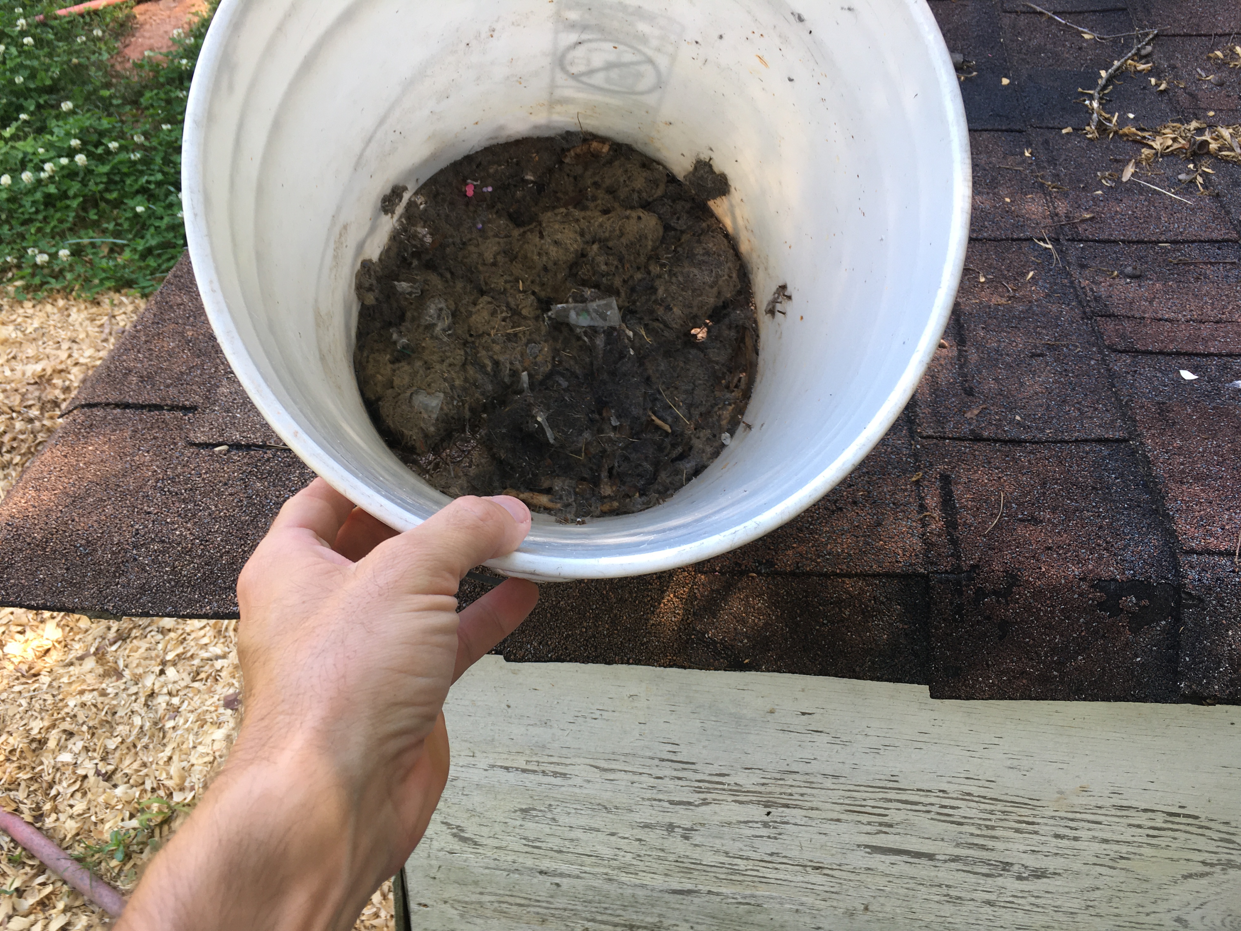

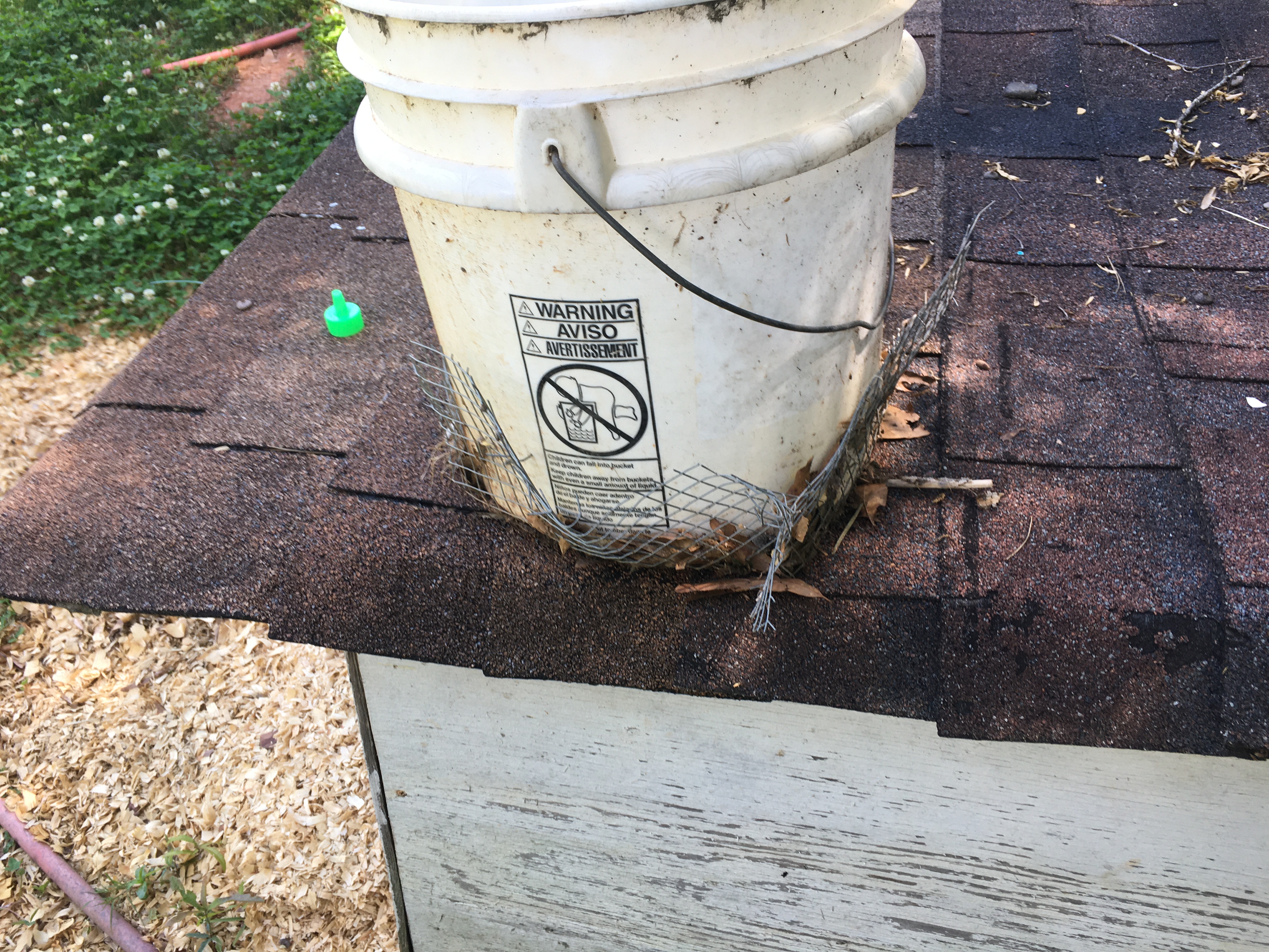

from my experience in those inline filters (3 different kinds), I suggest cutting the bottom out of a bucket and replacing it with chicken wire to catch the gunk when you spray the filter down.
The paint filter catches too much and will get clogged in the middle of a job, causing loss in suction.
