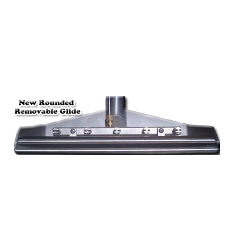

"new" Big Boy wand
116,140
Big Boy Original! With New Rounded Stainless Steel lips!
This Big Boy wand started a following like we had never seen before. Now the same wand is even better with rounded stainless steel lips!
All decked out with 14” heads, 5 stainless jets, 1200 psi, low profile head for an incredible reach and ALL shiny stainless construction Big Boy is back to please.
The weight of this wand is all directed to the head to reduce chatter and make it easier to glide!
Should be easy to use but no base board and transition area protection that Glides provide

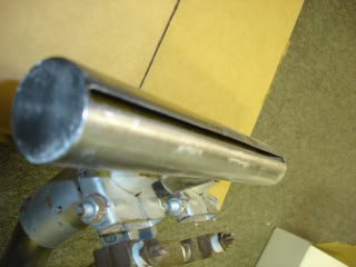

and when the rounded glide wears a thin flat spot at the vacuum slot and forms two razors, and the gap between those razors grows each month making pushing the wand real interesting.
Let me dig up a pic of this exact thing:
and let me tell you this, that slot is razor sharp.

Rounded surface area is the key.
I've got a experimental wand just like that in my office!
The gig is up greenie........................

Can't they just make the lips rounded more?
Hey Greenie, can you make the part near the baseboards on your glide not as thick so we can get closer to the baseboards?
Have you tried anything like that?
Greenie
6,820
What about the "edge channel", is it not deep or large enough, should it be bigger, as it stands now it'll pull a pile of pepper from 5" away on a tile floor.
Greenie
6,820
smart ass.
Does it, or does it not pull the moisture from a filtration line, that is the issue, if not good enough, the only answer is making the edge channel larger.
