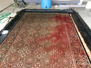

Skunk Out is all that is needed.. setup your pit. submerge the rug in a few inches of water, apply a quart of skunk out.. diluted to a five gallon bucket of cold water and apply evenly over entire rug.. Brush it in. fill the pit up with more water to insure the rug is completely covered and flooded. If you can use the roller like mentioned in the article.. otherwise a good stiff push broom or glided wand works as well. Let the rug sit and hour then roll/ brush it squeegee it for about 10 minutes.. Let it sit another hour.. and repeat.. if the water gets very grunge.. then replace water and add only 1/4 as much skunk out this time. Again dwell an hour and agitate. Repeat until you stop pushing urine out. Then.. Rinse out the entire rug.. best approach.. lay rug on a slanted slope and put a cold water hose under one end and start pushing soil/water/ gunk out till it pushes clean.
Skunk out has plenty of solvency to clean the rug effectively with out the need for any other products.

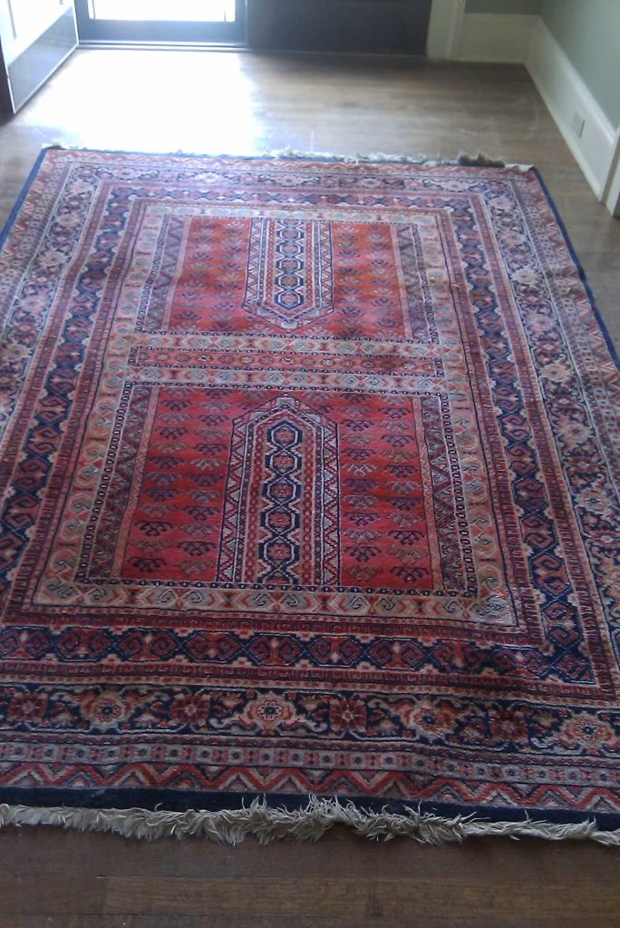

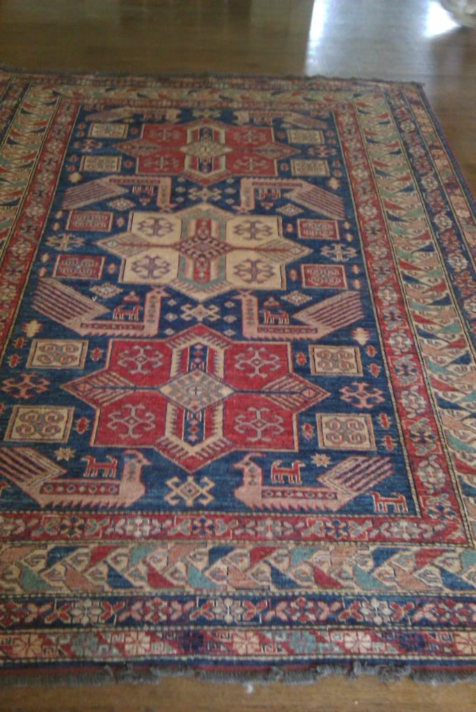

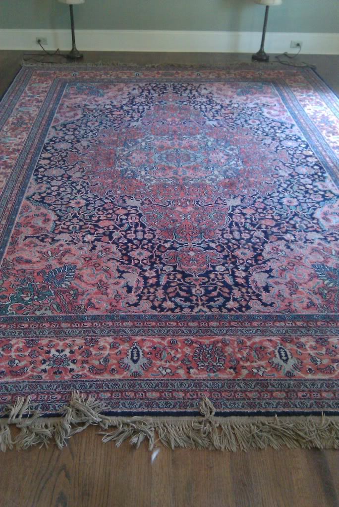

Sep 7, 2008
3,797
I have used two acid pet treatments before. Hydramaster UPS which is great. It has a disinfectant in it I believe, knocks odors out fast, and is an acid. I like it a lot.
Matrix UPS - smells like vinegar, not as good as the hydramaster product, but works ok.
I too have never soaked a rug overnight. I have always treated heavy with the acid prespray and then cleaned with a wash. I get good results.
I was a little confused on this. Someone mentioned that cat urine should be treated with a high ph solution. That didn't make any sense to me. I am going to submerge the rug in a solution of Matrix UPS for a few hours then clean and rinse really good. After I get it clean, I will use something to freshen it up (likely odoban - a good disinfectant solution). This is the worst rug I have had to work with.
I will have to try some of the masterblend products. How good is the finge solution?
I have a few more that are not too bad, but are more expensive better quality rugs with pet urine. Bleeding could be a problem if not handled properly, but that is not likely. My only concern is the fringe. It is stained with pet urine. They should clean up good.
Zee
Nov 2, 2007
6,162
SoCal jungle
The last two pictures- I wouldn't recommend using masterblend's "fringebleach"
To me they look like "teawash" colored and I don't think the fringebleach is s friendly with those type of fringes.
