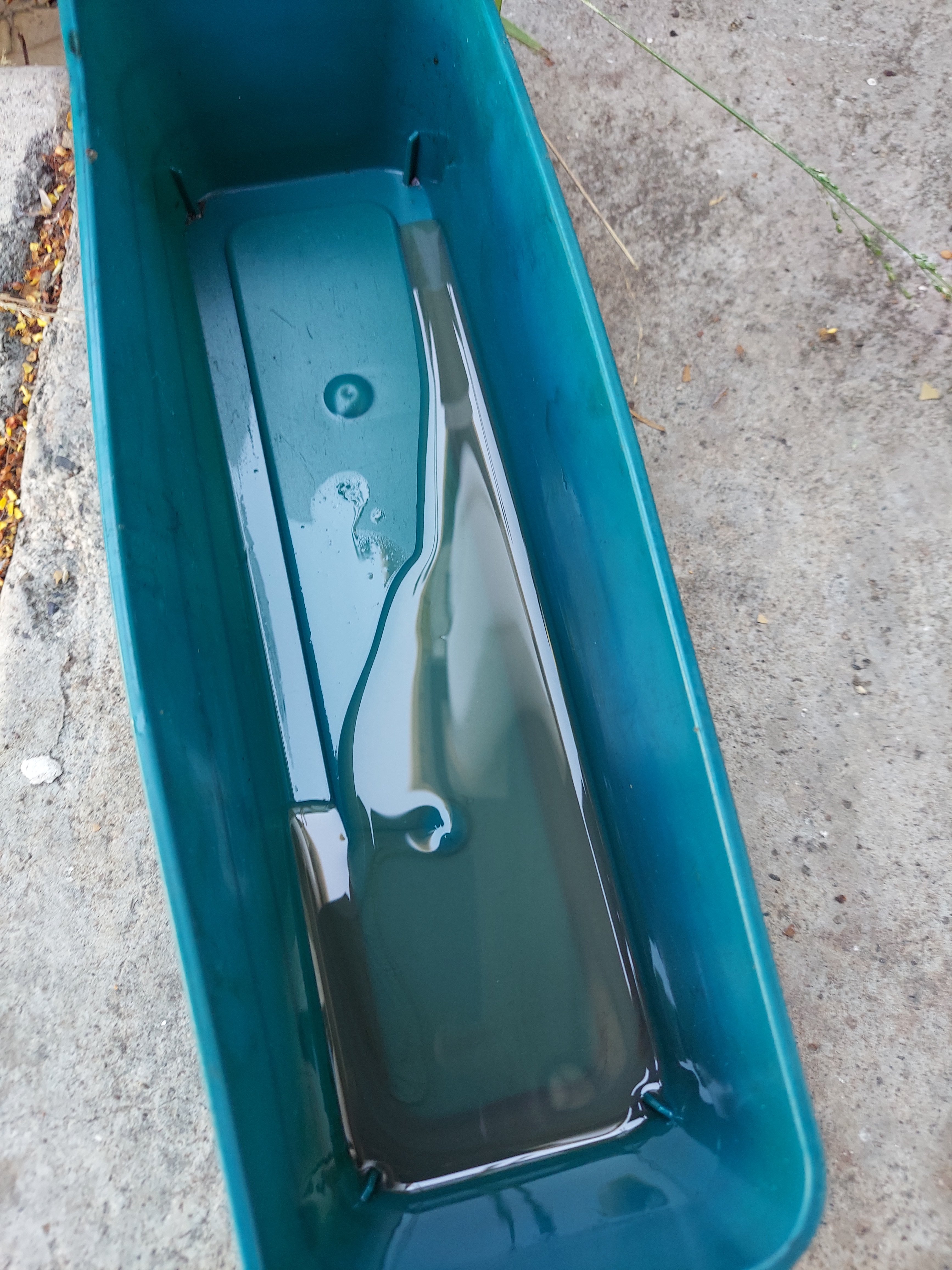

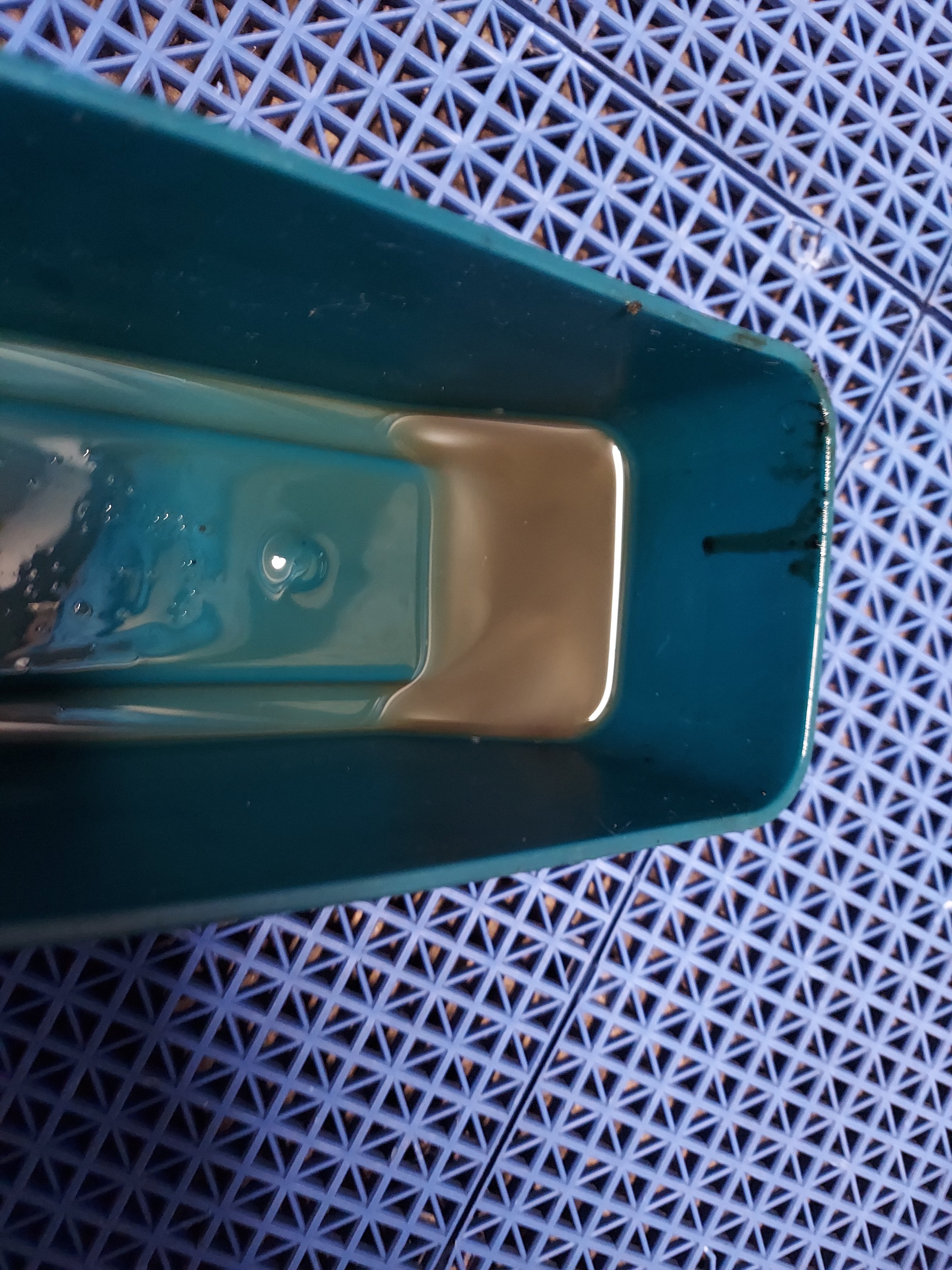

The machine works great now. I changed the belt and oil. :biggrin:
Thanks for everyone's help- especially @Justin Legend Brands who helped me by TMessage while off duty on a Sunday.

This morning after cooling down the system started up and had pressure with no problem-- but I already had the machine apart so changed the belts and oil anyway.
