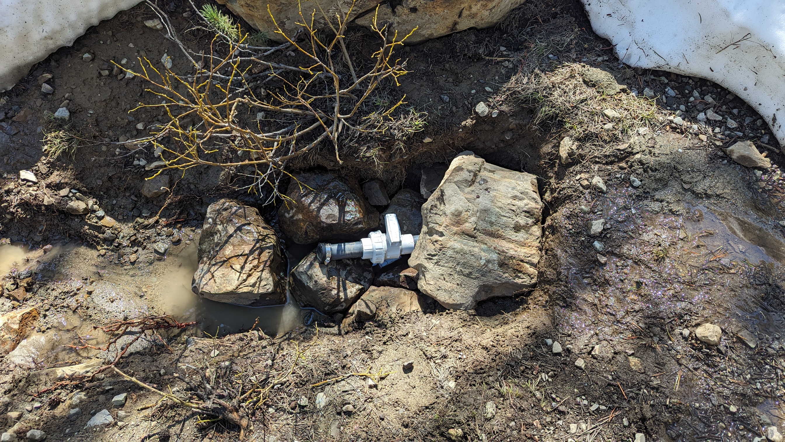

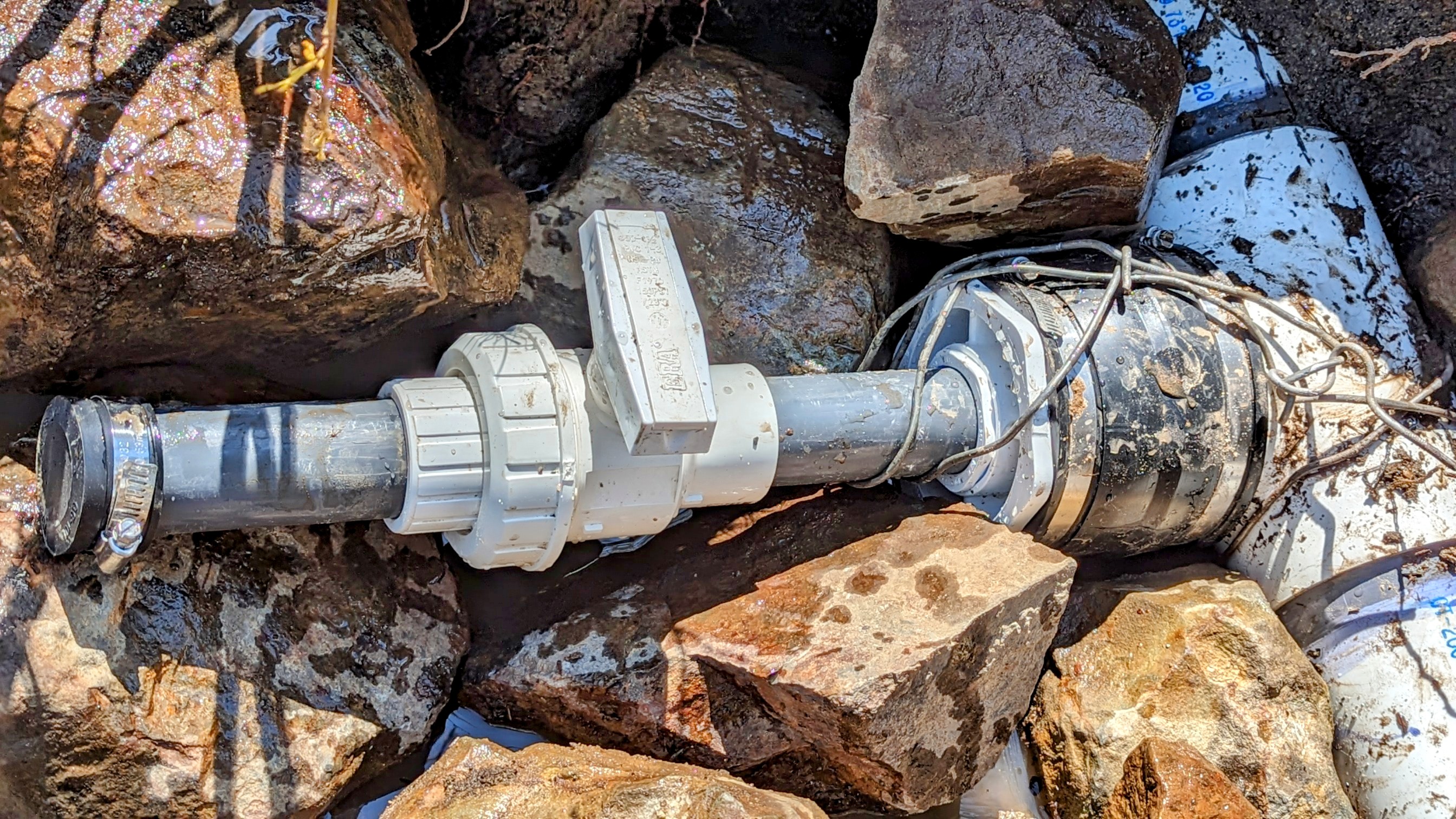

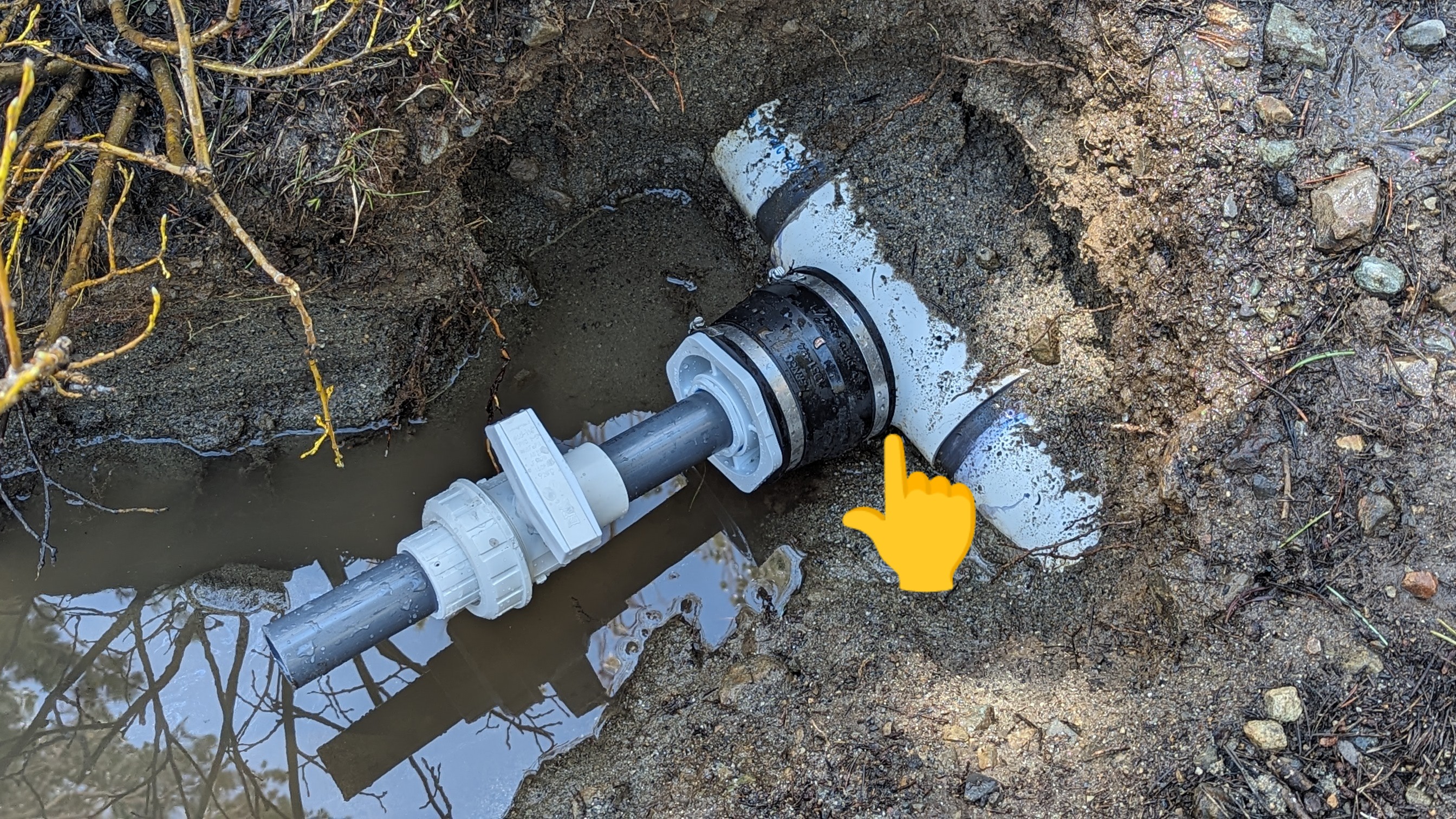

I also invented 5-to-1.5-to- the Cabin... PXL_20230712_204950629~2.jpgPXL_20230712_223952106~2.jpgPXL_20230712_224445728.jpg
115,994
That hose clamp let loose on me today due to the high volume in the lake and knocked me over just like Charlton Heston in planet of the apes, who ironically has slept at our cabin before, so I use that industrial strength baling wire to assure that wouldn't happen again
