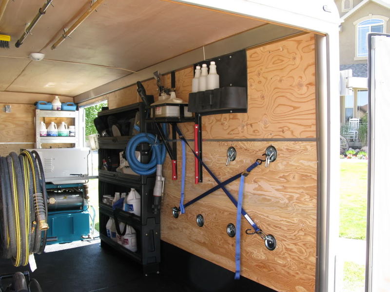

steve garrett
here are mine installed in a trailer
tmdry
Apr 7, 2008
2,508
DC
Bill Martins
TimP said:
I really like the idea of the plastic shelves. But losing a row of chemicals for storage is a deal breaker for me.
That's why I'm now leaning towards the stainless shelves. I really want the plastic ones. Too bad they weren't designed fit the same way the metal shelves are.
I know what you mean, but than got me thinking, how much chems do we really need in the van at all times?
Steve's setup is real nice.

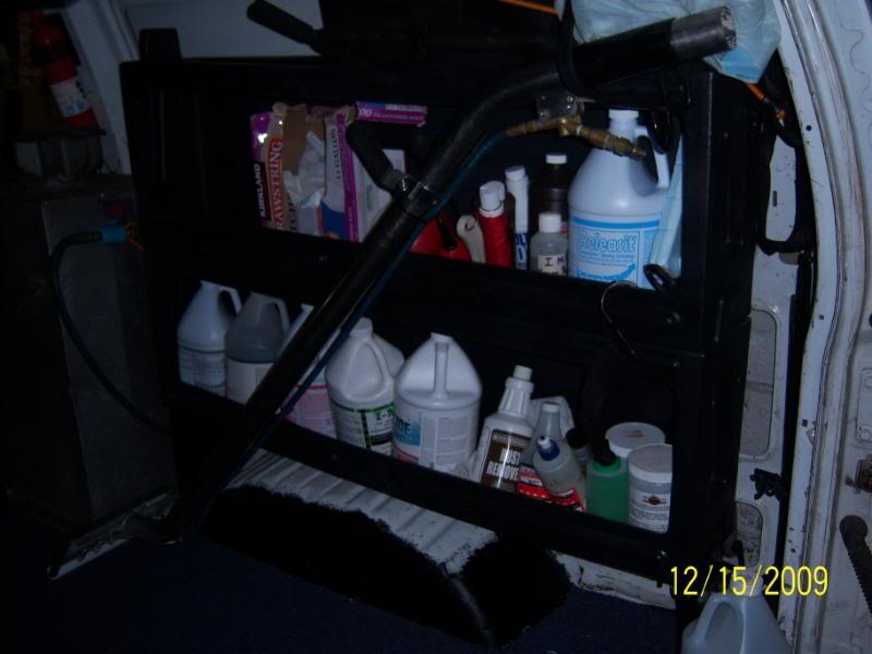

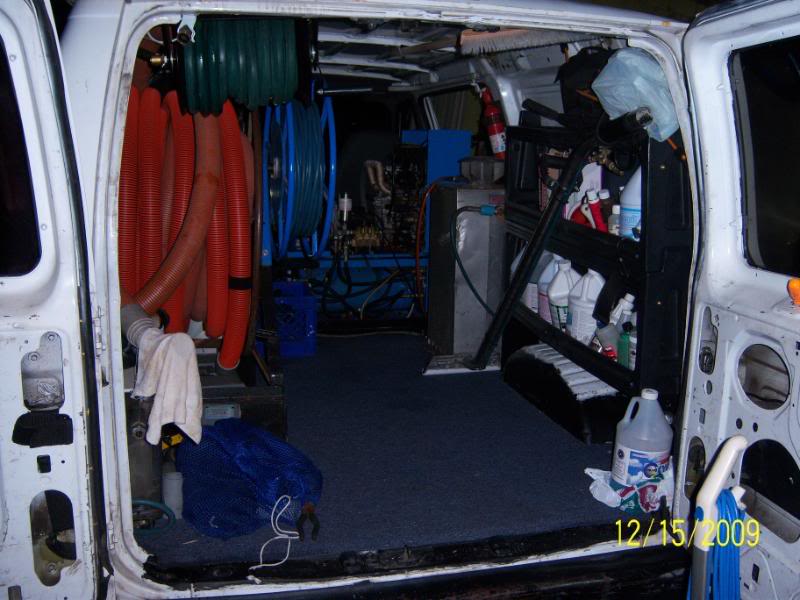

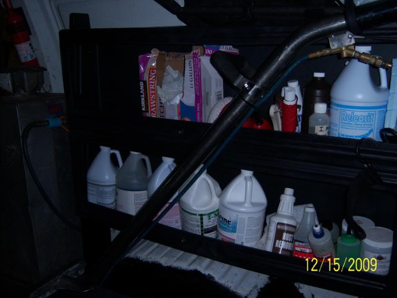

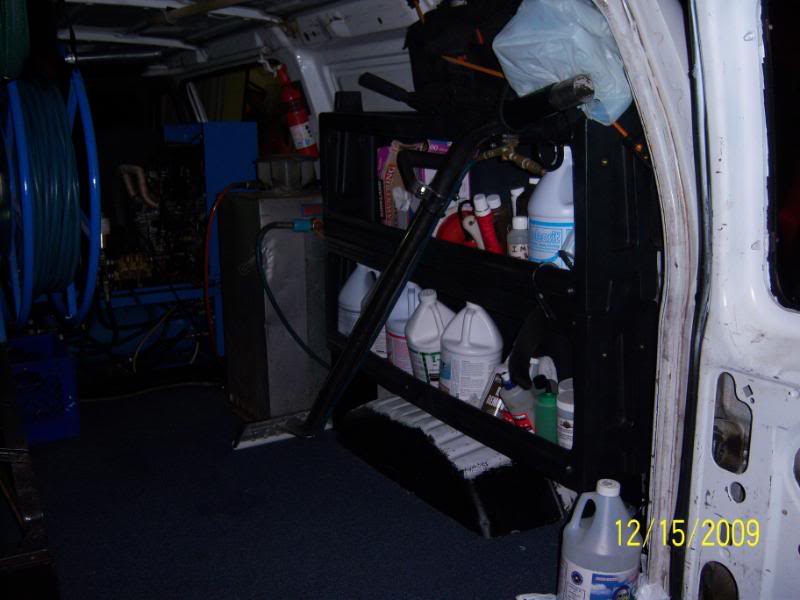

Nate W.
Mines is no where near as nice as Steve G. setup is, but it's in a regular size Ford E250. My first setup and TM I did myself. I'm still figuring out different setups to change mines around. I do like the shelves and had a bottle of something spill. Good thing it was on the bottom shelf as it would have leaked through to the second shelf if it was on the top. It's didn't rust or anything.

I believe it would fit. I intended to use 3 shelves, but they didn't fit. I did push the shelves against the wall of the van and didn't have to use the side supports that come with it to keep it from falling. Because it's so close to the wall, when I tightened the top shelf down, compression holds it in place.

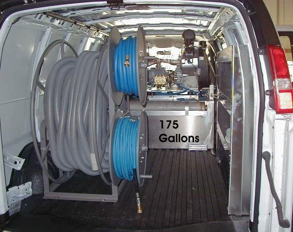

Tim;
We like the Mytee shelves for our TM installs.
Here is a photo of the SS 3-shelf:
It only has the bottom of the 3rd top shelf.
Larry
