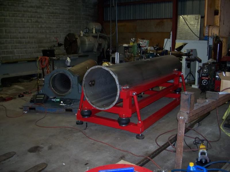

Yes, 33 feet long and a 36 inch chuck. Bad boy for sure.

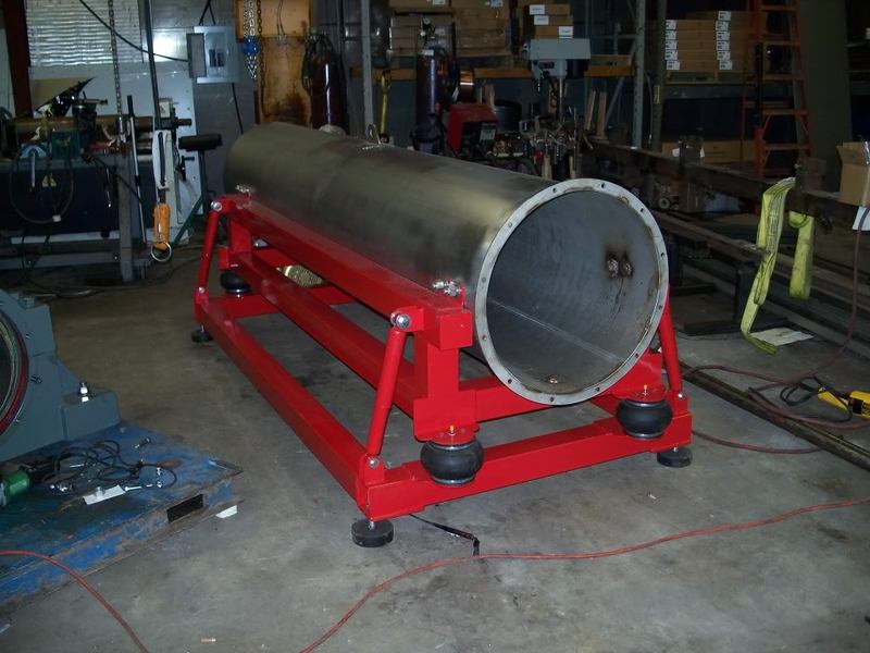

Larry, It spin so fast that the harmonic frequencies are raised into the 'only dogs can sense them' range. :wink:
Lack of balance at start-up just has to be managed. The big bulgy mounts and shock absorbers should help quell some of shake until it gets to speed.

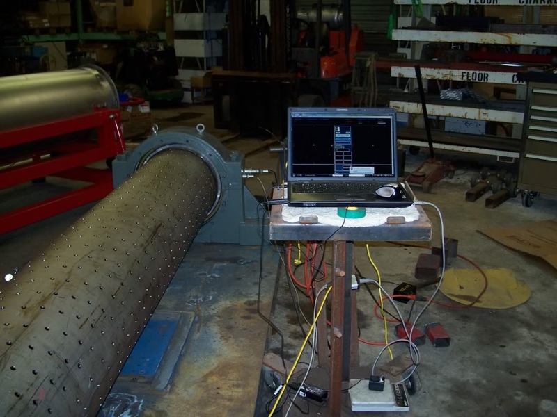

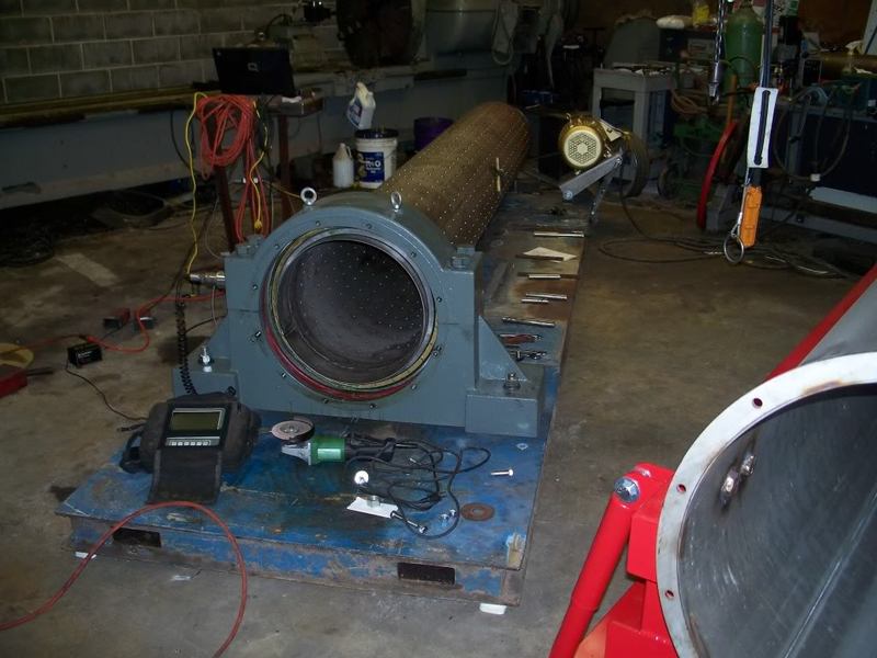

Dusty is selling the Turkish centrifuge. I do the electrics on that unit. This is a new design. The balancing is two plane dynamic. We spin it up, take a reading. We add a trial weight seen in one of the photos hanging on the side. Spin it up again. This procedure is repeated unit the balance gauge is 0.

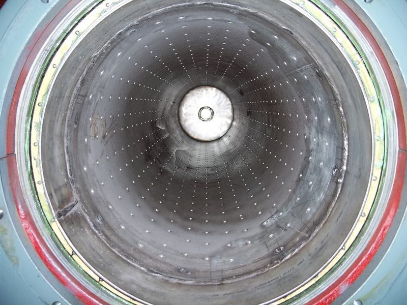

Hello Joe, This unit is 10 feet long and with an 18 inch ID. Normal speed is 0 to 1200 rpm. Most rug need to run at 800 rpm. This unit is 100% 316 Stainless Steel. The under carriage is Mild Steel. I built 2 units with the under carriage made of SS but they were to flexable. This was a problem when we moved them around for shipping. I will build 2 more 18 inch units. After that they will be 20 inches ID and 10 feet and 13 feet long. I am building a 16 foot unit but never again. To much machine and to hard to use and takes up to much space.
