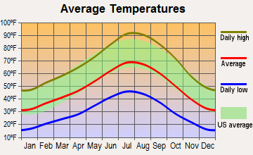

the freeze/thaw we'll have here
How cold does it get at the new digs? 31.5????
