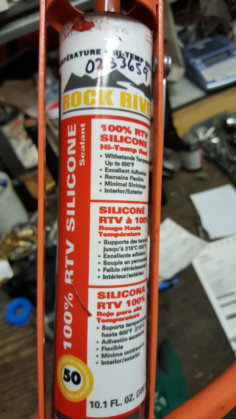

There is no gasket kit for this
RTV
Well, sometimes the engineers get it wrong the first time...and the second.
If that were my engine a gasket would be made for it before I reassembled it.
I've pulled apart RTV long after the stated cure time just to find uncured wet product.

I hope it works out well. The only info I can find on that sealant seems to indicate it's for interior/exterior architectural use, along with ovens and boilers. No mention of oil resistance. Maybe it said so on the tube?
A lot of mechanics just don't like the idea of spending 25 on a tube sealant.
Apparently that's true - the sealant used is $5.99 at Fastenal....
Cheaper is better - as long as it works!
