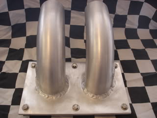

Too bad on a Butler you couldn't just bolt one of these on and be done with it.
I'm still not sure the twin elbows do all that much for a #4 blower, but hey, it can't hurt.
I still think most guys will use the factory 2.5" port that is there and call it good. I know the Butler unit runs a heck of a lot smoother and burns less gas with the 2.5 conversion, most have to turn down their pods.

Well so far so good...
I kept it all coolcuffs,for compatibility...
I got a 2 inch swivel again...for the last 25 feet to the wand...
I changes to swivels after the latch version,but then gorilla glued them.
In the swivels I received originally.They had compatibility issues...Latches never did...
I would reduce a hose but it would not fit as well each connection change..
But wanted the swivels 2.5 to attach Greenies secition to Joes...
Greenies is sliced at the 25 foot mark.Joes is straight 50 footer...
But if you keep one 50 foot 2.5 you can add 75 of 2 inch...
Just got some 3 inch for the 3rd lid,I am on...
1st is in pic,next is 2.5 sweeping angle for 2.5 on lid,3rd lid will be 3 inch to a 2.5 wye...
Wye ? Because...
