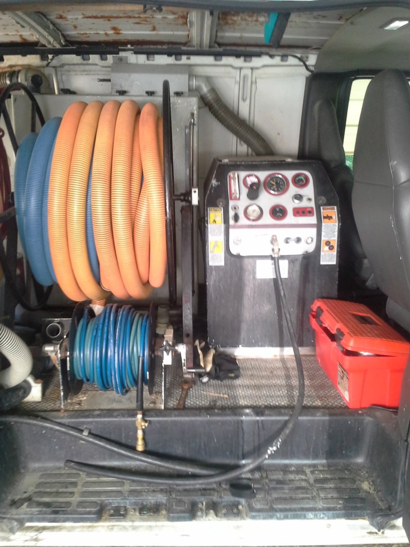

14,116
Do you have some good pictures of your setup to show us what you're proud of? I like seeing some good white magics.
steve_64
Aug 11, 2012
13,372
Ill post picks one of these days.

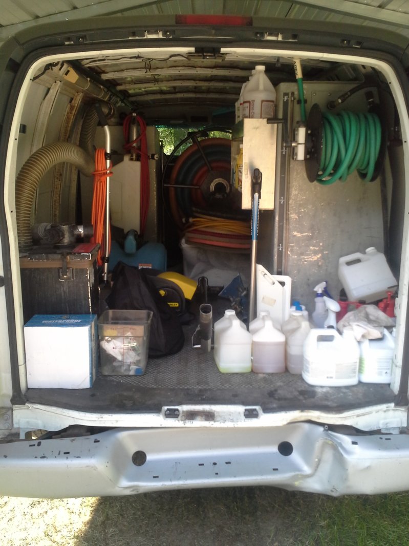

steve_64
Aug 11, 2012
13,372
Bumper and rear door. Its not high on the list but its there. Want a new drivers seat also.
