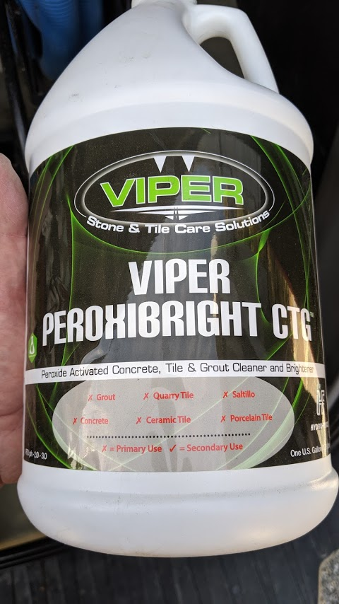

116,262
Ironically this stuff sprung a leak in MY garage yesterday morning, I forgot I even had it....
Perfect timing.
Reactions: steve_64

You really like to overwork things don't you. If you have a good grout cleaner, Just let the cleaner dwell for 10 minutes, then hit it with a spinner. I will hit the edges, corners, and cracks with a pressure wand to detail, then clean with a spinner. Use a scrubber only if there is sludge build up.
116,262
Ive tried it with and without the Nyla/Mal Grit scrubbing
I guess I'm just Premium cause it makes a hell of a difference.
