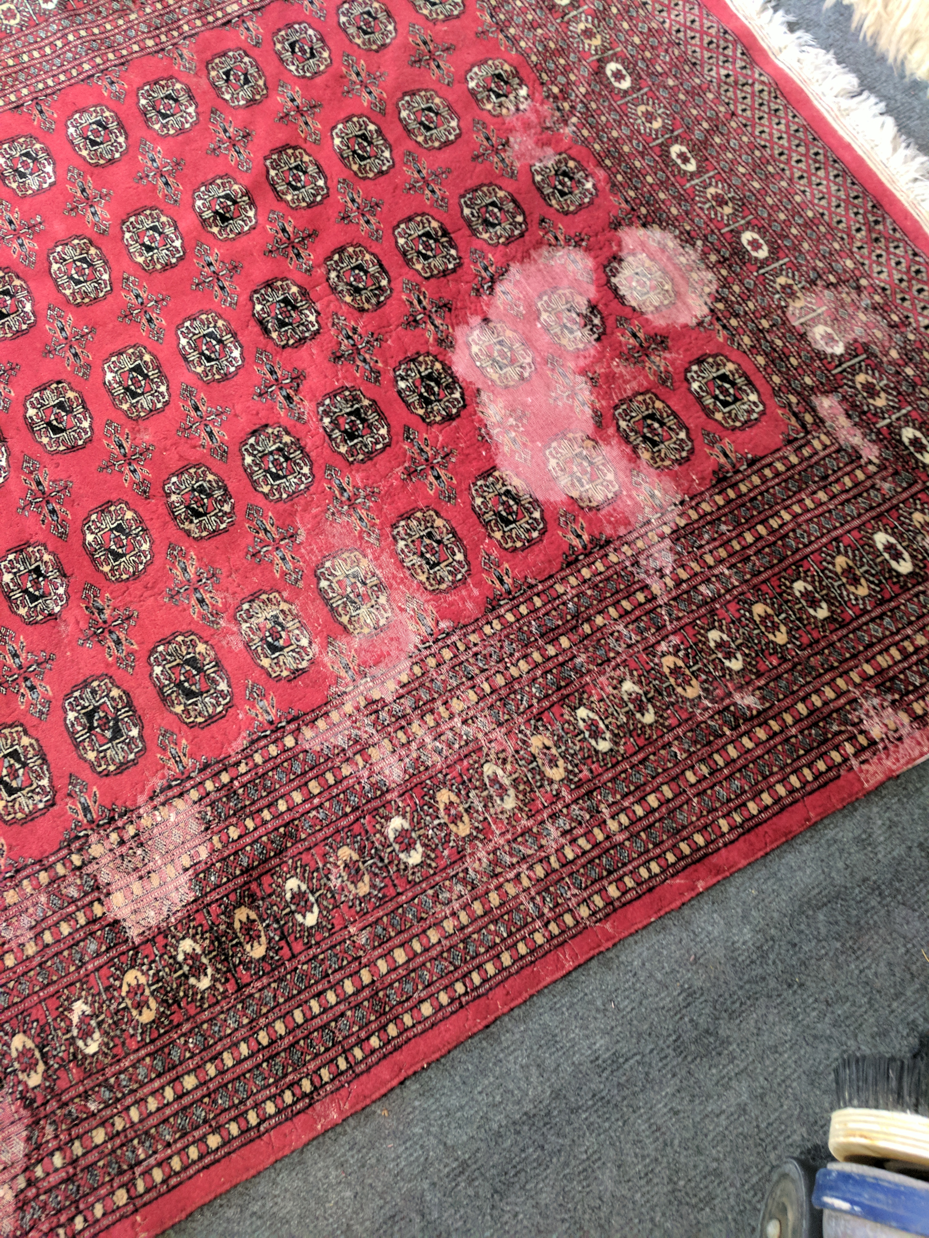

Here is a good example of how bad a rug can get when moths get out of control. We offer 2 types of moth treatments. O e is de-mothing where we spray the rug with a pesticide and bag it for a few days before cleaning and the other is Masterblends Repel product which we apply after cleaning. Just wondering who else does de-mothing and what works for you? IMG_20180706_122627.jpg IMG_20180706_122627.jpg IMG_20180706_122635.jpg IMG_20180706_122627.jpg

We do the same. I like Suspend SC as a pesticide. It works well and is relatively easy to handle compared to some other products.

You don't need a pesticide license as long you are not spraying in their home. Yes I guaranty the moth larva will be killed. I spray both sides of the rug, then bag it for 3 days. When I roll it out, the moth larva are dead and shrivelled up. I vacuum and sometimes hand pick them and their casings off. The Repel is something I have just recently begun using. Apparantly, it makes the wool unappetizing for the larva and they starve or move on.
