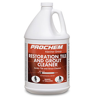

I need to try some. What do I need to be concerned about? Stainless, glass? Yes or no?
I just cleaned tile in a nice home that was just cleaned by someone else. The other company ruined the stainless steel refrigerator...and the tile grout. I'm thinking whoever did that job originally didn't follow the mixing instructions very well as it even rusted out the buttons on a couch. Can't imagine working with that in the air.
I bought a gallon on Mike's recommendation but I will be using it on bad commercial...around urinals and hard water areas only.

You think it stinks?
I think if you know what you are doing with strong acid cleaners and use as directed, it can be safe enough. Think it is a product to have in the arsenal but would not be my everyday go to. Mistakes can be costly.

It worked total wonders on Porcelain, metal fixtures, glass and grout in a shower today.
Hardly any odor too.
I thought I'd be polishing the glass for an hour or two. Doodle Bug and this stuff and it just melted right off

Any pix of one you previously cleaned with alkaline, that subsequently did much better on the acid side?
I realize there are many variables.
116,174
I ask because I once used Stonetech's organic acid and I discolored the crap out of it. After that, a light coating of vasoline prevented that from happening. Decent trick
kinda funny but I've yet to be asked to restore a shower that had any metal worth worrying about.
no issues yet.

The elves cleaned a shower with Viper Renew once. The following morning, all the stainless fixtures had a coating of brown rust, even though they had been rinsed well.
I went back over everything with Barkeeper’s Friend and all the rust vanished, never to return.
Another hack, if you have any Ultraseal around it makes a dandy stainless steel polish.

I thought acid does not cause rust, just caustics stuff? Since acid is used to remove rust?

The Prochem acid does work well, but it stinks and I only use it if I have to , especially around fixtures. I’ve been using commercial soft scrub for showers and it works extremely well without having to worry about messing anything up, you can scrub it on, leave it dwelling while you set up hoses and not worry about hurting a thing! It does such a good job that after I finished a job someone giving an estimate at the home I was working in asked if the 30 year old counter top I had just cleaned was new tile.
