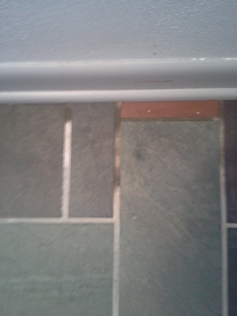

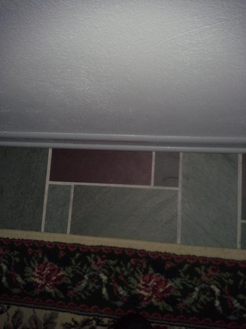

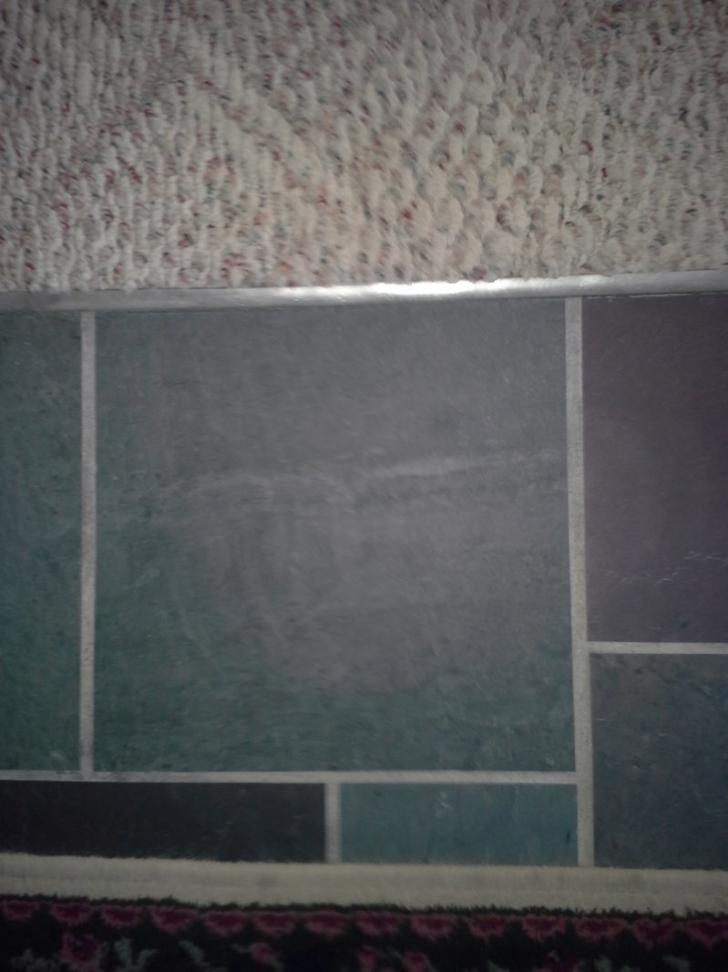

I started out with flex citrus and the ten inch crb. I swithed to the buffer and a carbide brush and got better results.
Went back with viper renew and worked the grout lines more and ran the buffer again.
Still had the topical aroind the edges but each pass got better.
I finally used some stripper and stiffer brushes. Its drying now.

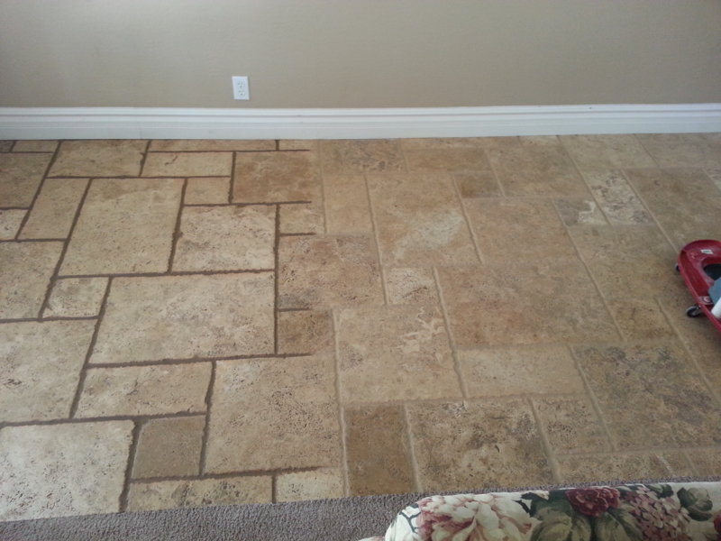

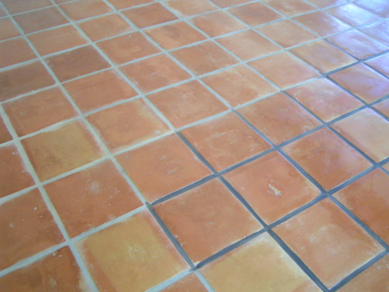

Steve, Consi der instead of working so hard to make porous previously stained grout to look brand new you will find much better result and far better protection from color sealing the grout. Using penetrating sealers will only reduce porosity for future spills etc. If you apply a coating that makes the grout uniform in color, stops porosity and keeps soils from getting trapped in the sandy texture of the grout you'll never have to do a restorative cleaning again. I do these kinds of jobs every day and make a lot more income than cleaning carpet.

Your opened this post with "Mop & Glow" Do you know if that is what you're dealing with ? if it is Mop and Glow is a water based hybrid urethane so it is striped fastest using an aggressive acrylic stripper to soften then use high pressure done cold not hot. That is the secret to keeping the product from gelling up and hardening again. The fastest but less desirable is to use a gel paint stripper. A hassle to keep it off painted and plastic surfaces or laminates and veneers while it's eating up the coating but I'd rather do my best to remove grime and then just color seal over the splotchy or inconsistent colored grout. Soooo much faster and cleaner looking as well. You can change the grout color to exactly what you want.
I use a product that is quite tenacious and has not failed on the thousands of jobs I've sealed over 18 years now. It looks natural as well without looking "painted".20140922_092135.jpg P1020361.JPGAdd or reduce character.jpg Stripping whitewash7.JPG

steve_64
Aug 11, 2012
13,372
Im not an expert but I assume mop n glo. It had that caramel coloring and was hard like acrylic.
The stripper I used worked best. The grout lines are not as bright as id like but I dont want to color seal it.
I sealed the grout already and put the baseboards back on. Its not perfect but wayyyy better than it was. Ill tackle it again next winter or cover it with the LVT ive put in the other rooms.
I realize now I like carpet cleaning better lol. Ill take on some tile jobs but ill be picky.
