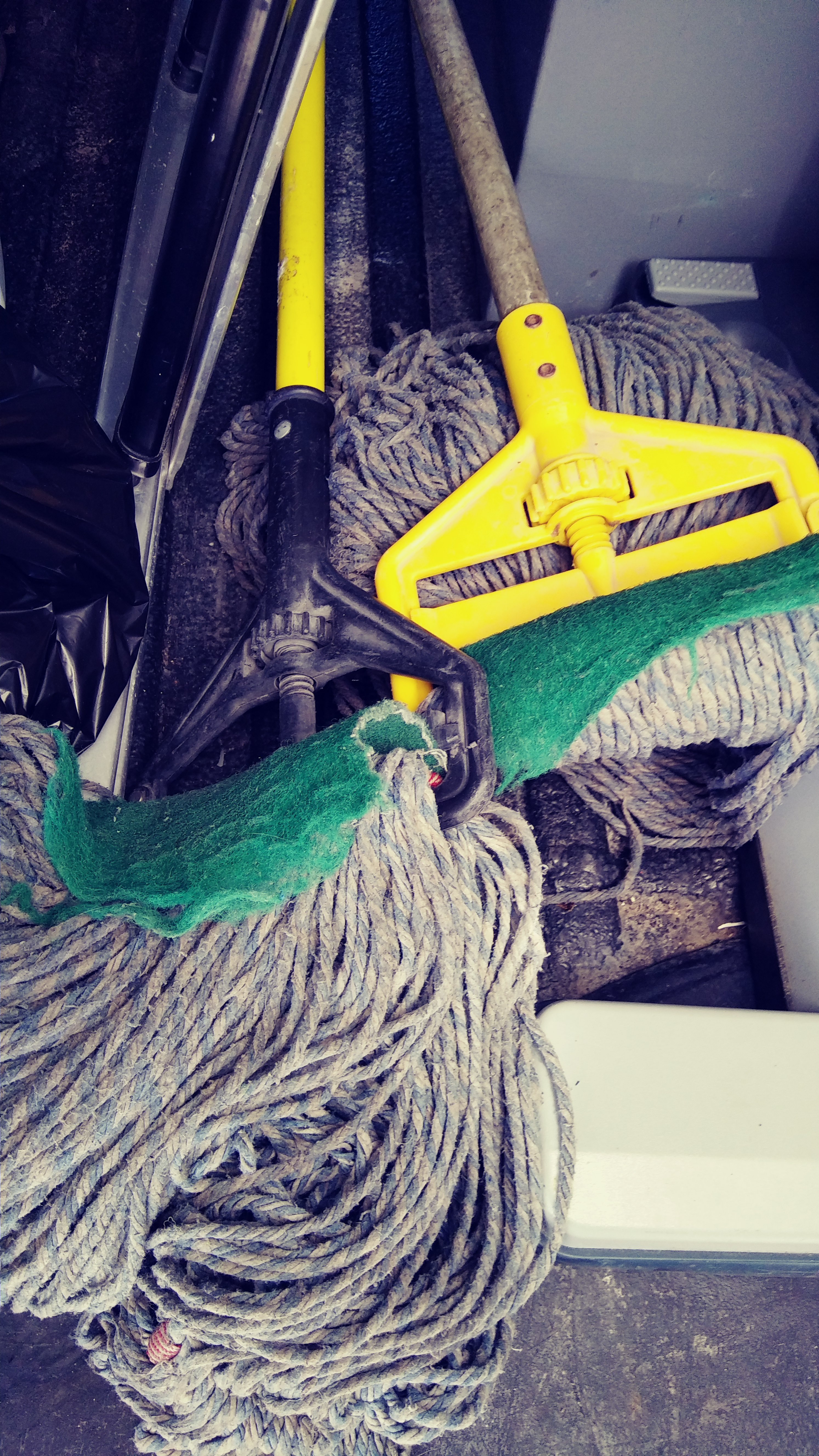

Viper neutral cleaner and a good mop and ringer. Most soils will melt right off and it will kill urine odors as well as leave a decent fragrance. You can carry a scraper with you for gum and things like that.
Put a green scratch pad on the mop too for extra agitation.

I've been using green pads for 40 years on Oct and tile and have never had an issue. 20190420_174507_Film1.jpg
Reactions: Thecrew

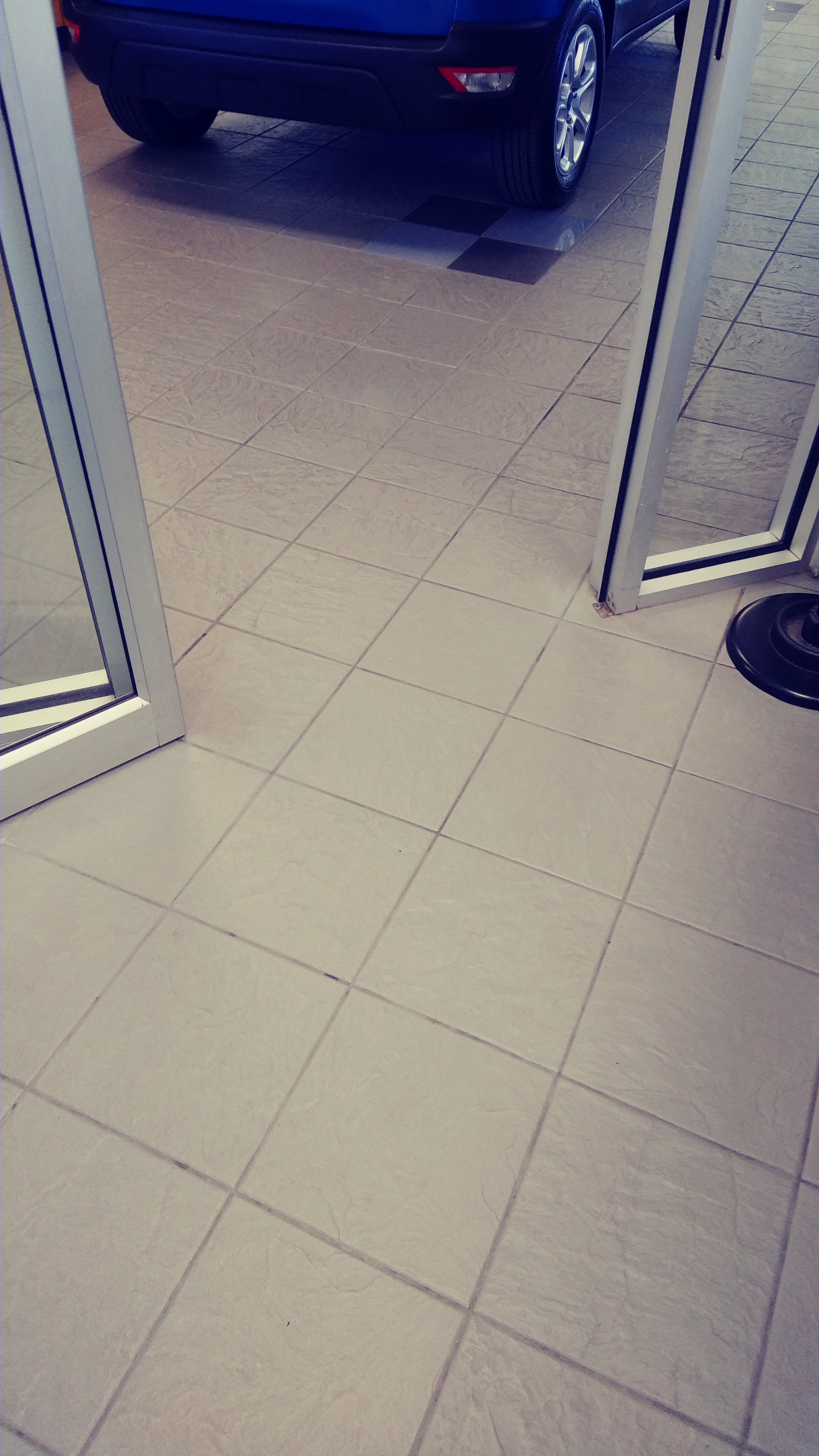

Here's a room I cleaned about 4 months ago. You can kinda see how the room still looks good compared to what hasnt been cleaned. Just a splash of the neutral cleaner in a bucket of water keeps the floors from resoiling along with wringing them out right keeps it from streaking too.20190420_164047_Film1.jpg20190420_164112_Film1.jpg20190420_164112_Film1.jpg
Reactions: Mikey P and Thecrew

Here's a room I cleaned about 4 months ago. You can kinda see how the room still looks good compared to what hasnt been cleaned. Just a splash of the neutral cleaner in a bucket of water keeps the floors from resoiling along with wringing them out right keeps it from streaking too.View attachment 90384View attachment 90385View attachment 90385
And all you use to maintain the tile is a neutral cleaner and those mops with a green scrubber? Do you use the neutral cleaner on VCT too or just ceramic tile?

I would imagine its the same but I get mine from interlink. And yes I use it on tile linoleum laminate and wood floors. You can wash walls with it too.
