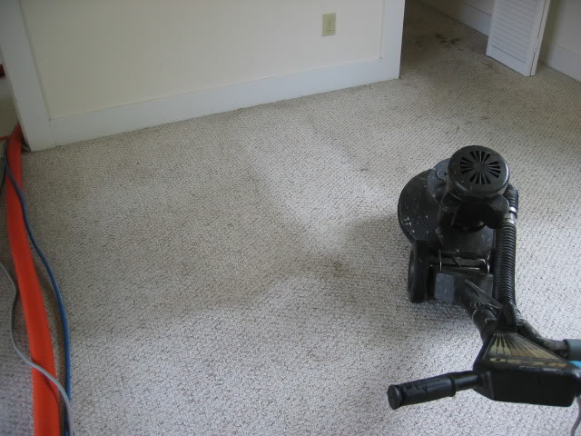

George, practically everyone of us who just posted has a RX and we all have lots of experience with them. The 175 wins for most applications.

although I would really like to have a 175 on the truck because there are times I could use it the RX in most cases will do the same thing and you don't have to scrub and extract..it is all in one step....
I have gotten a load of empty home in the last few weeks and have found it much easier to rx the whole place and hardly ever touch the wand....
If your RX is leaving the carpets to wet then re-jet it to work better with your machine so it uses less water.. ( got to find that balance ).I am RXing some pretty dirty places from base board to base board and the carpets are just barley damp....also if you are worried about hitting the base boards ..get a hold of Greenie and see is he still has those funky shields that go around them....they take some getting use to and I would recommend filing the bottom edge to make it round so it glides better....I used it for awhile and finally go to the point where I can get about an 1/2 inch from the wall and not touch it so I gave mine away to another cleaner because he was always hitting them....

I gots green glides with my rx and dont have any dry time problems just like a wand you have to make some vacuum only passes

The GuardZilla was a cool tool, pushes cords out of the way, protects base, good training wheels for newbies.
I just assumed all RXs were glided these days.
A glided RX on berber is pretty sweet.
Someone got a pic of a real Counter Rotating Brush machine for George, I think he missed that little detail, they really are cool machines, and self clean the hair from the brush as you go.
