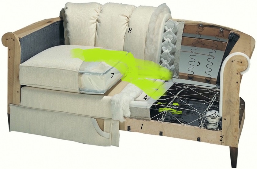

Lets say a geriatric Newfoundland lets loose on your davenport..
116,233
is this amount of saturated urine damage realistic?
How deep have you been successful with?
6,544
Bc
Cushion? Depends on the material. Both the face fabric, and stuffing... down and feathers? Forget it.
Body of couch? Forget it...
It’s like an adult human peeing the bed.
Once it’s gone that deep,
REPLACE...
We all know that when we clean upholstery, we are only cleaning the face fabric. Sure, you can inject an PSOR, and use the vacuum trick, or a water claw, but are we really getting to the source?
Are we rinsing it enough to flush the contamination, and chemical?
A resounding NO...
