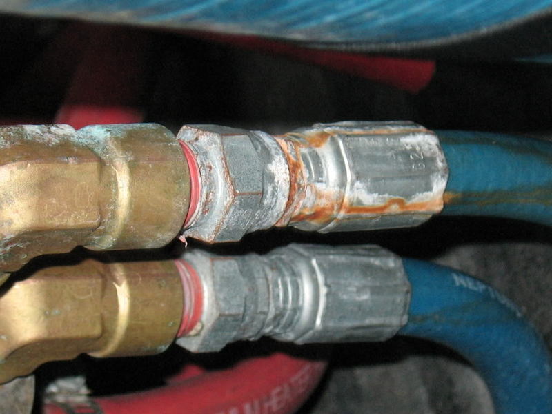

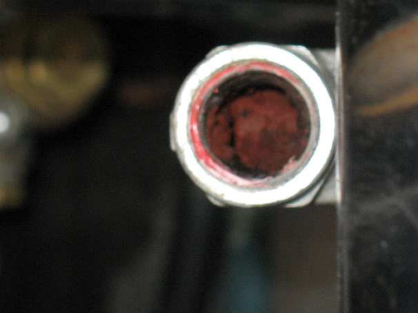

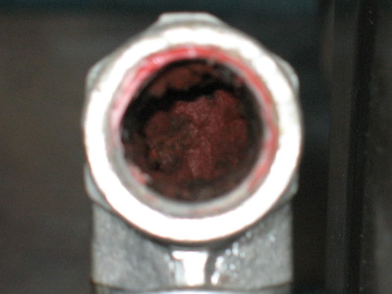

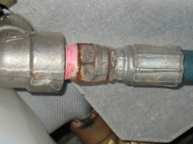

Something like this...............
AT has some new hose reels that they developed that is supposed to kill this issue. I have not seen them or talked to anyone in detail about them. I replace all my internal hoses and fittings after I was getting junk in my check valves after every job. You can replace the hoses and galv fittings 7 times before the SS pay for themselves - already priced them out.
I needed/wanted heavier duty hoses internally anyway to run higher pressure for paver work, so it worked out ok after having one of the hoses blow anyway.
