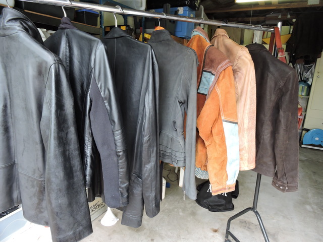

Here's some of this weeks work in between my normal routine.
Among them are unfinished with a tear.
Finished with fabric elasticized arms & front fabric panel.
Finished.
Suede with flounces.
Suede & Denim.
Finished with strange rubberized/elasticized panels & arms pieces.
Oil finish, or oil pull-up if you prefer.
Handbag. (NOT mine).
:yoda:

That is the most confused article of clothing I've ever seen. Is that a Frankenstien design?
Yer not wrong there Joe, it was going to be "different" from the word go.
Sometimes, I don't know why I take these jobs on.
The dry cleaners won't touch them & send them to me.
