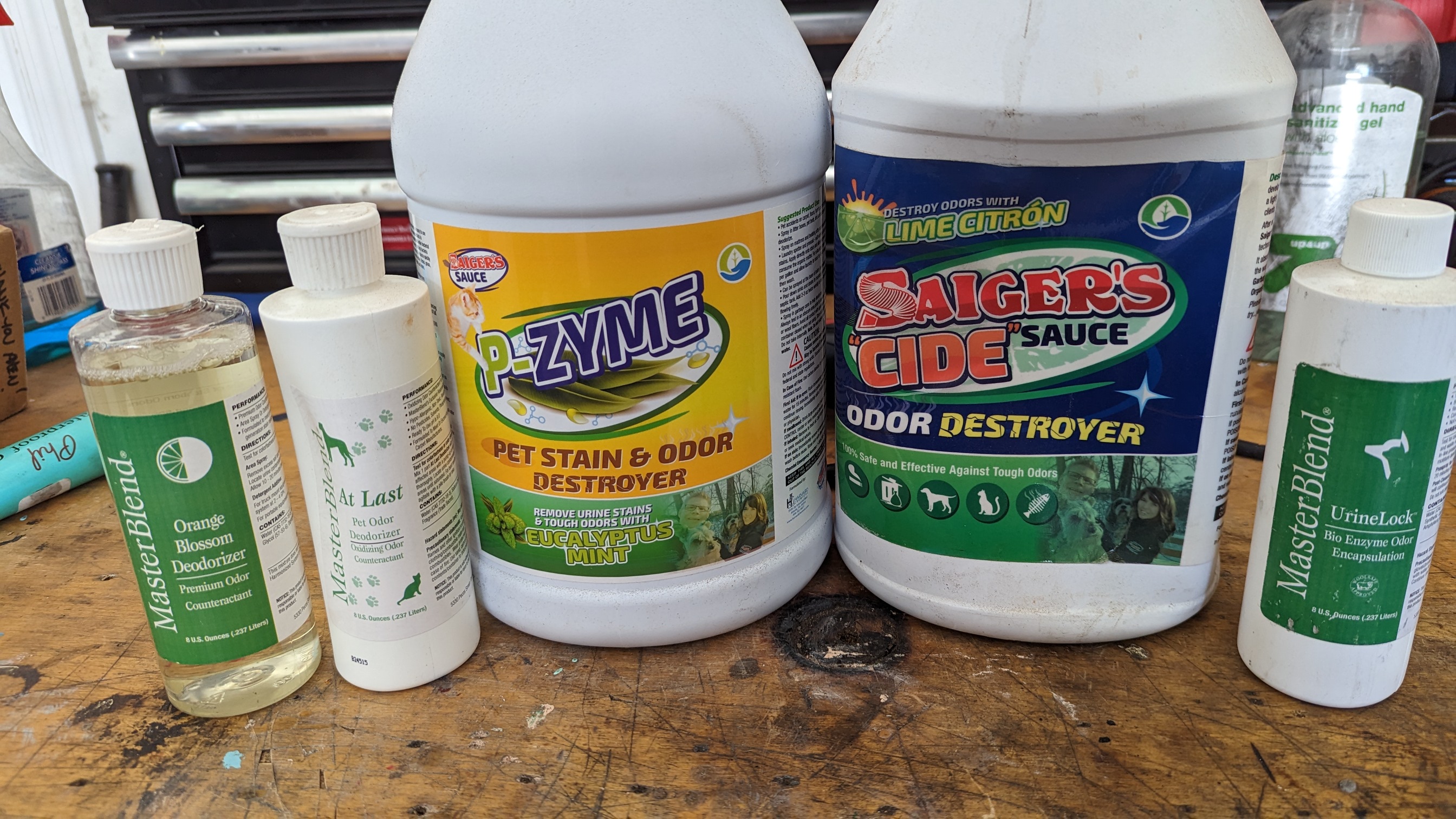

I know there are some skunk specific products, that I don't have any on hand, and I have no time to get any ordered, so in your experience will any of these products work....
Numero Uno
Oct 16, 2006
1,906
Ma
Caesar
Skunk off best bet, but you do not have it .So going from left to right #2#3#5. You ave an oxidizer and encapsulant go with those 2 first. Then follow with the # 3. Saturate an give solid 15 minutes to sit .Reapply again -wait then proceed with rinse type efforts...The oils hold the scent so you have to bust through the oil to get to the heart of the problem. Cold water rinse is also an option. So as not to supercharge with heat prior to removal of source. Also make lemonade out of lemons . Tell Saiger hey your missing a product line item .Gimme a cut ! Just like water restoration homes that a flooded for training. Odor removal should be like wise and this is a day course unto itself. Also if in a enclosed area .Uv rotating sanitary lites will neutralize within 30 minutes .Allow air flow for the off gas it will produce. Zebruktolite packages hidden will ensure no odor return .
